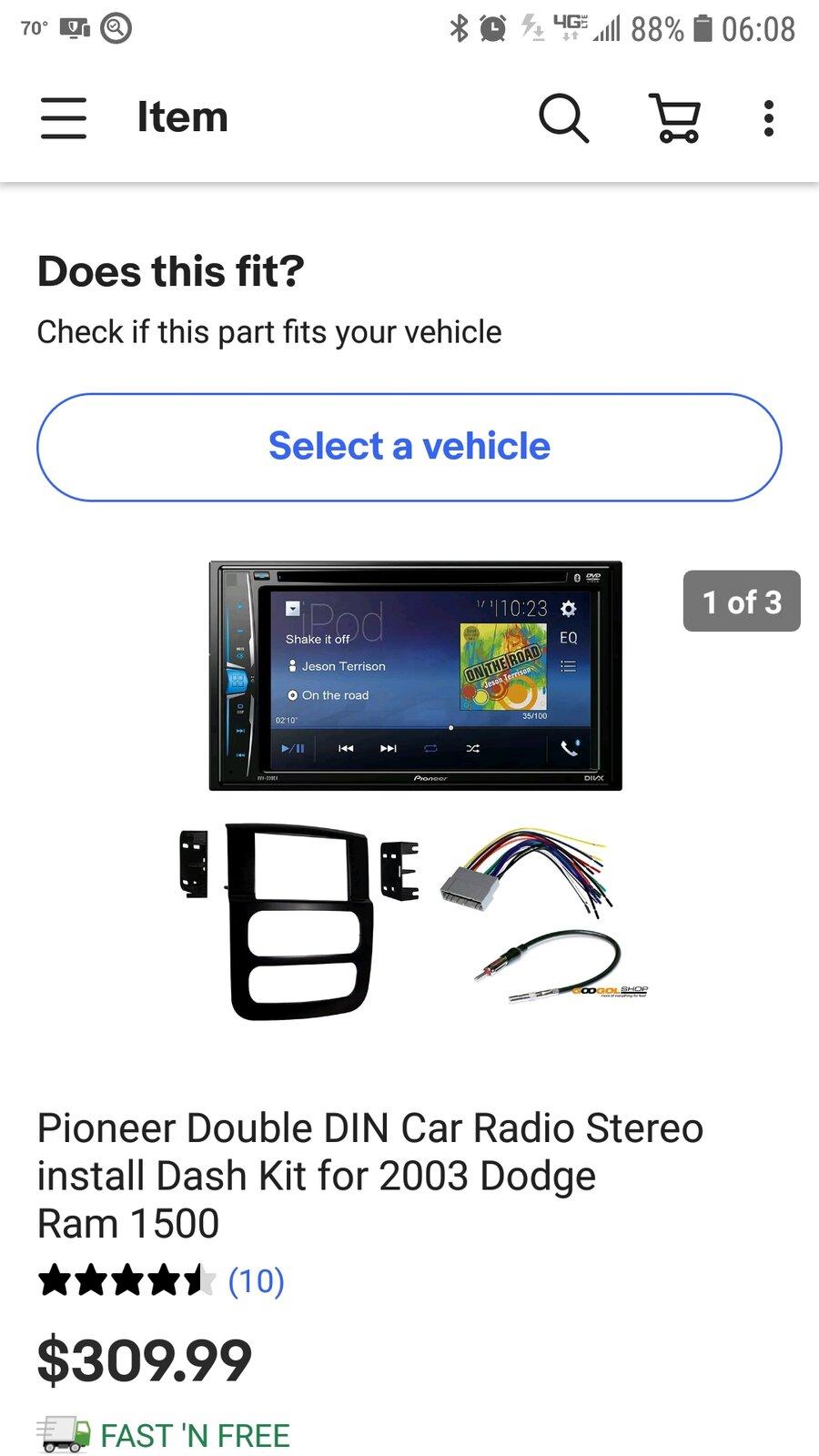

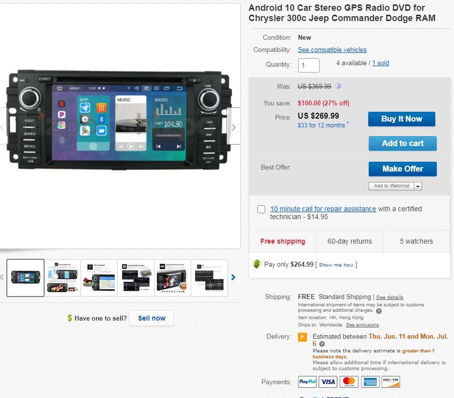

There's a lot of choices including installation kits with replacement center dash piece. I bought my niece one on Ebay a couple years ago for around $300. Easy to install, complete kit.

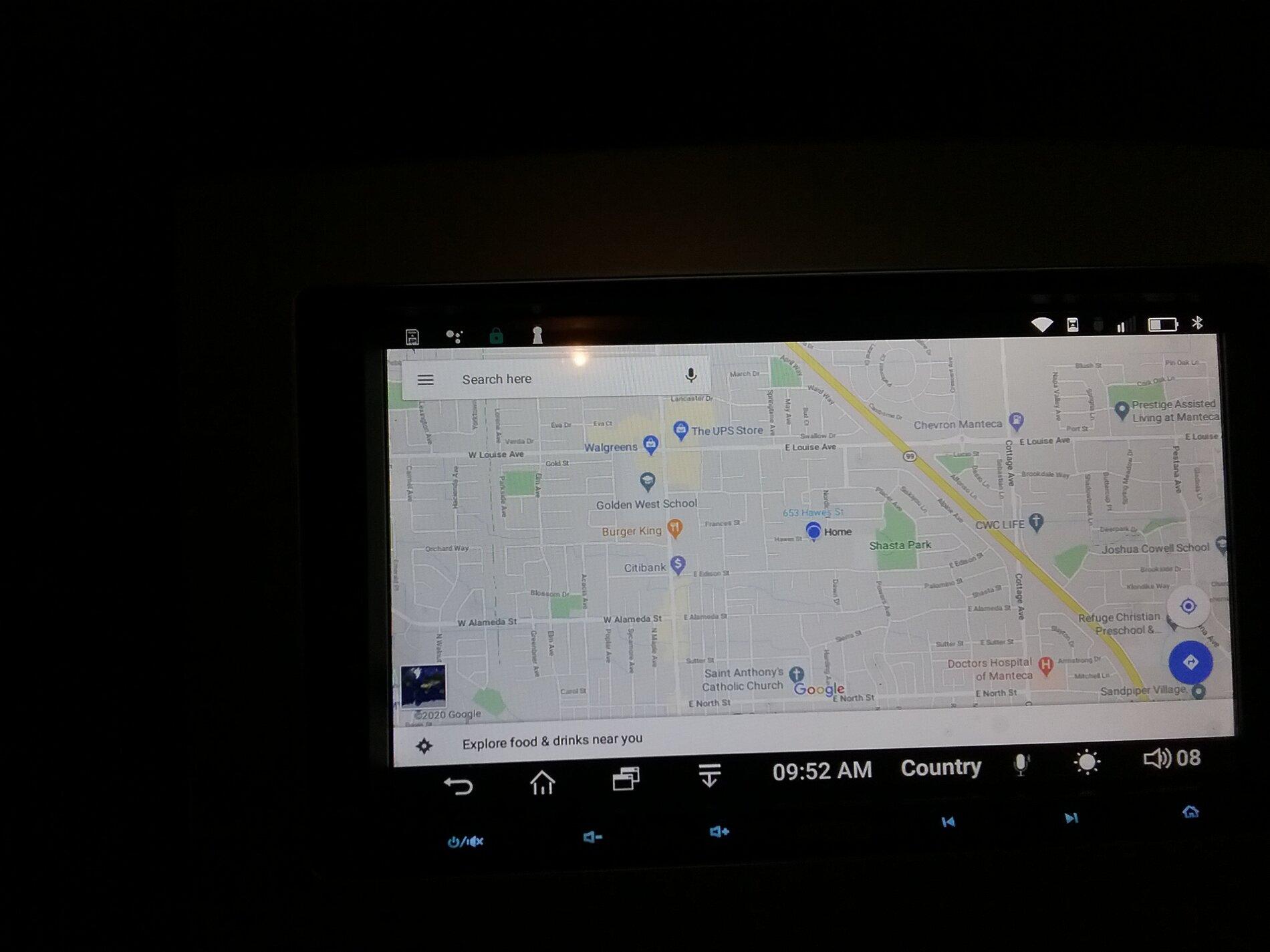

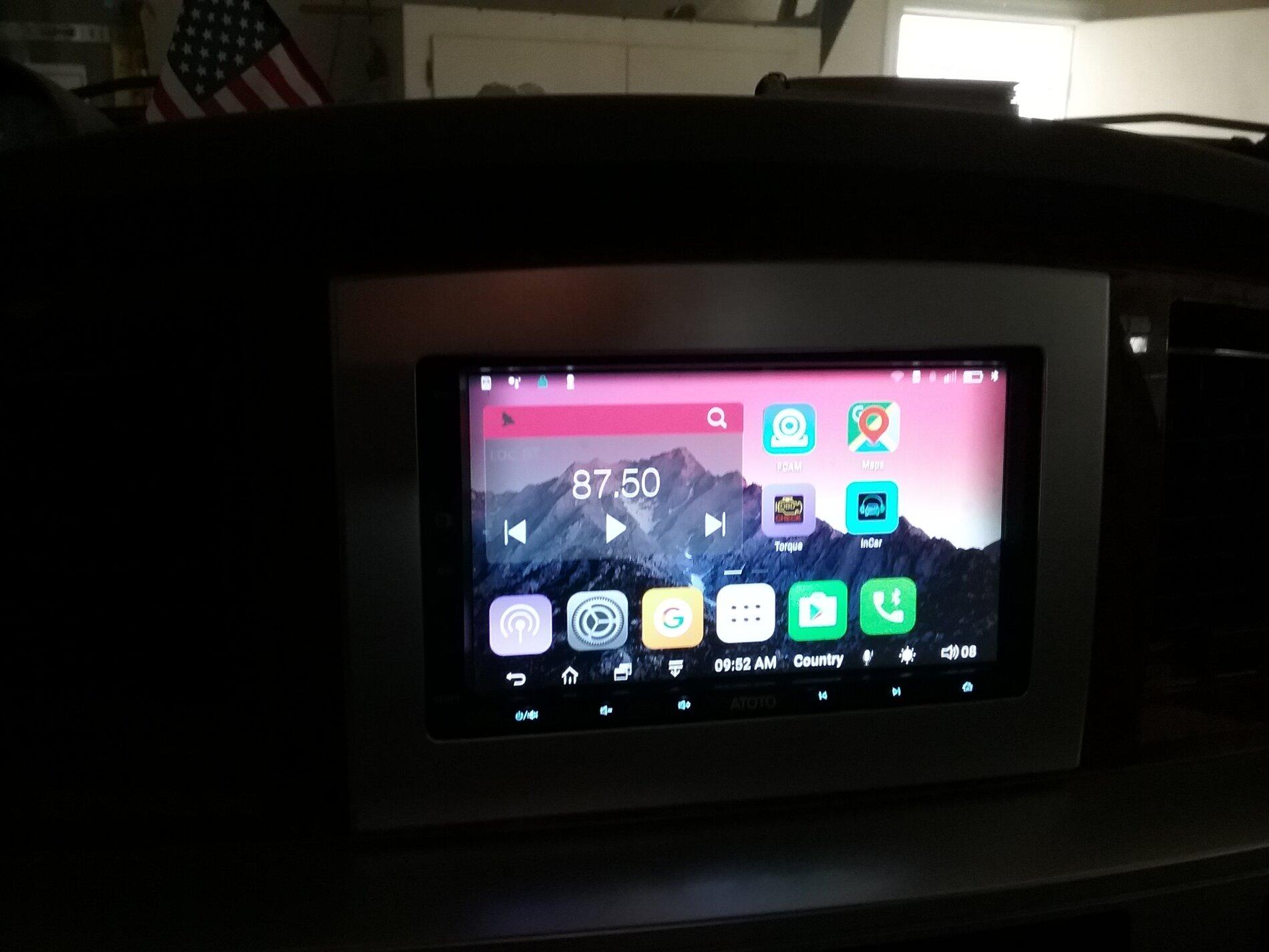

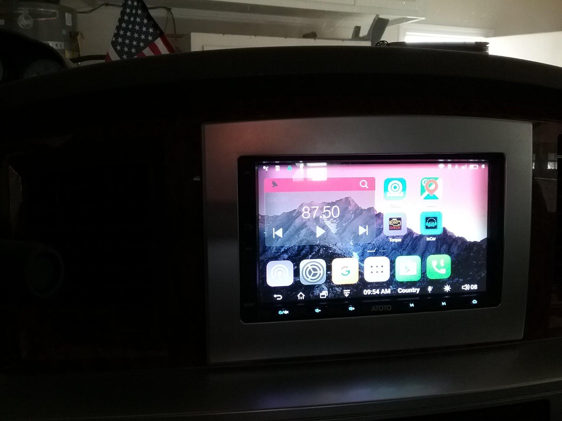

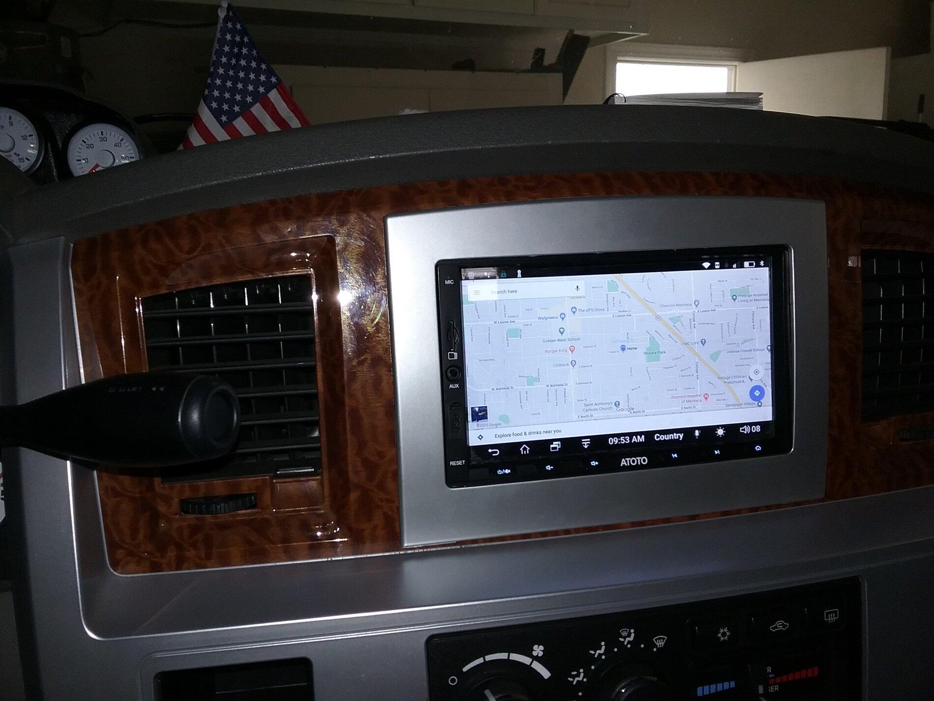

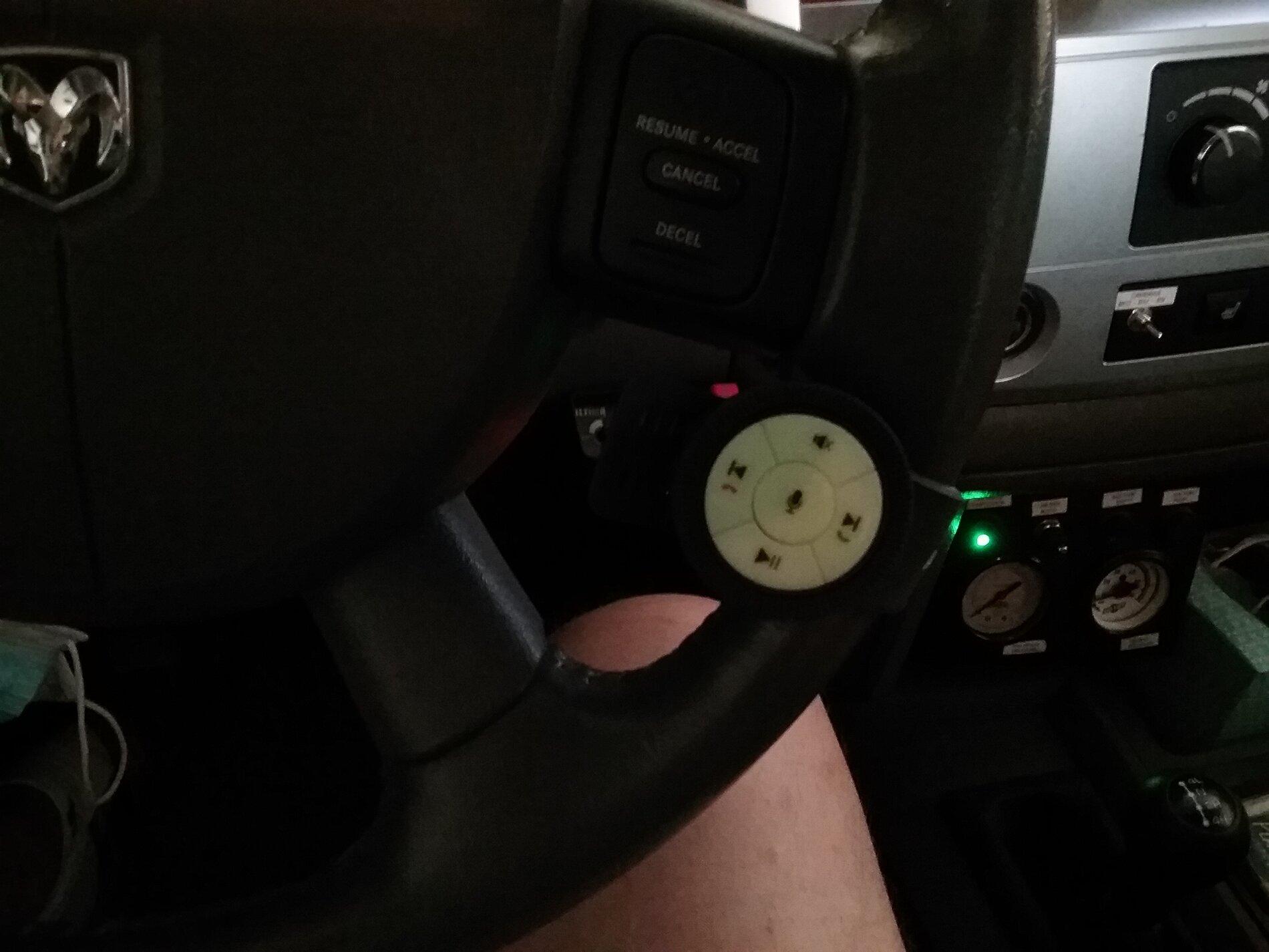

I recently installed a ATOTO A6 in my '06. I'm still learning how to use all the functions since I haven't driven much since the install. It is an Android that can mirror your phone, has rear view and forward view camera inputs and several USB connectors. It also has a steering wheel gadget to control radio volume, etc. as a separate option. I've rigged it up so I can view any one of 3 cameras in reverse (back-up, bed cam and RV rear view) I can also toggle RV rear view wile driving. A kit from Amazon gives it a factory look and modifying the opening to fit the 2 Din radio wasn't too bad. My pictures aren't great but should give an idea of the appearance

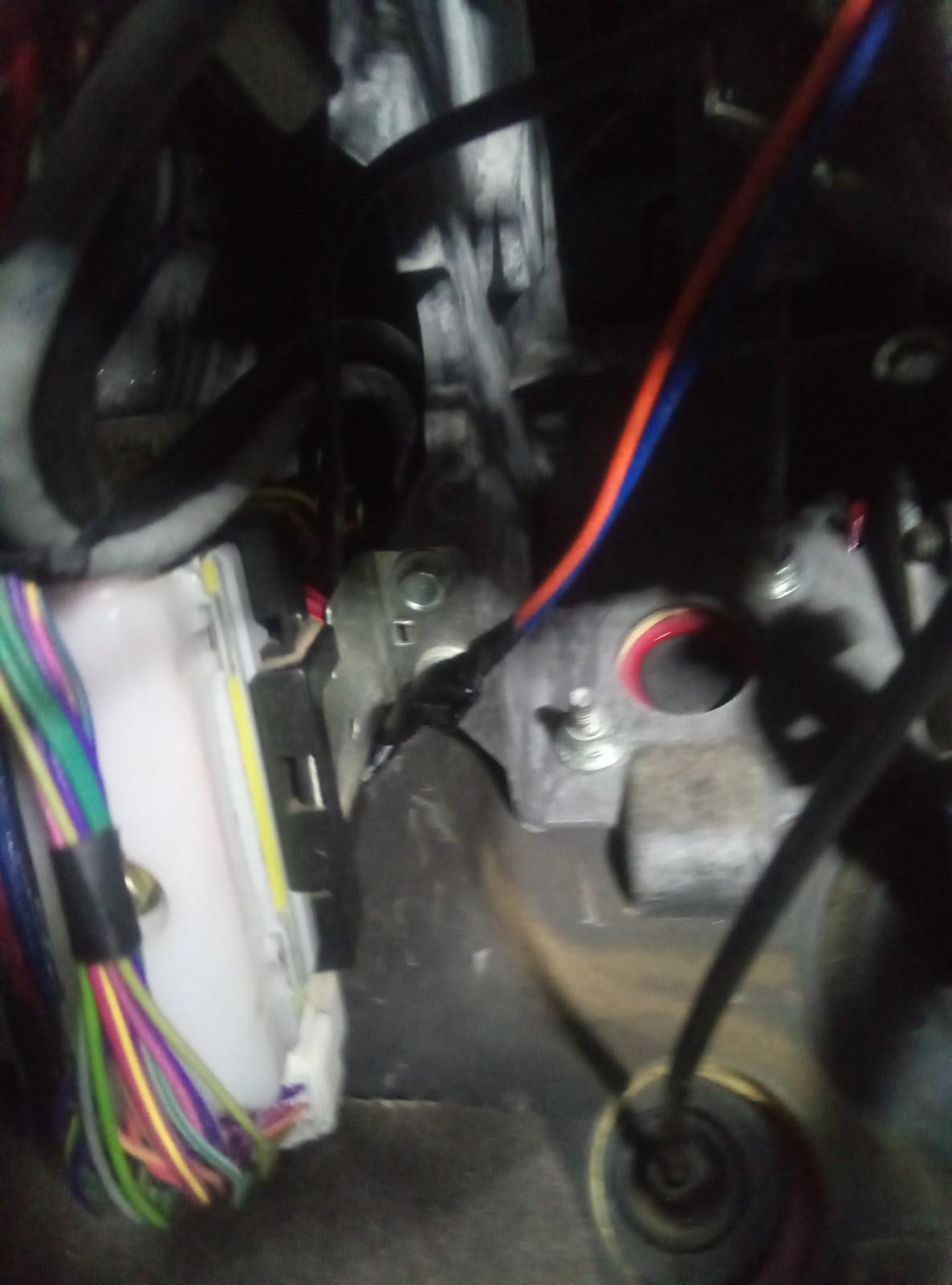

The hardest part of the install was the wire going to the park brake switch. To play a DVD the radio needs to see the park brake set. I removed the two bolts holding a set of connectors and tied the connectors out of the way as much as possible for acces to the park switch wire. I used a T-tap to attach the Park wire to the park brake switch wire. I also installed a switch to simulate the parking brake being set. Alternately, you may be able to ground just ground the radio park wire. I did not try that.

The ATOTO comes with a couple of map programs and is able to mirror your phone without adding anything. It can download Google and other maps to use offline and uses Google maps via your phone. It's also able to use your steering wheel controls. I added the one they offer although I'm not thrilled with it. I'm not certain about the infinity amp, though. Mine doesn't have it. It does have a number of wires and instructions for features I don't have. It does not play CDs. but has input USBs for DVD or other options. Look it up on Amazon. Gets pretty good ratings there.

That's the radio screen without mirroring the phone. Torque is included so you can add a wireless OBDII sender and use it as a code reader. That works well too. It has it's own GPS with separate antennas for it and WiFi. Both work without the phone connected. As will maps if the correct ones are downloaded (free).

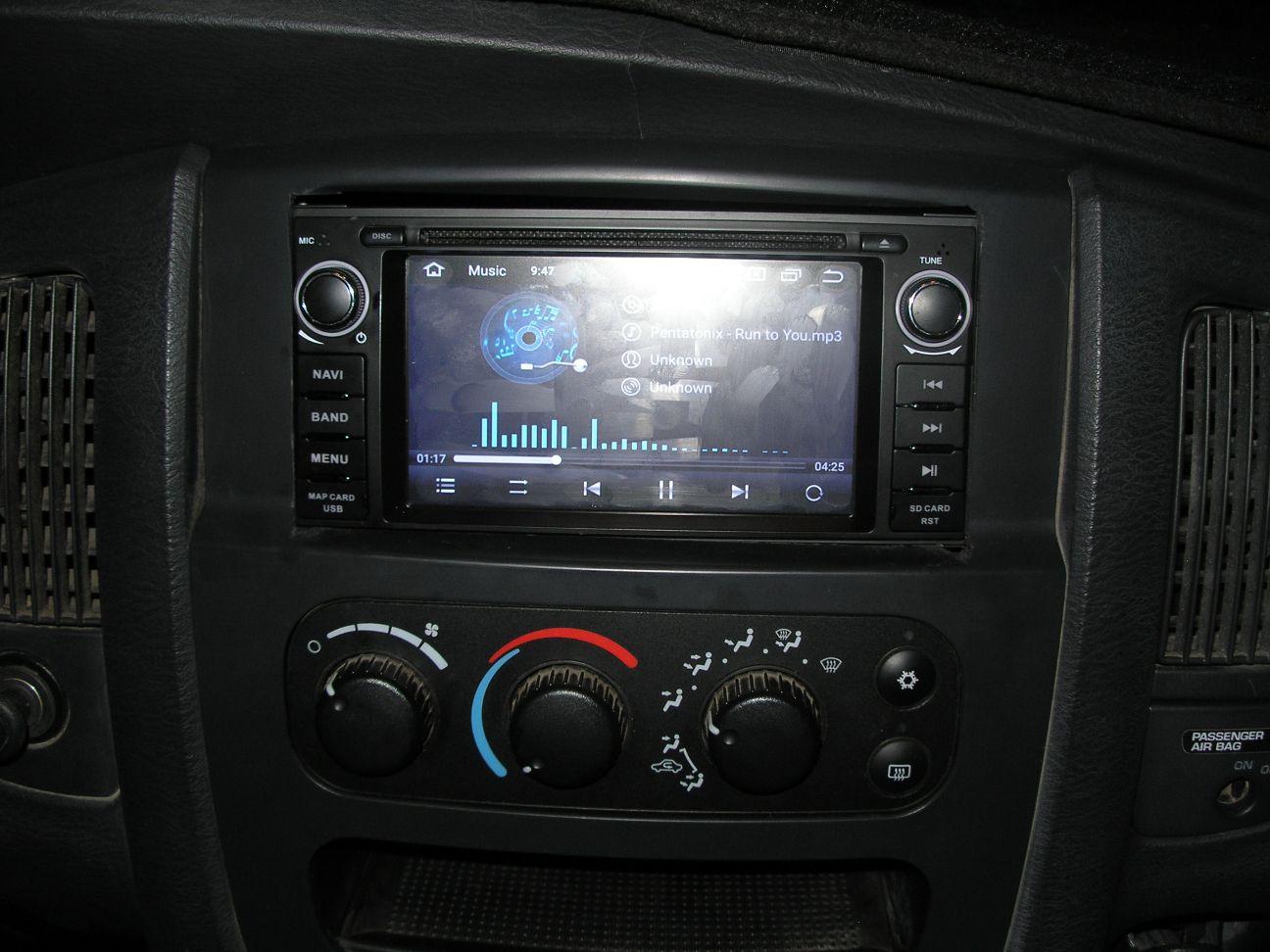

I put in this HIZPO unit [ oem for dodge] I picked it for the 2 knobs, also touch screen. Forward looking camera w/ DVR - rear camera but it is an andriod unit so it even takes the wifi for the camera on the trailer. Nav is in it and phone.
it's face is slightly wider than a double din but I did not have to cut the under-dash to install it, the electronics is a single din.
