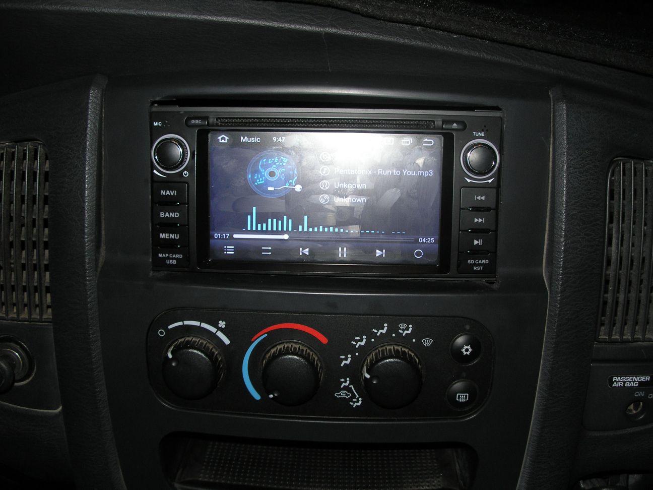

I put in this HIZPO unit [ oem for dodge] I picked it for the 2 knobs, also touch screen. Forward looking camera w/ DVR - rear camera but it is an andriod unit so it even takes the wifi for the camera on the trailer. Nav is in it and phone.
View attachment 123688 View attachment 123689

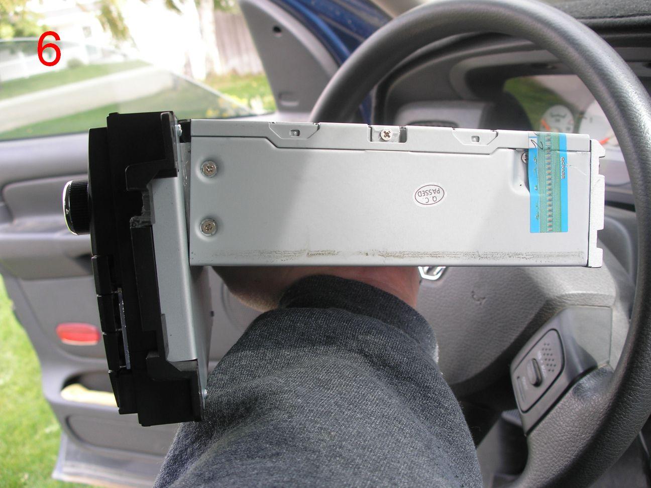

it's face is slightly wider than a double din but I did not have to cut the under-dash to install it, the electronics is a single din.

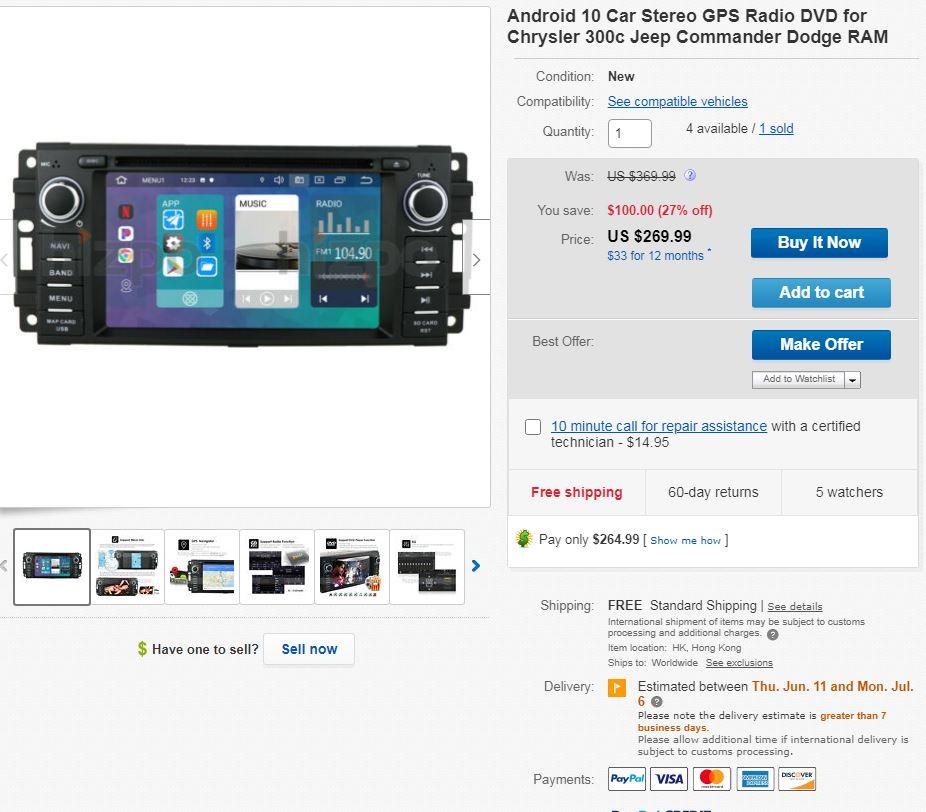

Is this the one you used:
https://www.ebay.com/itm/Android-10...350455&hash=item342f8efa0a:g:skQAAOSwxuNfSHla
How is it with speed, like with Google Maps? It looks like a good unit, but the processor and memory look a bit low, wondering if that has been noticed.
Also, looking at the specifications, it appears to connect to the car CAN bus, did you connect to the CAN bus? Does the car recognize and communicate with the unit via CAN?
Yes I beleive that is my unit. I can not tell you about the Speed because I don't know were I would see speed. I do not use google maps , I use the nav system in it [ I-Go ]. You will have to tell me how to test speed. My 2004 dodge 2500 does not have the CAN Bus system, the wiring harness that you see with the CAN Bus adapter is still sitting in the box.

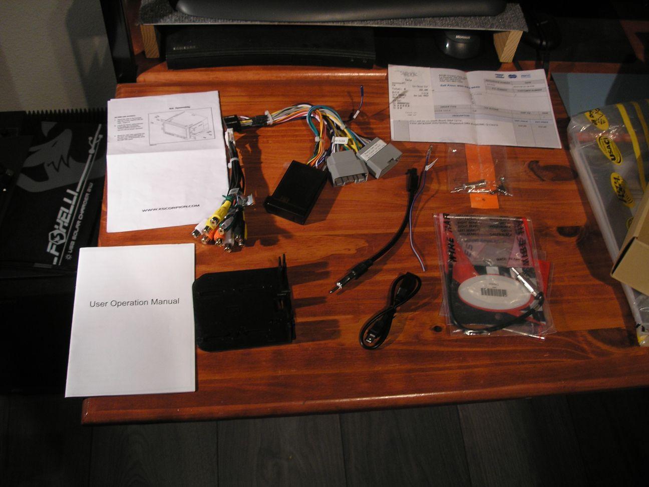

left over parts [clockwise from top right]
receipt from the wrecking yard for the dash bezel
transport screws
antenna adaptor
usb cable [why does anybody need 3 usb]
antenna adaptor again
blue wire for amp switch on
mounting plates from the Double Dim adaptor
manual for the Hizpo
Double Din instructions
RCA for everything
wiring harness for CAN Bus system
BIG NOTE -- I did not see RCA OUTs for rear speakers just fronts
there connections for them but they are not shown in the ad.
We would have to see if we could get you that cable or you would have to use the HIGH SIDE INPUTS on a 4 channel amp
What are you putting this in ?

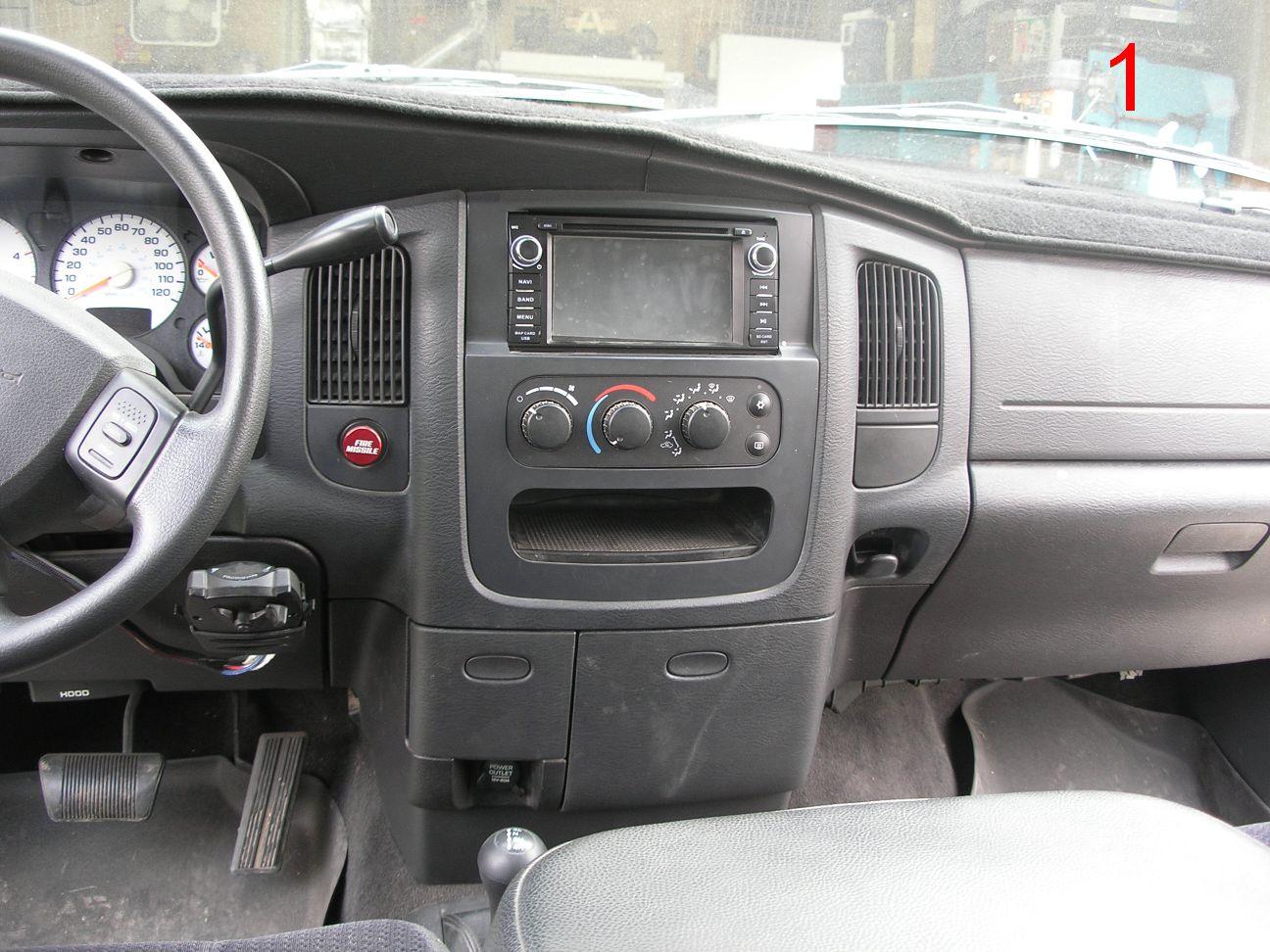

pic1 After the Install

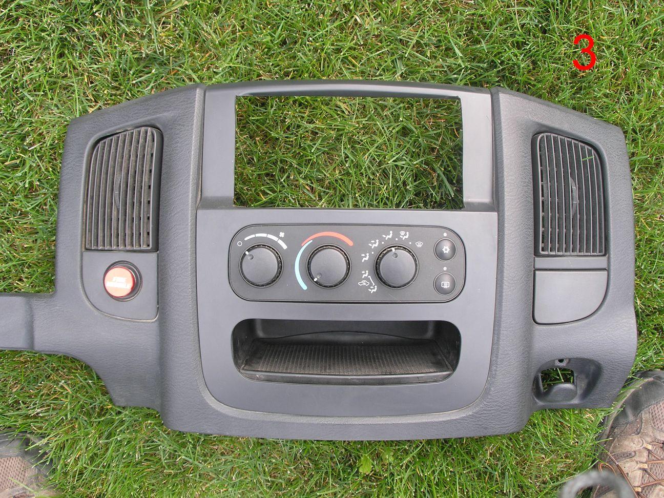

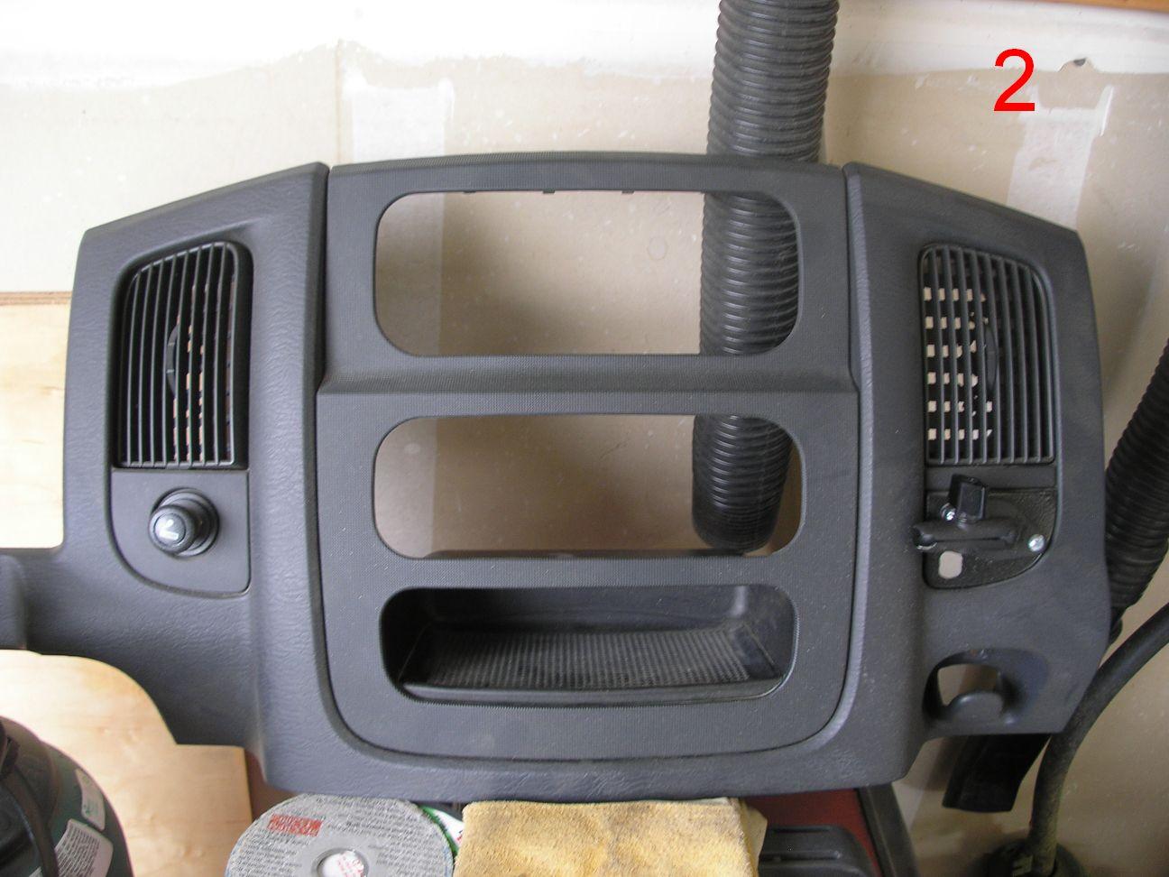

pic2 I bought a used center dash bezel. I like to keep the old parts incase I ever want to go back to stock
pic3 The dash bezel after I put in the double din radio bezel

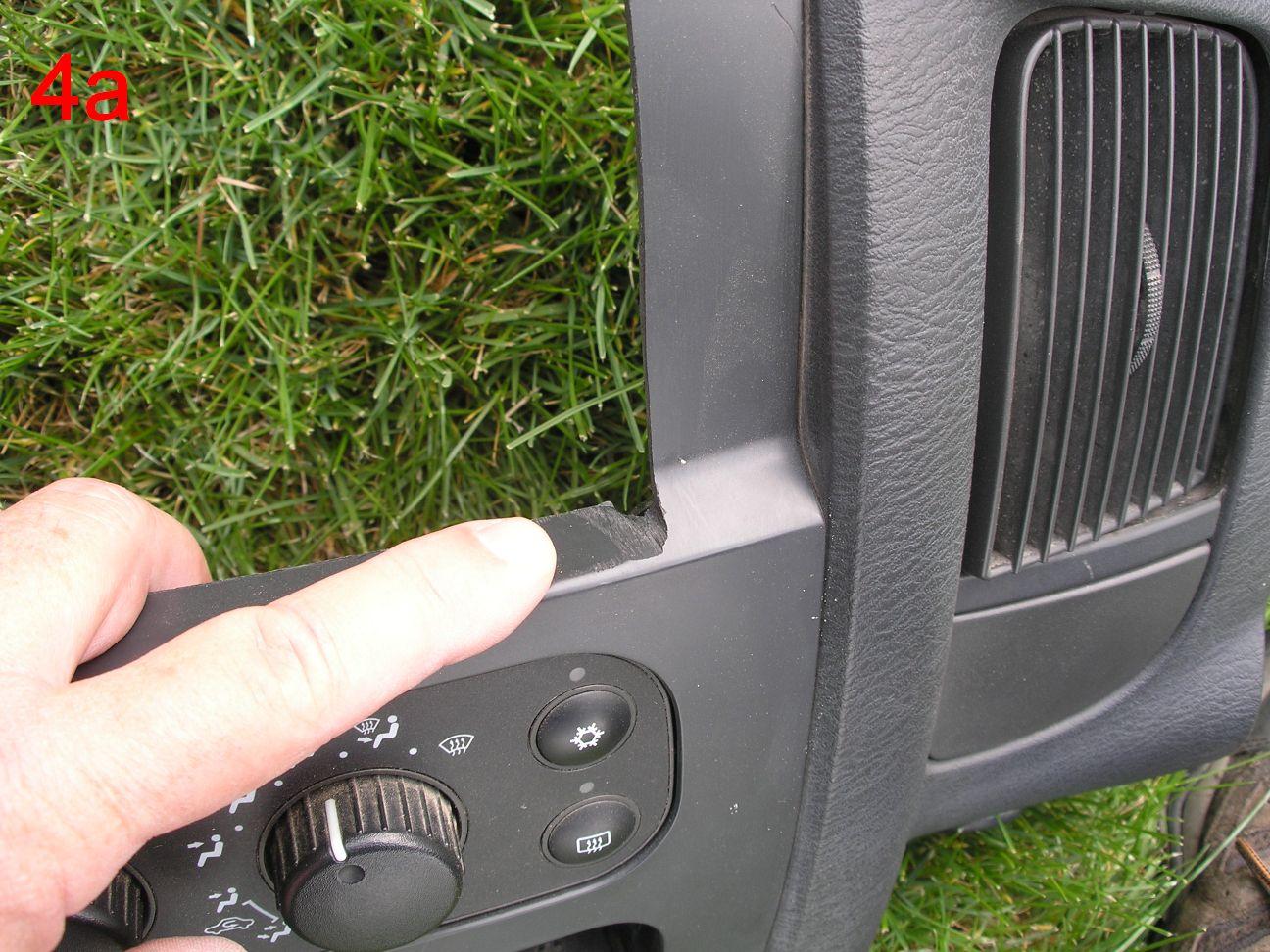

pic4a Because the unit I got was a bit larger than double din I had to file mine out a bit

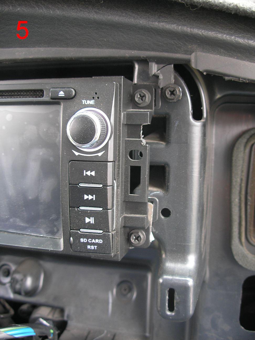

pic5 Because mine is a bit taller than stock the mounting holes did not line up a small piece of metal was made
pic6 Double din face but single din body so I did not have to cut the substructure

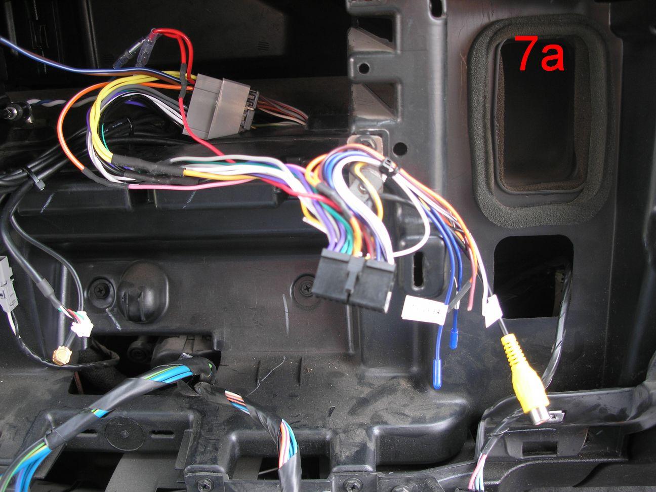

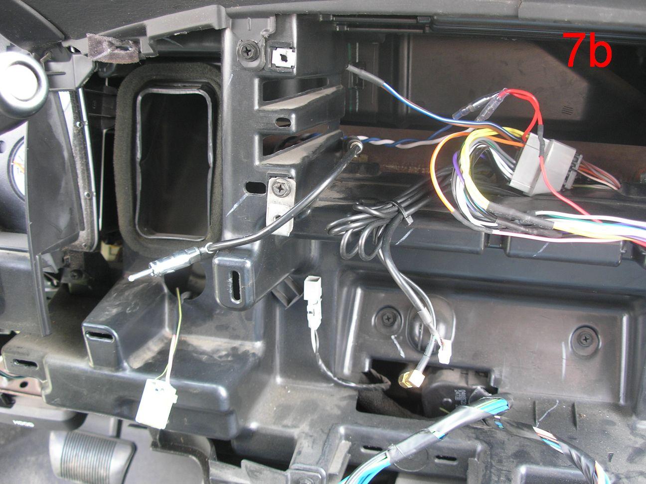

pic 7a-b-c Using a wiring harness adapter soldered the correct wires together. I did not need all the wire connections for my truck. A is the wires for the unit. B is the GPS, WIFI, and 2 USB cables. C is for the other problem - my unit turns on every time the key is turned on and I did not like that - I ran the power wire to a switch to "bypass switch"

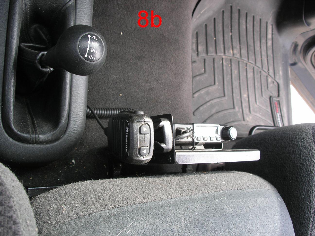

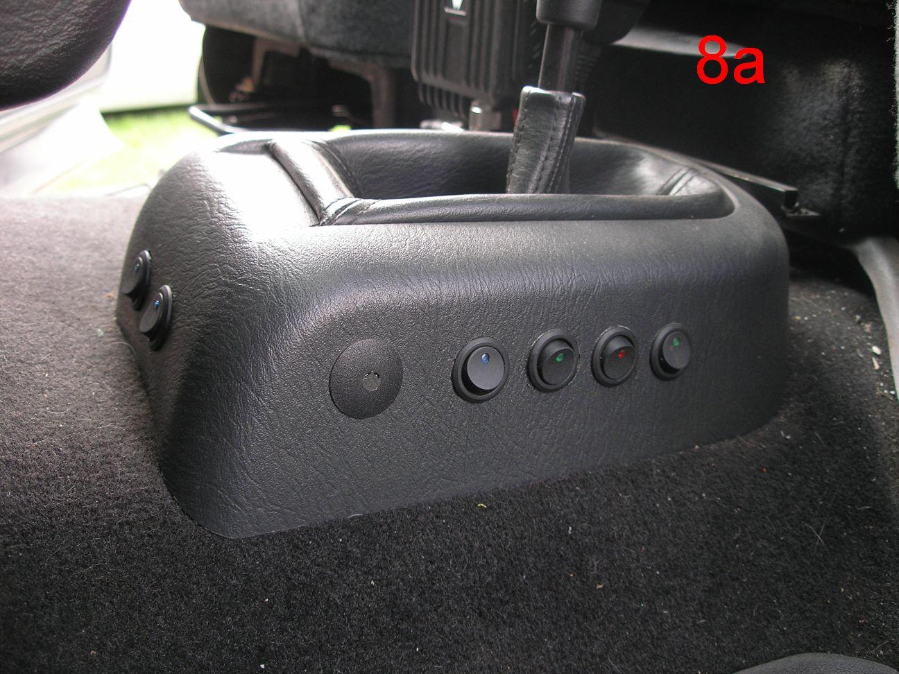

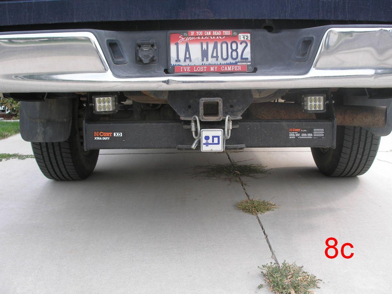

pic 8a-b-c I am not 1 to punch holes in my dash - I like to keep it clean looking [Grampa style not 18 year old style] so I got a floor shifter surround and put all the switches there. Switches for rear looking camera, radio bypass, rear floods, spare, forward looking camera and main power for the FRS radio.

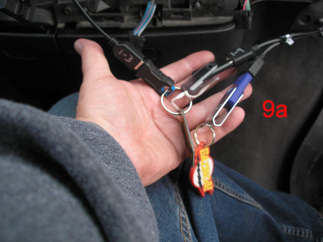

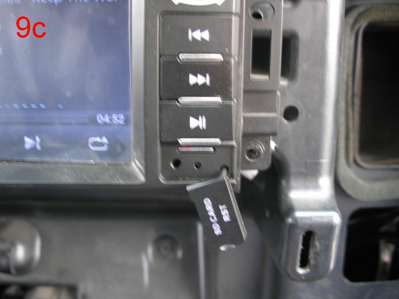

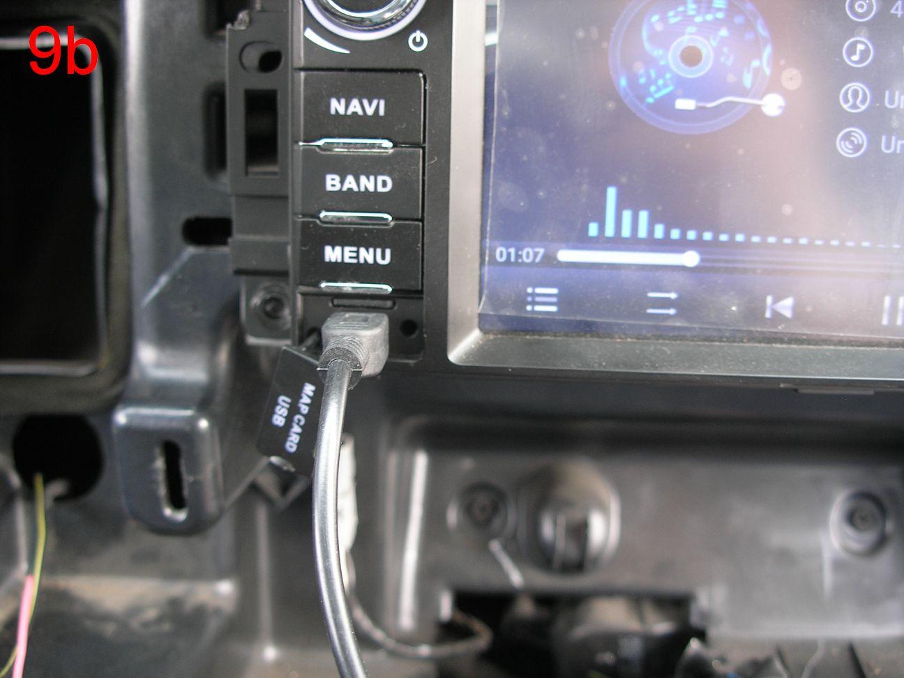

pic 9a-b-c 3 USB ports. 2 from the rear and 1 from the front. I don't use the front [if it dangles you will break it off]
Left side of the unit is micro sd for the NAV maps, and USB Cable connector. Right side is micro sd for all my music. I then load any other music on a thumbdrive and Wife has a thumbdrive for her music. That is enough for any normal human being.

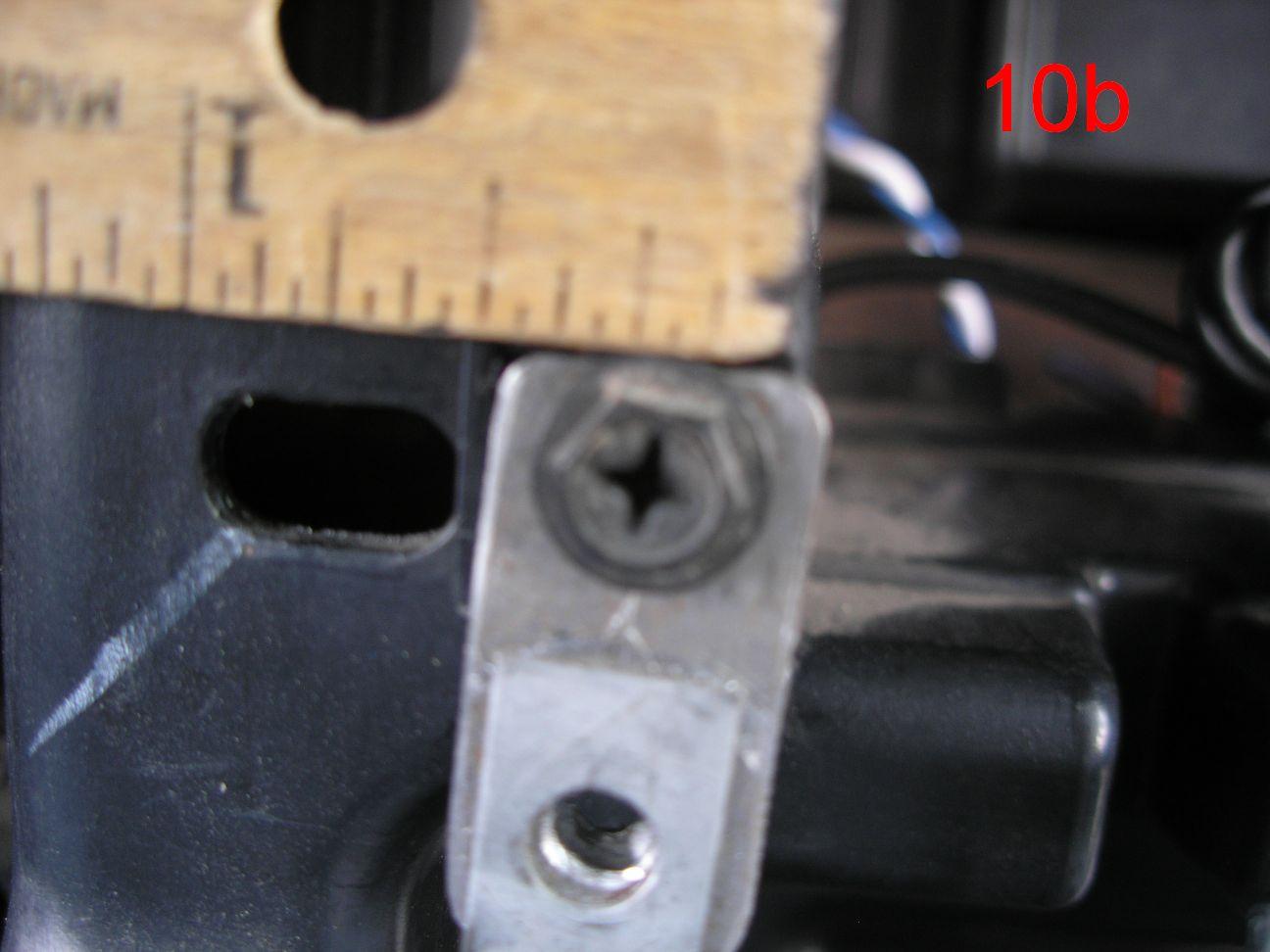

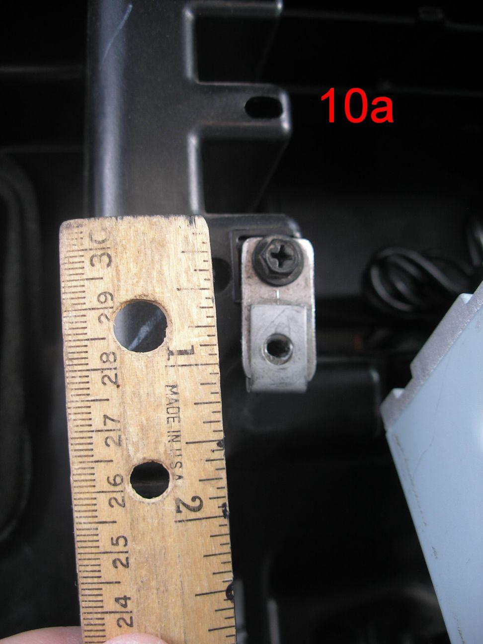

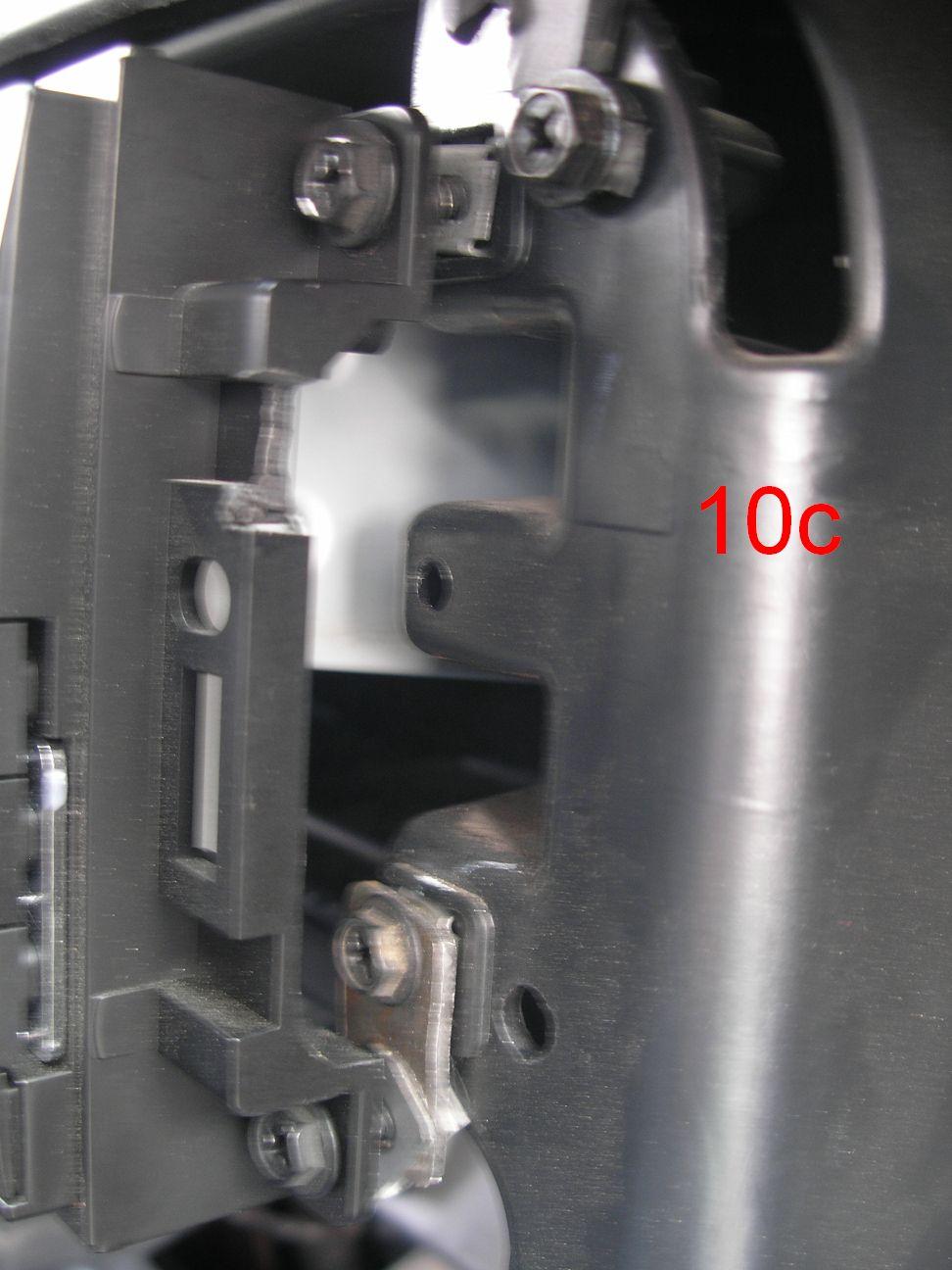

10a-b-c the little bracket s are 1/2 wide and 1 inch long wath a speed nut. Again they just give me a place to use the lower screw points.

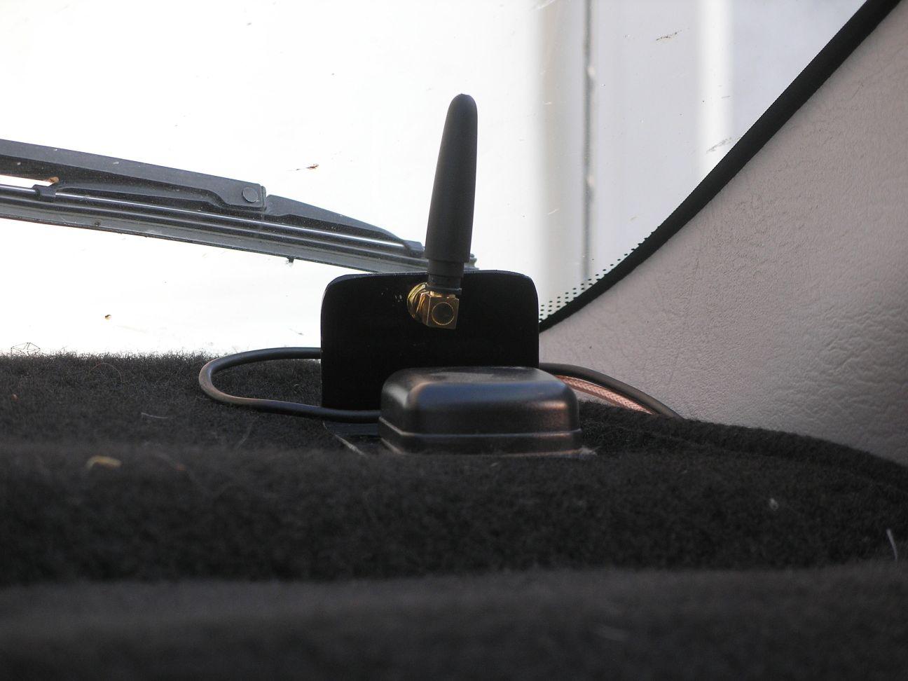

I finished it today. I never understood why you would want the WIFI antenna inside the dash. I bought the correct cables and adapter thingy to put the antenna up on to the dash for better reception. I had to make a small bracket for the antenna and the GPS puck .
And now it is done. The last thing to install was the rear camera. I elected to use the one on the tailgate handle so it would look down on the tow ball better. Got it from Amazon. Just because they say it will fit your truck - keep the wire path short. 4 door - 8 foot box and I just had enough to get there. The nice thing about this camera is that it had a sense wire in the wiring loom.
I put a relay behind the driver side tail light . This allows the truck to turn on the rear flood lights with the reverse lights and also I can turn on the floods when I an connecting to a trailer at night. My sense wire was connected to that flood light wiring. I can turn on the reverse camera as I am driving and check the trailer.
