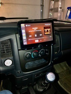

I needed to do a few things to keep my truck relevant and the electronics were top of the list. I put a Kenwood DMX1037 in a while ago. Really like it. There are a couple of very similar units and vary in price by several hundred dollars. Install wasn't that bad at all. Wireless car play is convenient when on the road. Alpine and Kenwood are the same company and offer very similar floating screen units, but the Kenwood unit has a volume button that the Alpine does not.

I agree. The Alpine Halo series unit are floating screen with most if not all of the features of the Kenwood pictured above. The Alpine unit is also single DIN, a plus for some. The biggest reason I went with Kenwood was it has a physical volume knob (they now sell one separately that is Bluetooth connected), and I had read that some of the single DIN large floating screen units were not as solid feeling as the double DIN.

The updated system brings the truck into the modern era at least electronically and is one of the best updates I've done.
