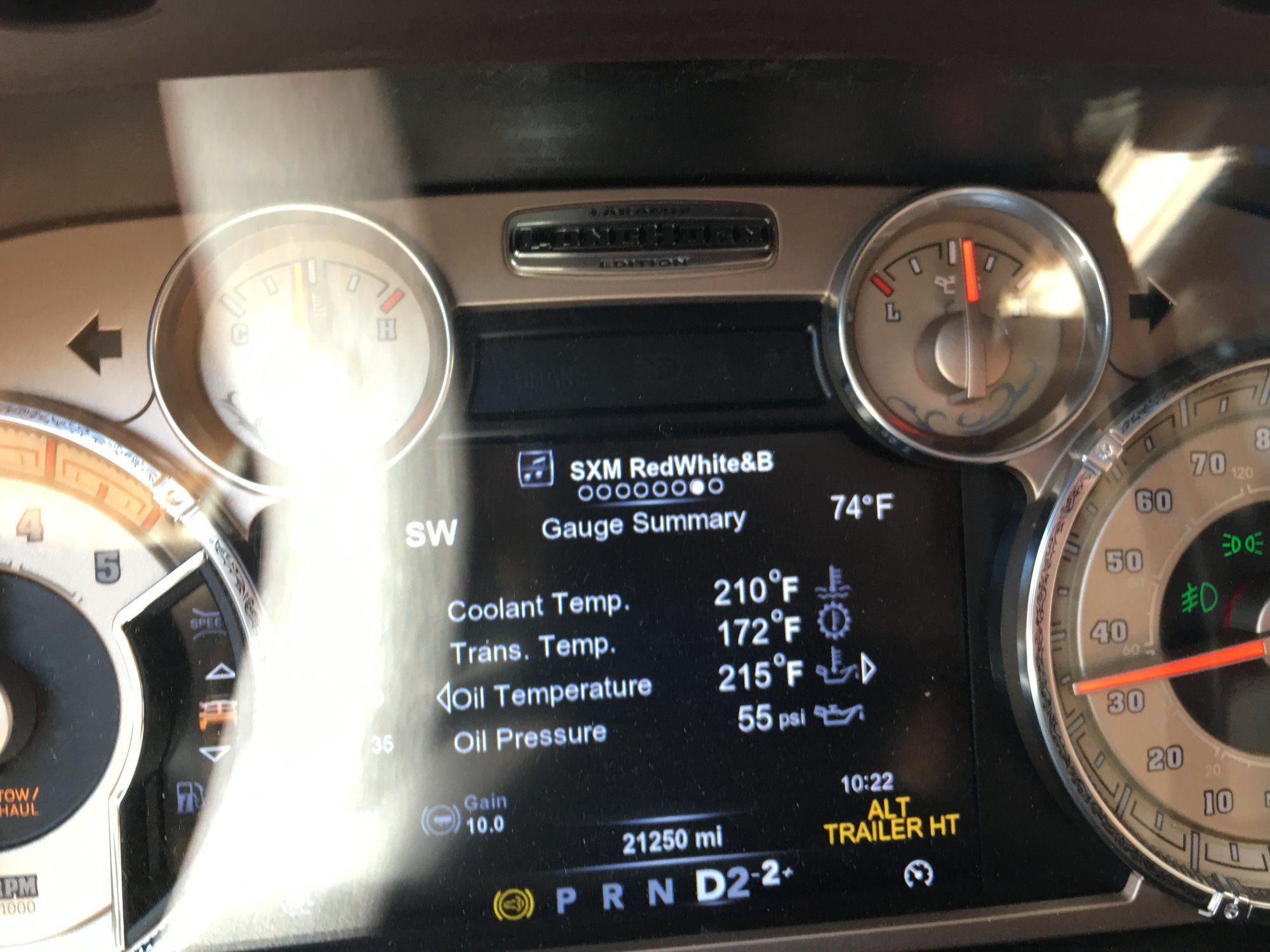

I control 33-35k combined with the AISIN easily on down hill grades from 5-14% running proper gear and cruise control.

I locked 2nd Set cruise to 27 or so as I would raise it up or down. It held 30-35 mph over several miles of 14% grade with the combined load 33k.
Hope that explains how it works.
Interesting. Any idea what the RPM's maxed out at?
Let's see. Let me guess you have the 4.10???

NO, the higher the gear ratio the less the hold back on the exhaust brake gear for gear.
"Interesting. Any idea what the RPM's maxed out at?"
About 3K.
