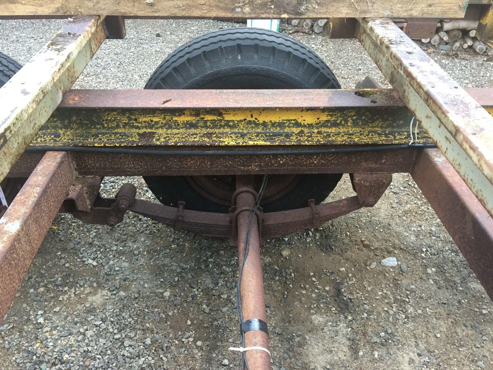

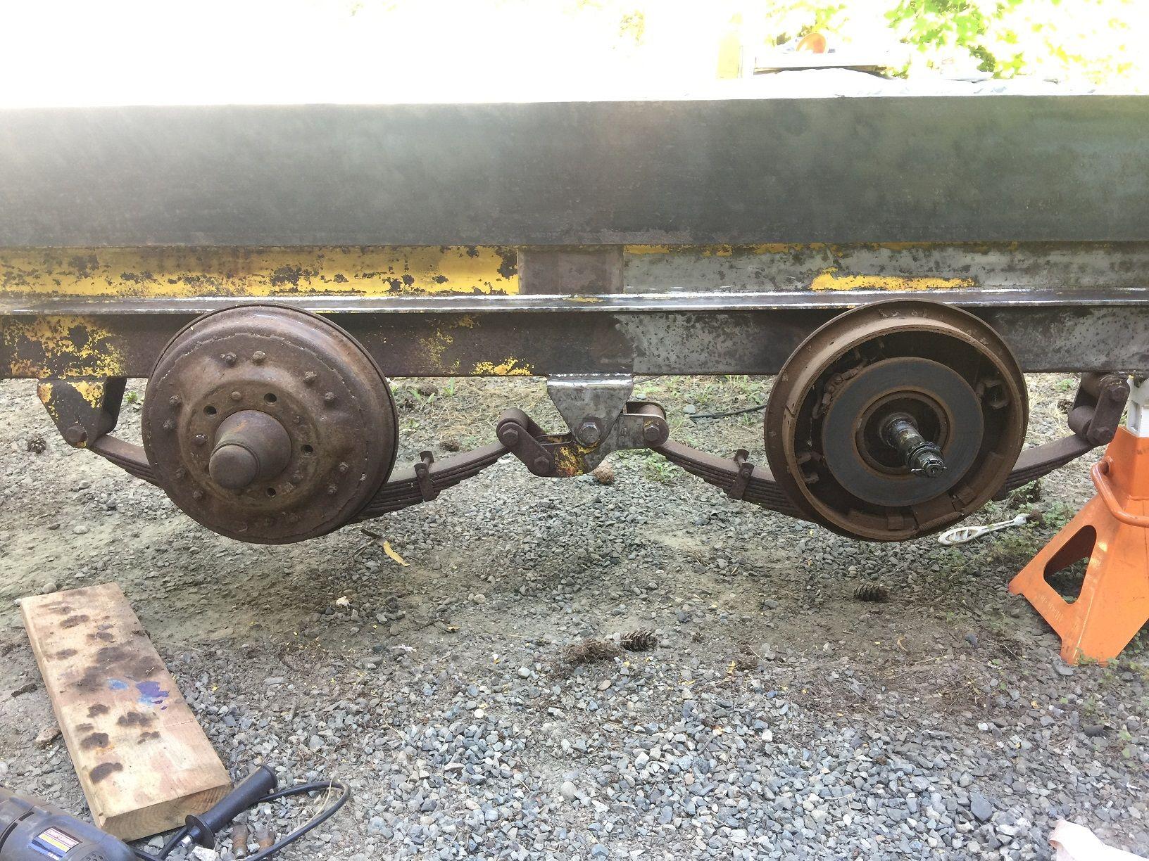

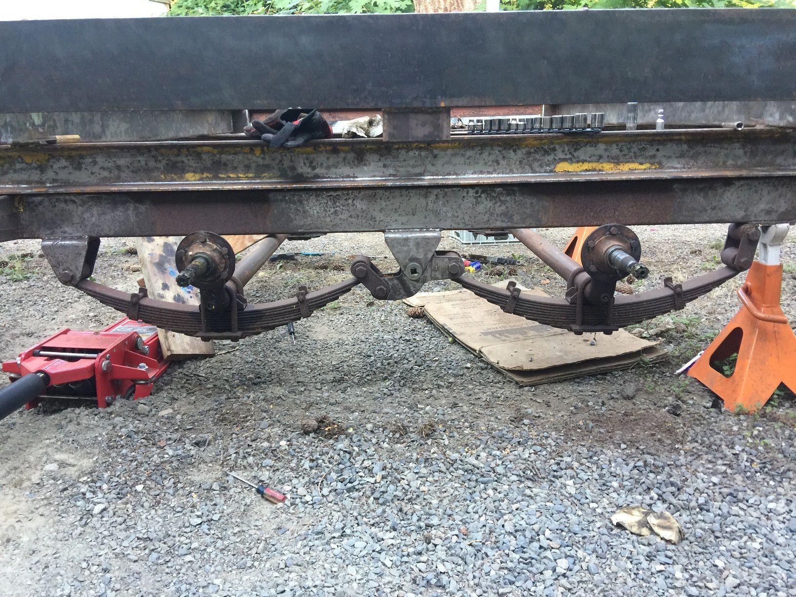

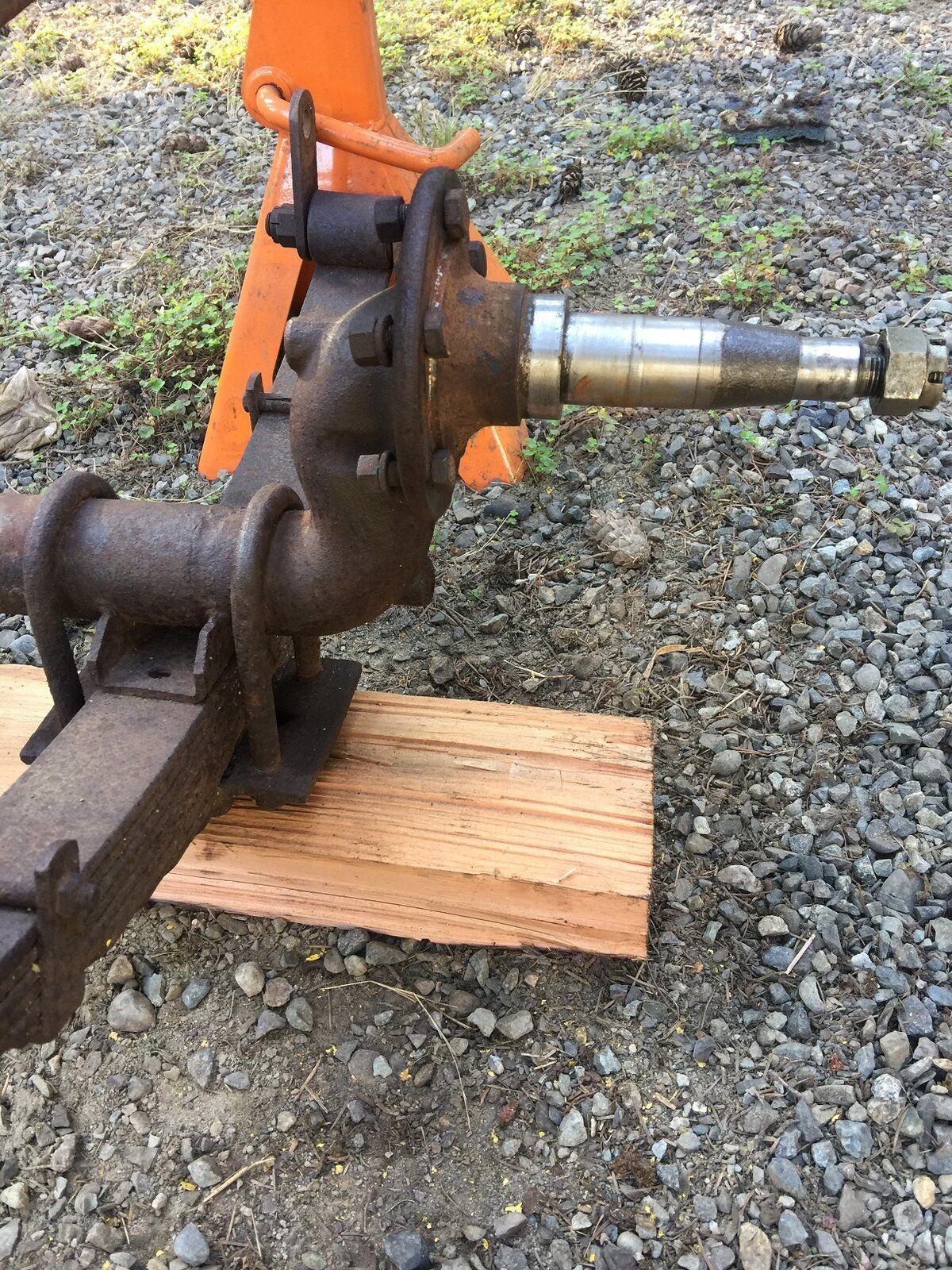

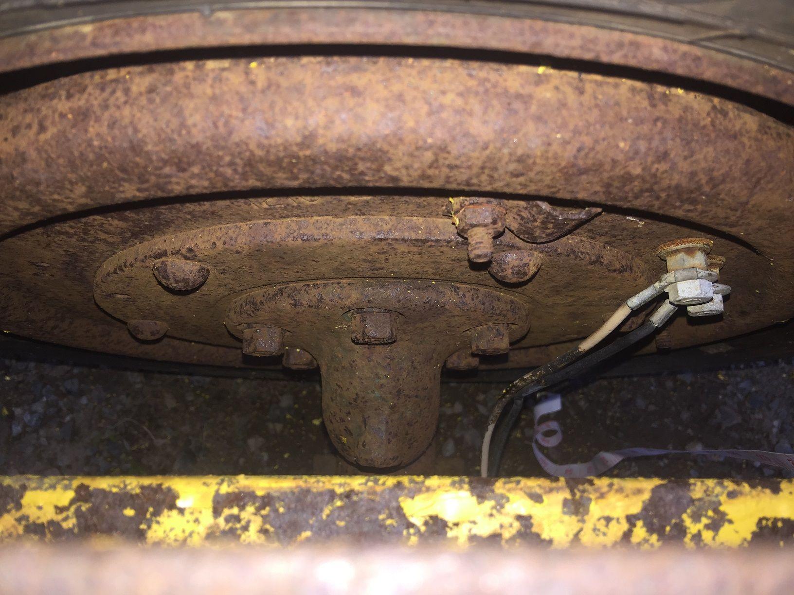

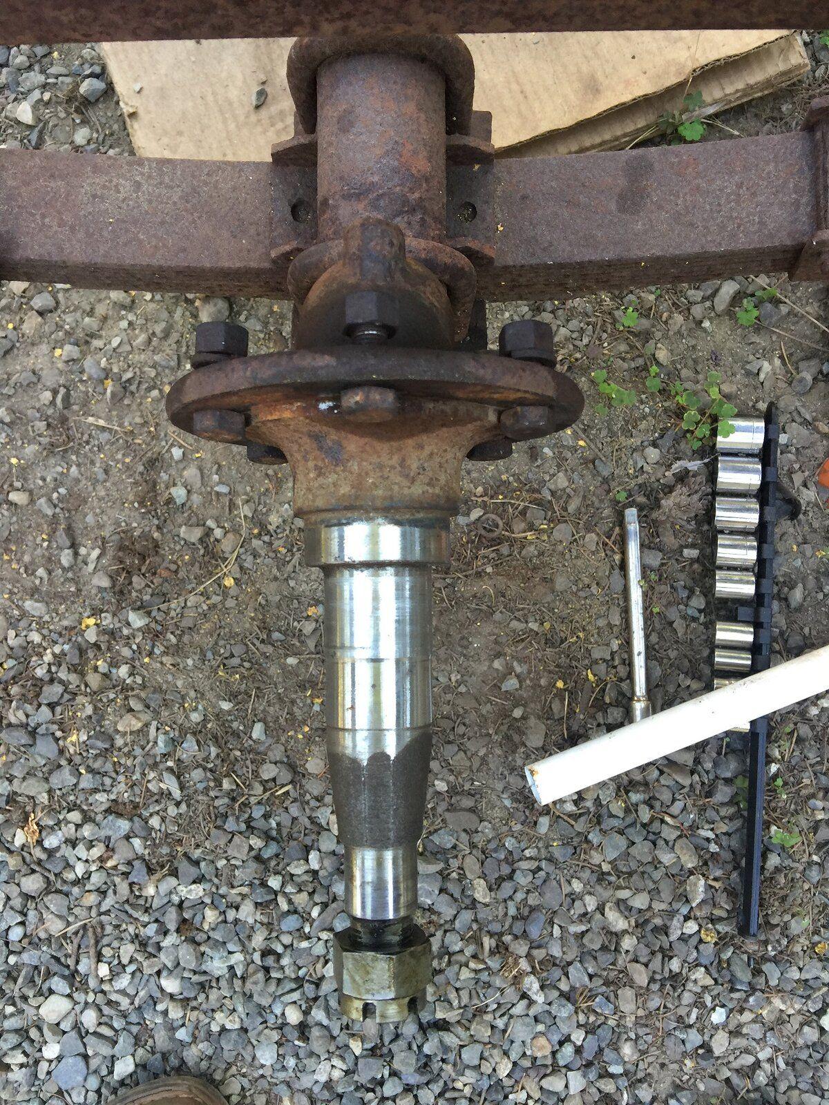

Hello all,

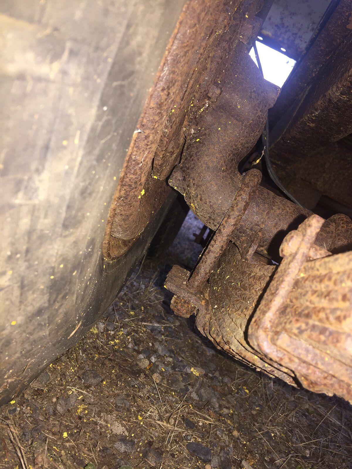

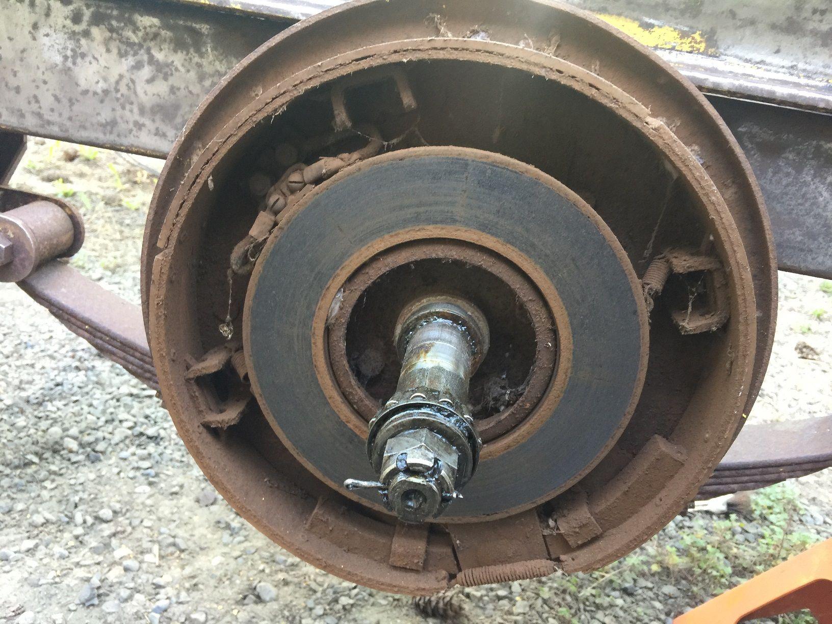

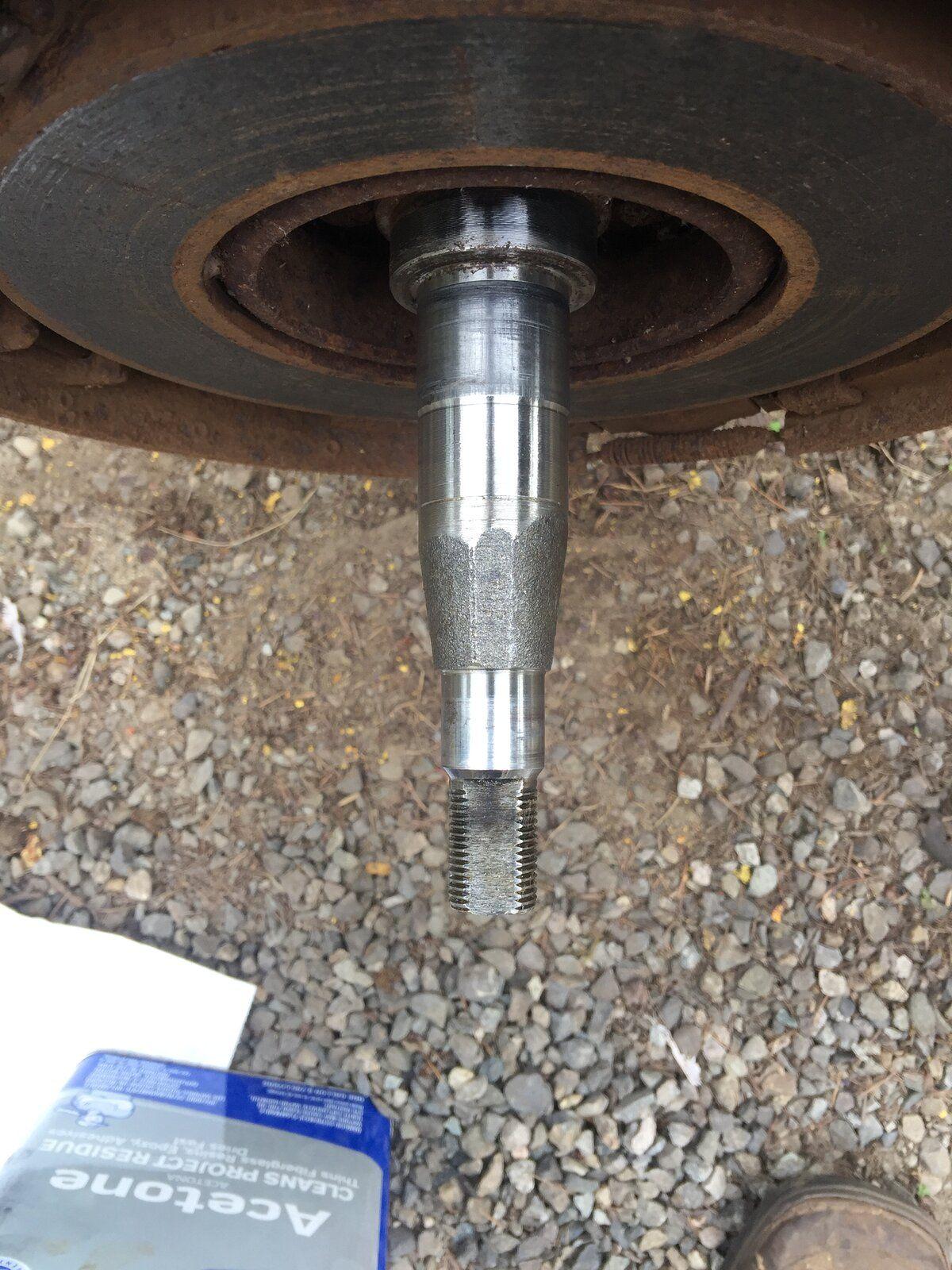

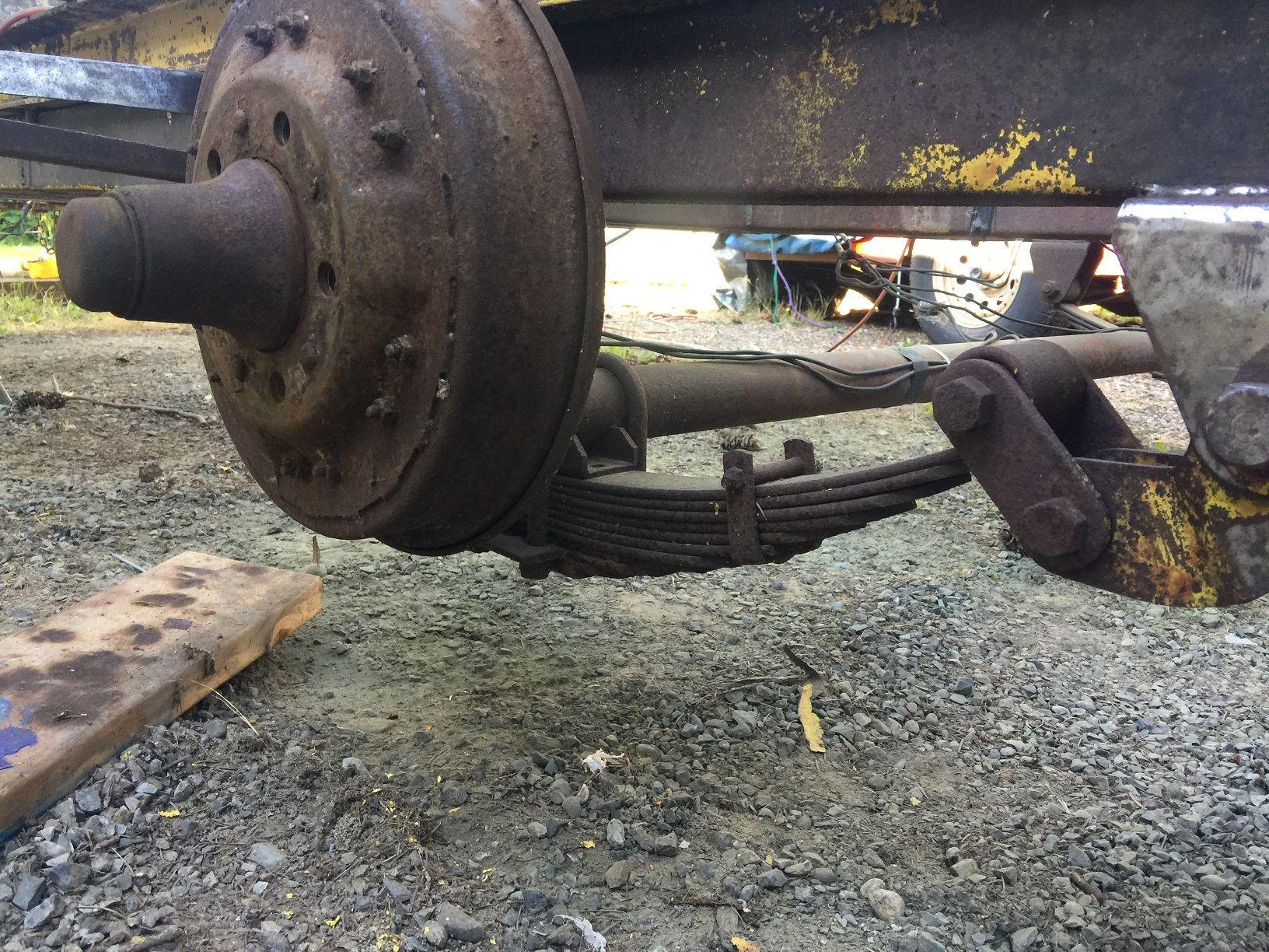

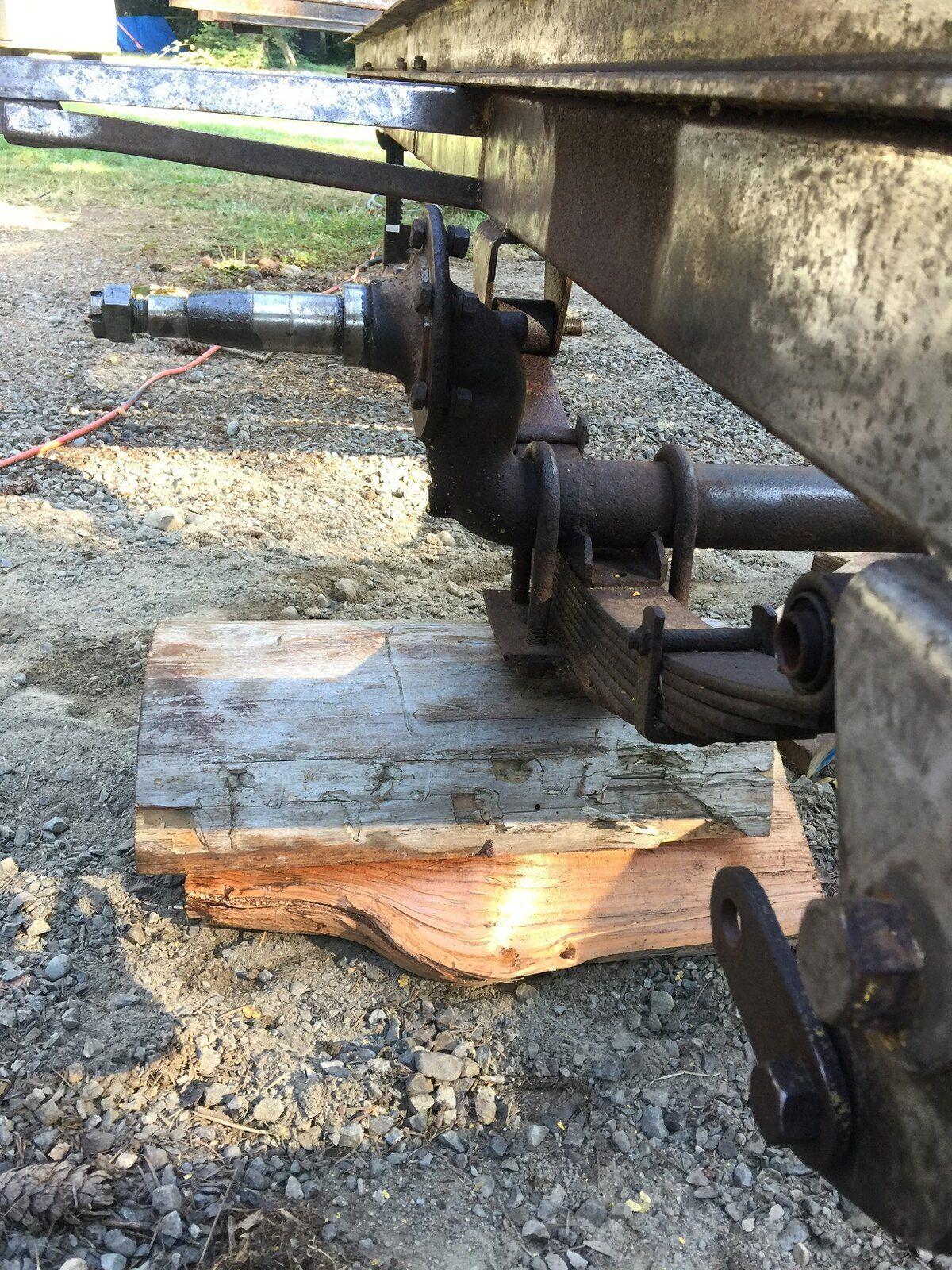

By chance do any of you have pictures of your axles that you can post or PM me? I purchased a trailer that was converted to a deck over flatbed. I have started stripping it down and I can't find any information about the axles. It does have older Warner type brakes. The axles diameter doesn't match standard dimensions used today; my axle diameter is 2 1/8" or 2.125".
If any of you have insight to the actual manufacturer or capacity of these axles, it would be most appreciated!
Thanks!

Let me add that if you elect to buy new axles I suggest you go with 6 lug hubs. HD tires are much easier to find in 16 inch. I use LT tires on mine.
8 lug hubs are even easier to find wheels for. The price is virtually no different between the two. ETrailer.com can be very helpful finding parts, comparing, and researching.
