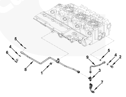

There are o rings that attach to #3 that are known failure points over time. Same with #4 & #5 in both locations. #6 is the overflow valve on the VP, but if you have good fuel pressure once the truck is running I'd wager that it's operating as intended .
