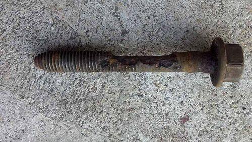

does it sound /feel like it's coming from right under your feet?
took me awhile to fing this same (I think) noise.
ended up being the cab to frame mounting bolts.
It's not a matter of just tightening them (tried that first) you'll have to take them out.
a couple of the bolts were have rusted away so I replaced them. The mounting holes in the isolators were full of rust/dirt/junk.
cleaned them out, replaced the rusted bolts good to go for 2 years now.
this is why just tightening won't work.
there was 3 like this.
Impact gun got it out.
ratchet probably would have just twisted it right off.
But like I said new bolts, cleaned out mounts/isolators NO more noise!
PAIN to find the problem.
