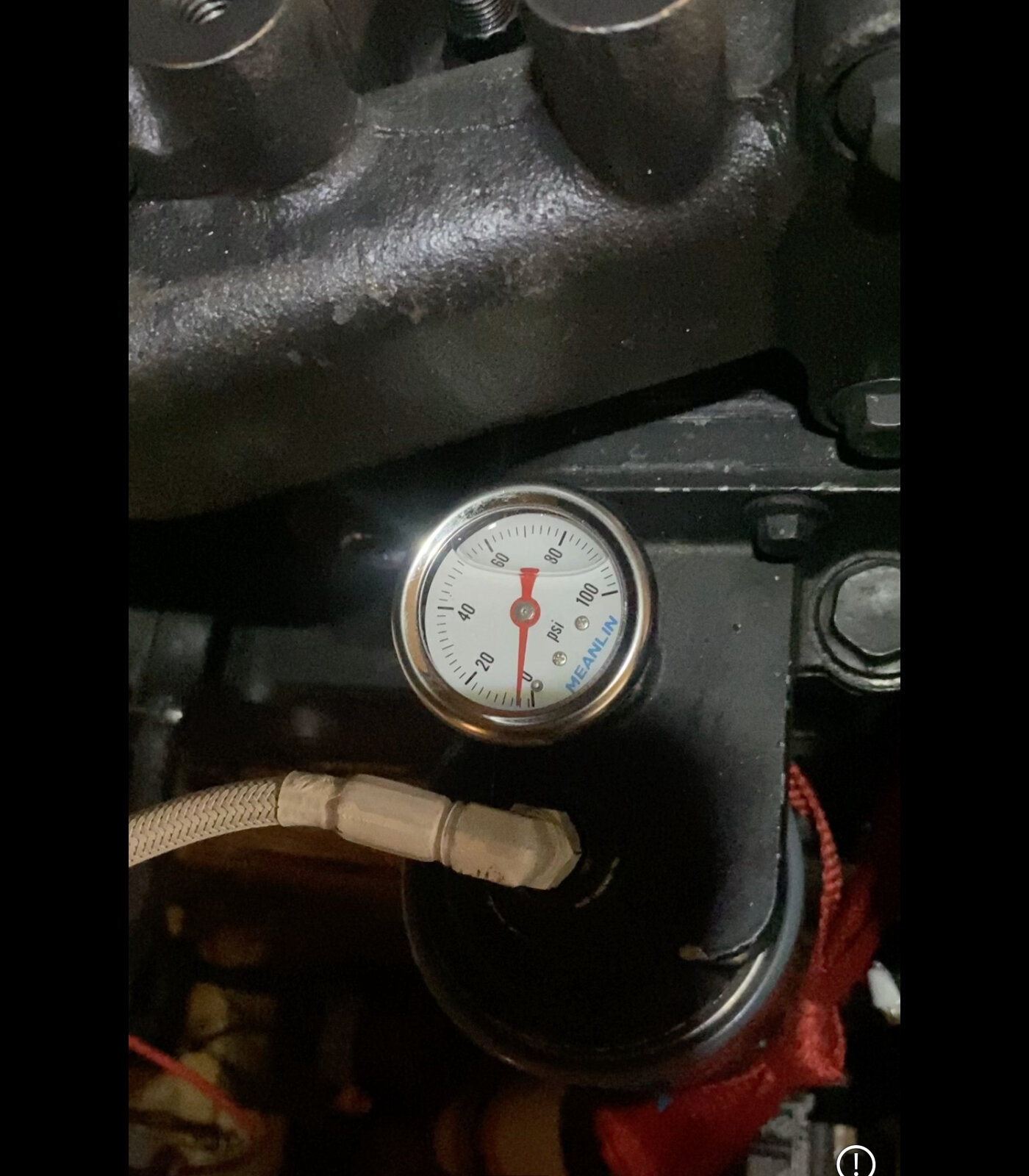

After rebuilding I am getting 25 psi at start up but then as it approaches 140 F oil temp, the pressure gradually drops down to around 6 psi. At that point, I shut it off. Otherwise I wouldn’t be surprised if it went down to zero. When I rev the throttle, there is a corresponding increase back into normal range ie 10 psi per 1000 rpm. I already replaced the pressure regulating spring and no change. Next, I’m gonna replace the oil filter head and the bypass valve. If that doesn’t work, I’m going to replace the oil pump. If that still doesn’t get it, taken care of, I think I’m going to have to tear down completely and rebuild again . All I know about the history of the vehicle is that it is a 97 p pump outta a F600 and was a KDP kill (p pump gear, cam gear, and crank gear had broken teeth; I reused the oil pump and torqued in sequence per the manual). Question 2: is it normal to get a little bit of oil blowing out the back of the turbo at high RPMs? It’s like 1-2 cc’s in 20 seconds…I am still running the engine in on the stand. Thanks!

9-10psi idle hot is normal.

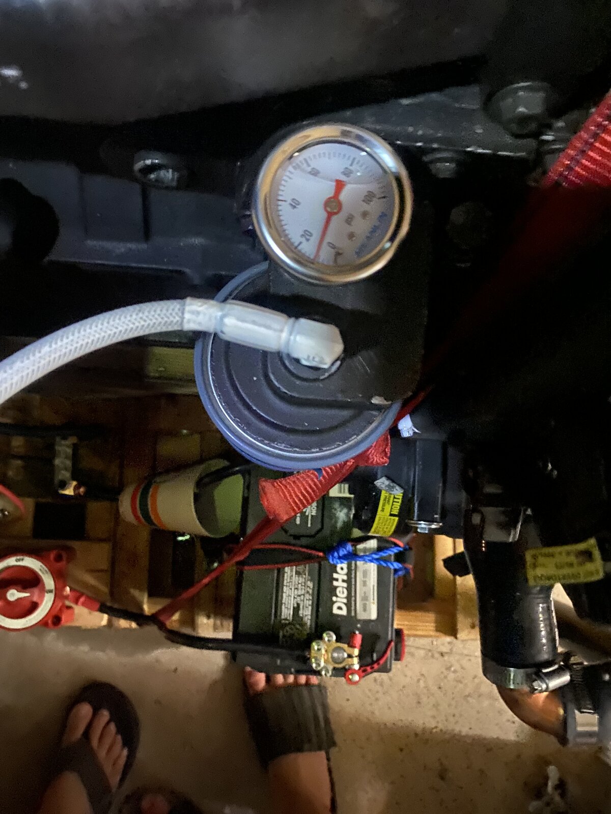

Second, get another gauge for this low level measure.
Your Amazon gauge isn't really precise at such low pressures, I know because I used the same.
Don't rip your engine apart without verifying the gauges reading.

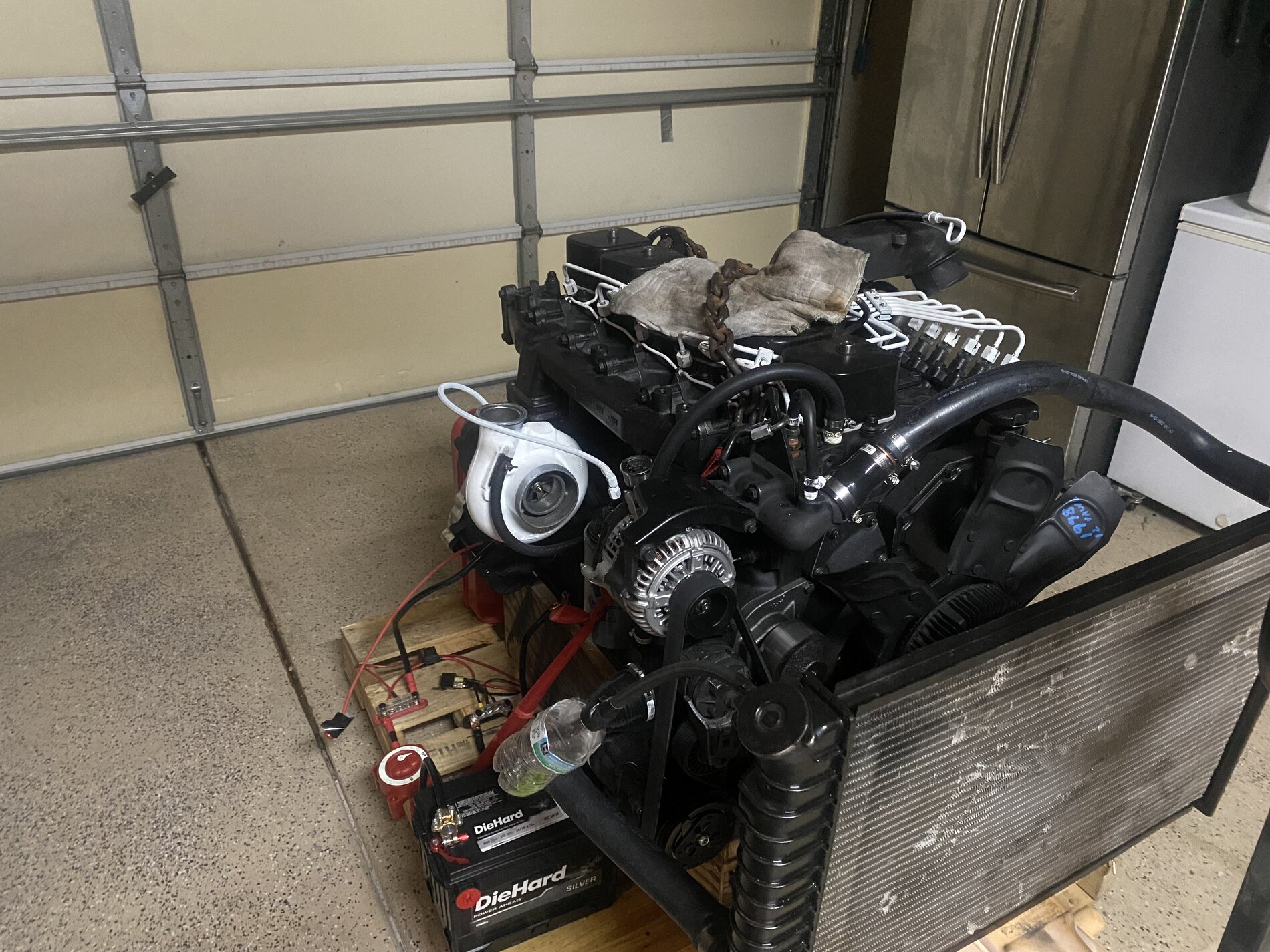

Still, no, it's not normal. You said you were running it on a stand. Do you have the intake running through the CAC into the intake? I don't see any CAC tubing from the turbo in your pic. Is the the crankcase vent operational? Is the vacuum pump hooked up and functioning properly?
Thx for all the help! BigPapa is correct. The engine is getting swapped into a 4x4 ford van bc the 6.0 died. It’s on a stand I made to test before install. The oil is blowing out the exhaust side of the Hx35w only, side to side movement is minimal, no end play. The turbo is not feeding anything as this engine is on a pallet stand with a radiator straped to it. No CAC tubing and no exhaust piping fabbed yet. The CCV tube on the tappet cover is clear of obstructions. The turbo drain tube has some S curves on the way to the block drain hole but I routed it so as to not back up. Maybe it’s still too curvey. Vac Pump / Power Steering pump is installed but w/o the lines. It has its own oil feed though. The vac pump does produce suction. My diagnostic plan for the low warm idle oil pressure: replace filter housing and bypass, inspect housing gaskets. Retest. If it is still low—replace oil pump. Retest. If it is still low, rebuild again… With specific attention to main and cam bearing clearances (was good but I dunno maybe I misread the plastigauge). Regarding the turbo issue: straighten the drain tubing. Restest. If still leaking out the back, remove turbo and exhaust manifold and check for wetness at head ports. Go from there…Ozy— I used 2 diff brands of manual gauges and both showed 6ish PSI hot idle.

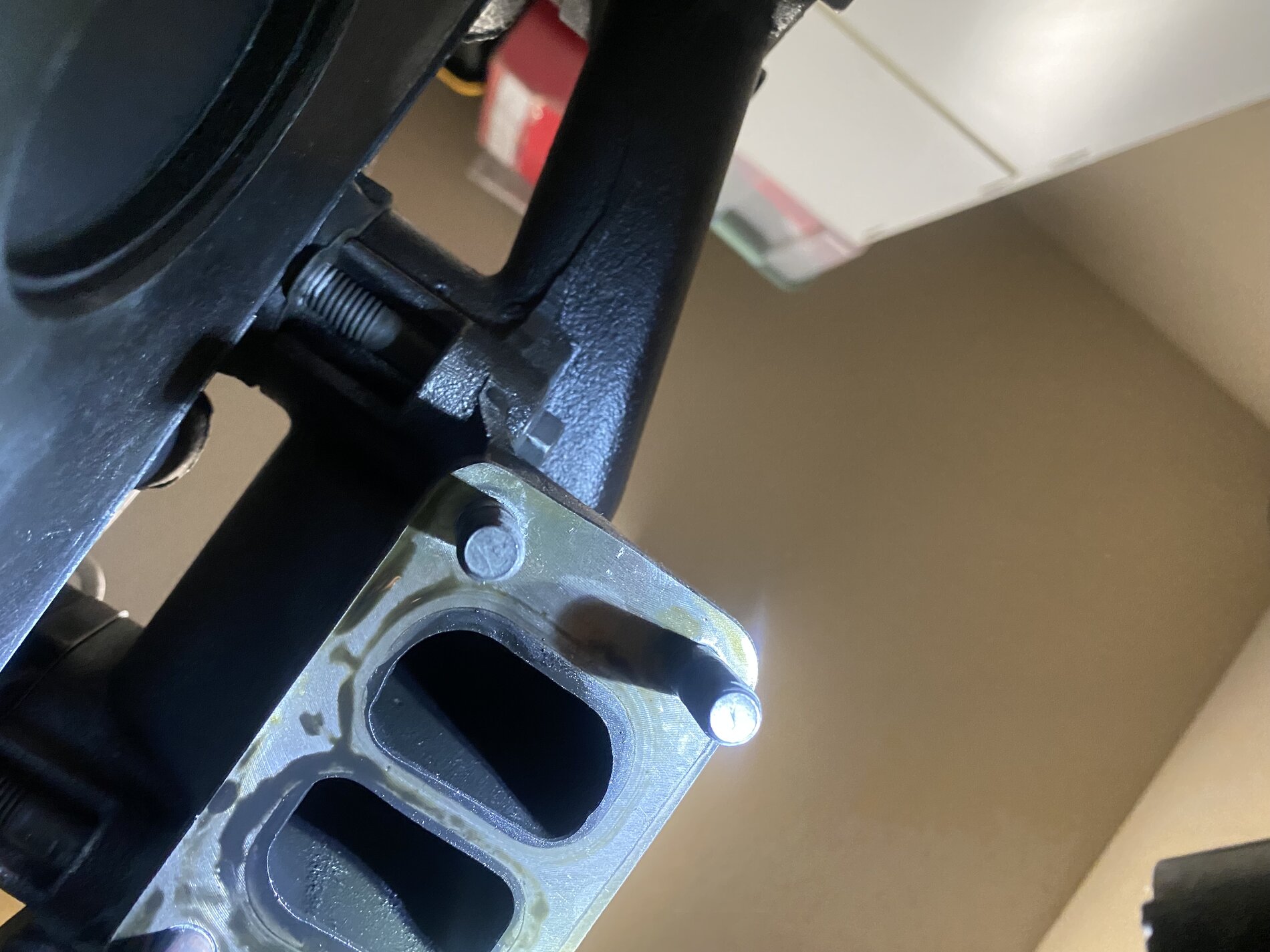

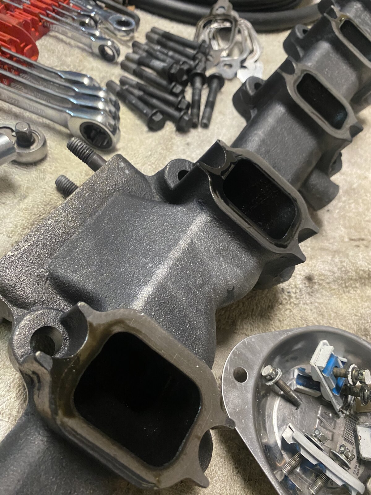

Yeah I might do that too Mikey. Last night I removed the turbo and manifold and found wetness in ALL 6 of the exhaust ports—so it’s not likely the turbo. It’s either oil or diesel coming from each of the combustion chambers OR oil leak down from the new McBee valve seats. I’m going to swap a new set of MAHLE ones in and see if that fixes it. Hopefully I don’t have to buy new valves. For the hot idle oil pressure is I am also getting a 0-20 psi pressure gauge to definitively see what hot idle pressure is like Ozymandias recommended. I’ll let you guys know what I find when all the parts come in. Interestingly upon inspection of the oil passages and items—everything seems to be getting adequate supply, no fluids are mixing, and it idles clean (no smoke/steam). This motor only has about 30 minutes of total operating time after rebuild. Originally had 80k. Am I missing anything?

In other news today I determined it IS oil (not diesel) and it’s most likely coming from all 6 combustion chambers as all the head exhaust ports are wet with oil. I bought a few new (non-Amazon 10$) gauges and the hot idle oil pressure is 9-12 psi depending on which gauge you believe. Everything is getting lubed properly and no fluids are mixing. So I don’t think oil pressure is an issue. Now I’m concerned about the spackling of oil blowing out of the exhaust. Maybe the rings have not seated yet? On install I oriented all of the rings properly. My next step is to build a manometer per the manual and test the blow by to see if it’s w/i limits. I can’t simulate a load like the manual calls for though. No dyno. I’ll just have to do it by rpm.
