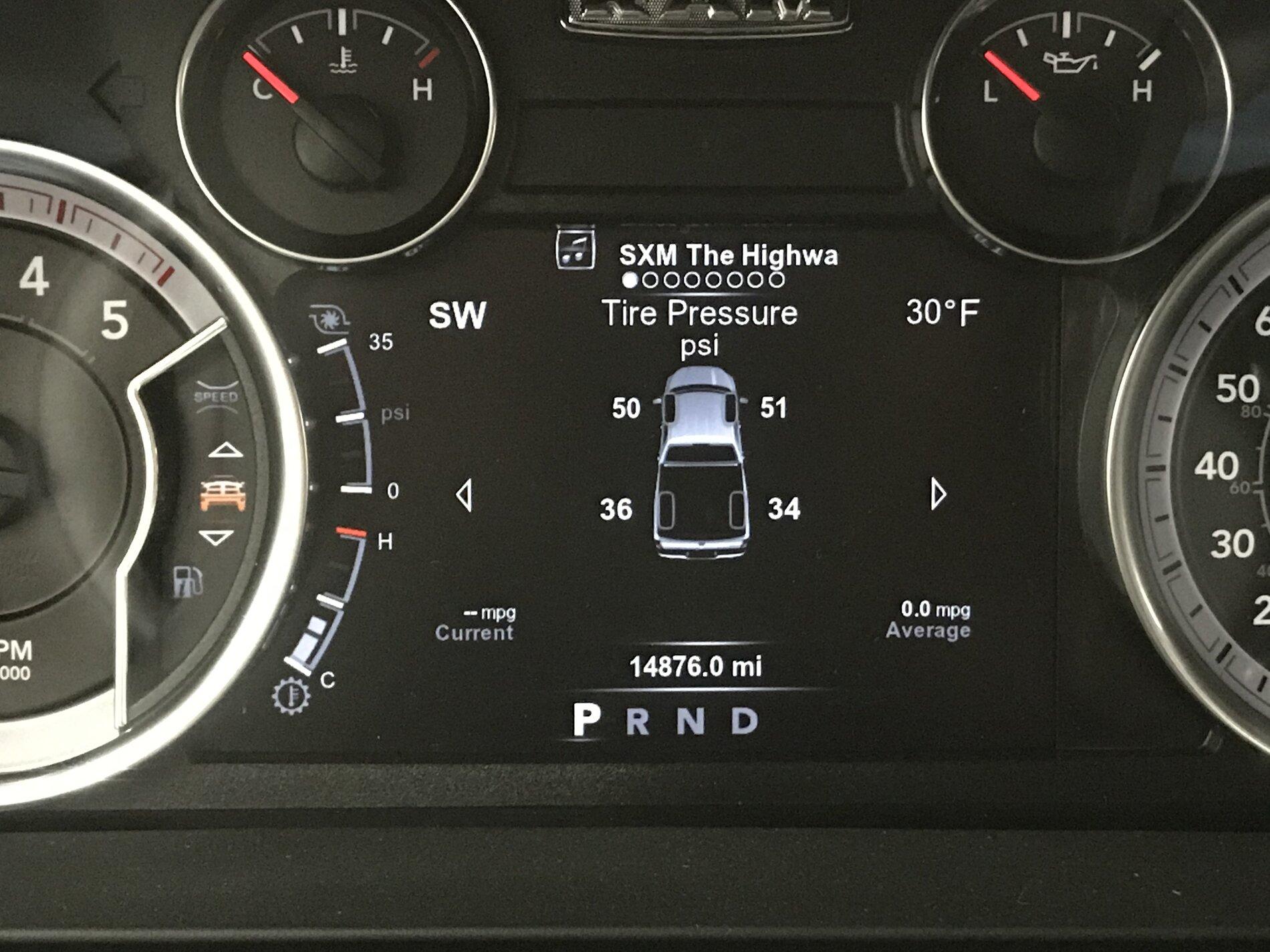

All deflated for winter.
I run lower when at elk camp, but I don’t get above 25 for 10 days... and this year had 4 chains on for a week. Tire pressure makes a HUGE difference in traction.
