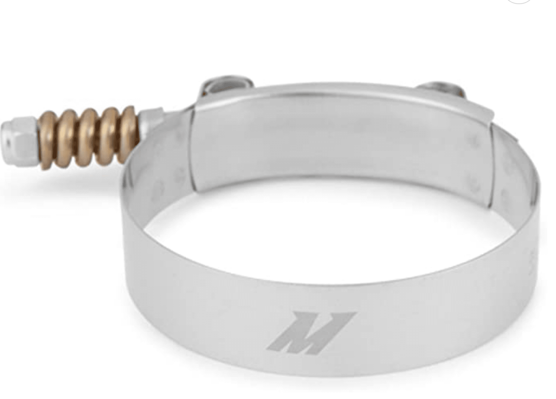

Oh no...I have been using this kind, which is what Bob's Silicone sent to me with the hoses that I bought from him.
Actually, that clamp is okay. It has spring tension for constant torque and the worm drive slots are designed to not cut into the hose. It is also for a specific size - not a one-size-fits-a-large-range clamp.

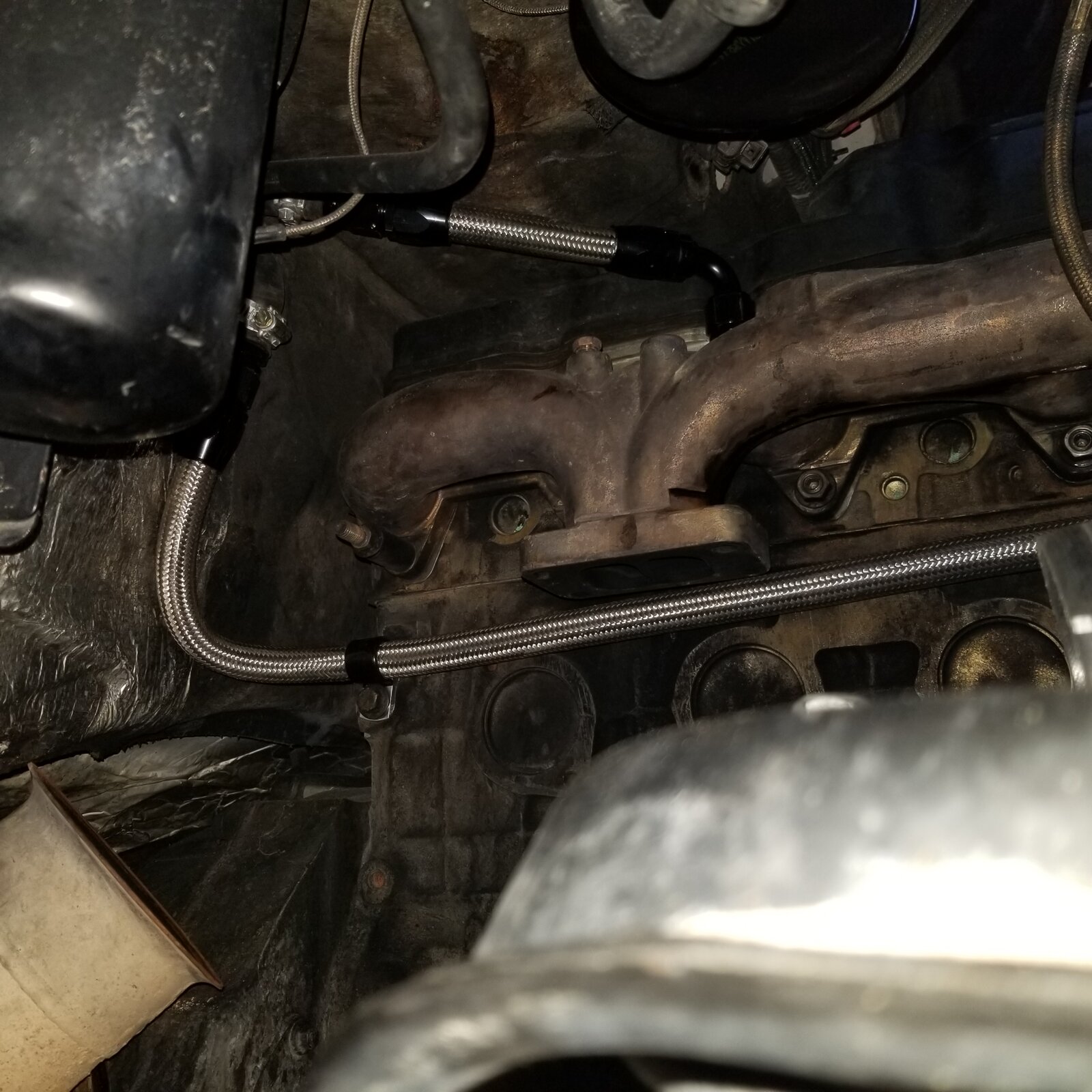

What about putting in a NPT - JIC fitting than a line with ends to match? Could even be a solid line with swivel ends. Don't have a horse in this race but was trying to think of another option that may work since this hose sounds like a royal pain! Hope the suggestion sparks gets the gears turning!
Dam that's gorgeous and ;looks like it readily solves the problem!!!

I DO like the idea of replacing the hard coolant line and soft hoses with the Full Send braided JIC/swivel fittings kit, though that IS a hefty price.
Couple of questions for ya--
Was it hard to install without removing the exhaust manifold ??
How long have you had it on the truck?

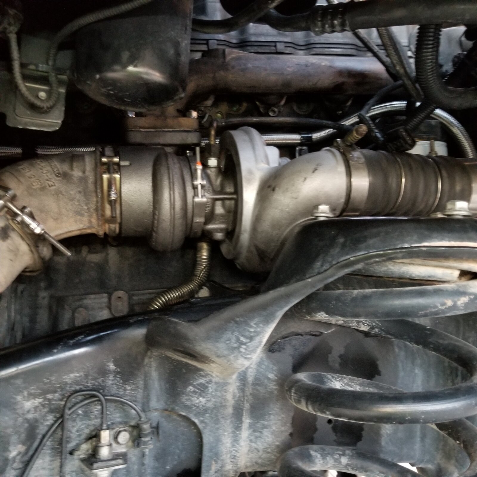

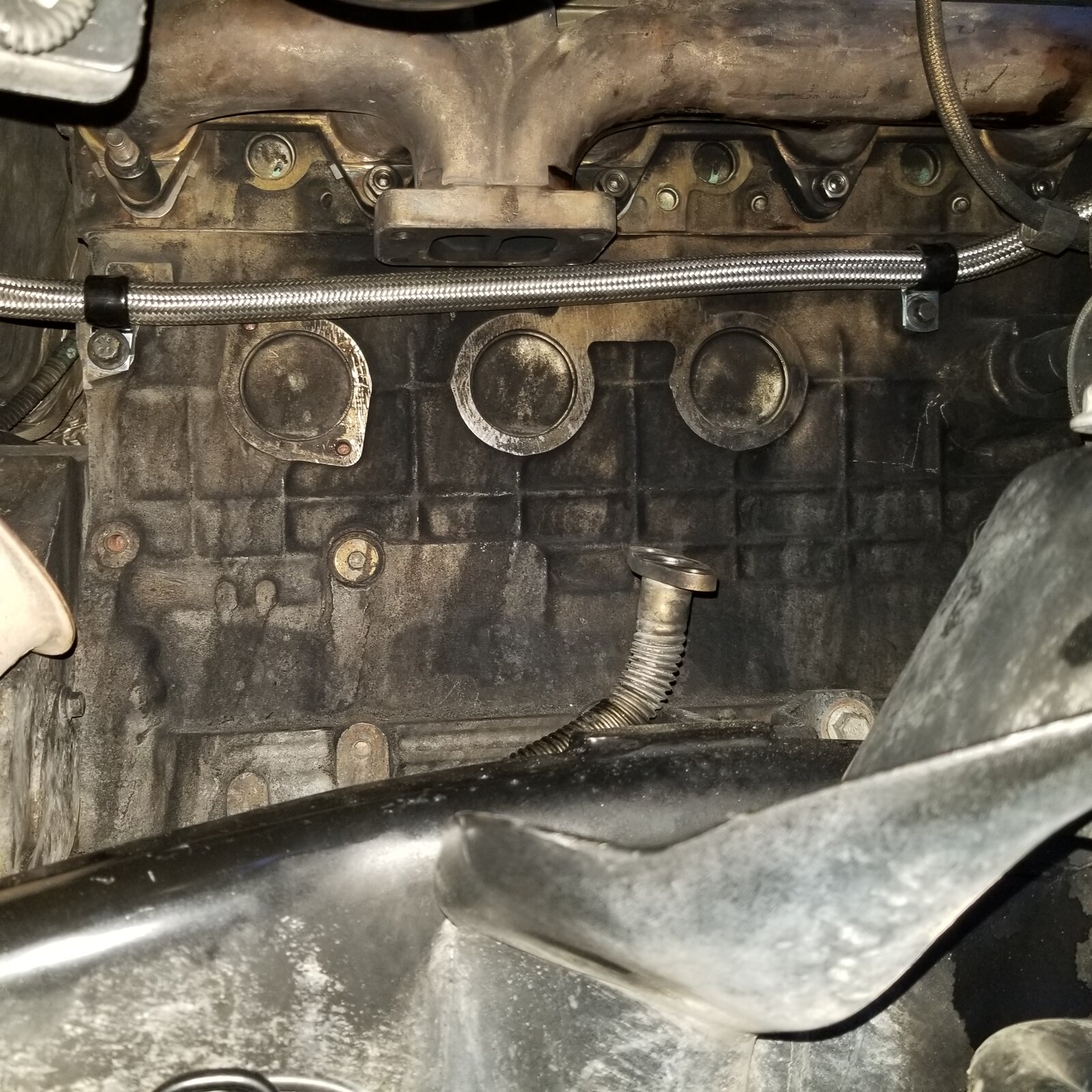

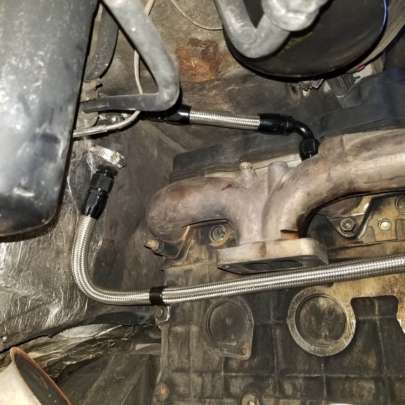

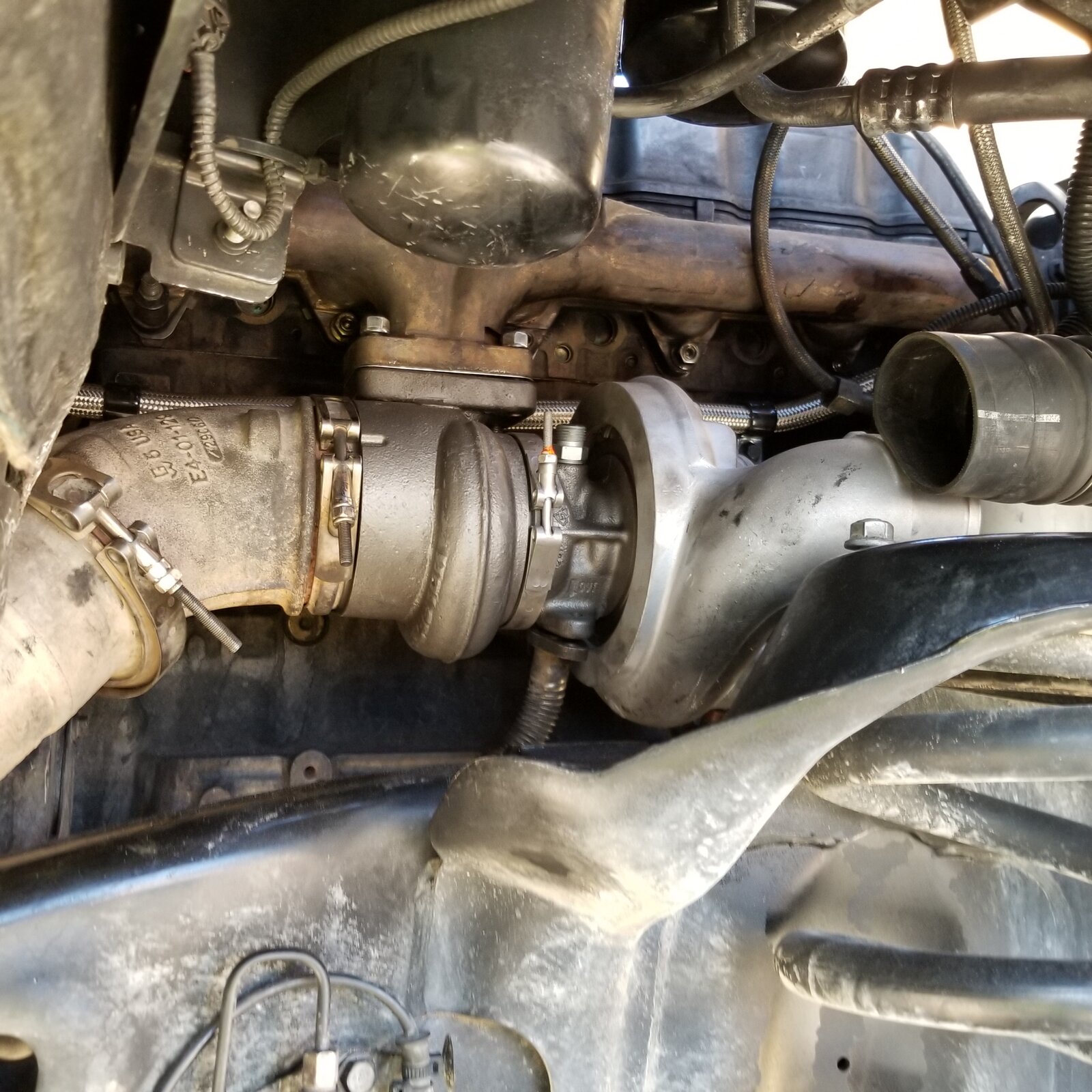

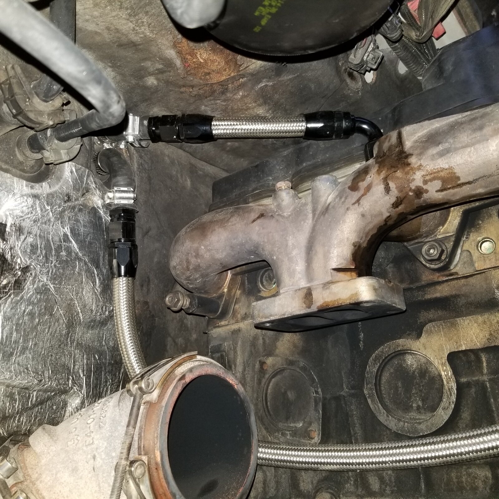

Unfortunately we installed it when we had the turbo off before I lost the motor and the second time installed it was when the motor was out of the truck. Below are some photos that may help you decide. I believe I first installed it in 2019 and have had no issues since.

Ozy I generally agree with you but in my case I had multiple leak events and repairs and eventually decided to just replace it with the Full Send kit for piece of mind. I do a lot of off roading in remote country and did not want to have to attempt a repair in the field. As to why is was leaking I don't know but figured given its proximity to the exhaust manifold it was under going constant heat and cooling cycles that degraded the short rubber hose.
