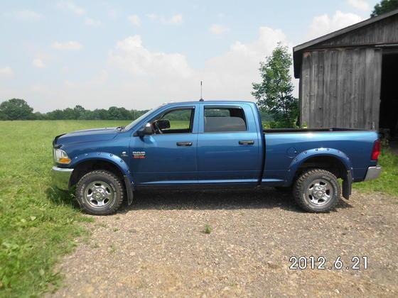

I'm first time diesel owner with a 4th gen cummins ram 3500 getting mid 14's mpg with 16,500mi dealer said it will improve with more miles but, I want to know if this is BS or what you guys are doing to improve your mpgs thanks!
