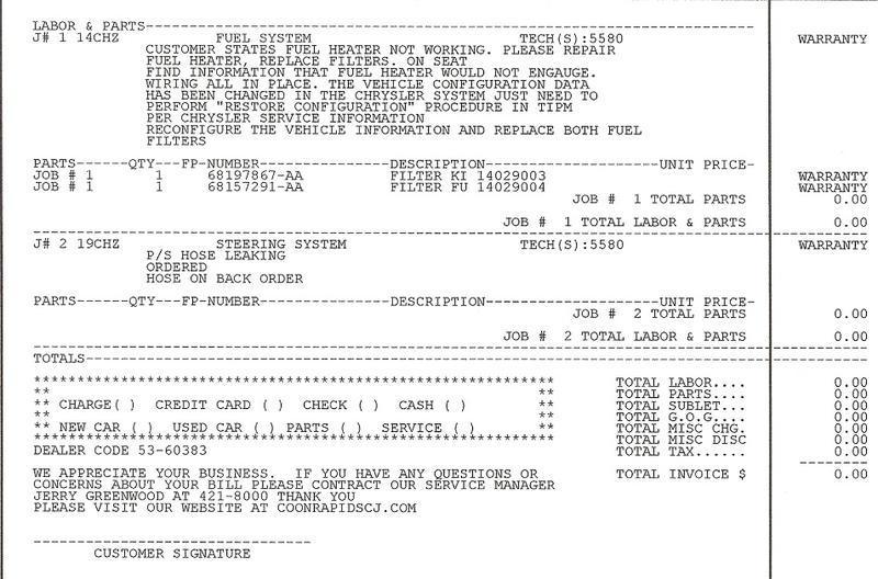

I know, The rep came right out and declare it was non-functional and we checked.. The tech manually engage the element and 0 volts, after the flash/Program it was working (Both)
Check out work order.

Looks like problem identified yesterday. Have your dealer perform this Star Online case.
STAR Case
This document does not authorize warranty repairs. This communication documents a record of past experiences. STAR Center
Online does not provide any conclusions about what is wrong with the vehicle. Rather, it captures all previous cases known that appear
to be similar or related to the vehicle symptom / condition. You are the expert, and you are responsible for deciding on the appropriate
course of action.
Chrysler Group LLC Contact the STAR Center for assistance if no solution is found Version 5/23/13
Case Number: S1314000010
Release Date: 12/13/2013
Symptom/Vehicle Issue:
2013 - 2014 Ram Trucks equipped with the 6.7 L Cummins Turbo diesel engines with fuel related
faults and/or hard, no start or start/stall condition due to fuel gelling in cold ambient temperatures.
Discussion:
Ram Trucks equipped with a 6.7L Cummins Turbo Diesel exhibiting the above concerns have a
condition that will cause the chassis mounted fuel filter heater not to function. The condition is due to
a configuration setting in the Body Control Module (BCM) that does feed power to the fuel heater
relay for the chassis mounted fuel filter only. The engine mounted filter fuel heater is operating
properly.
Vehicles that exhibit the issue as described in the Symptom/Vehicle Issue described above;
generate and print a Configuration Report and then perform a vehicle reconfiguration to resolve the
issue. Perform a reconfiguration as follows;
 Generate and print a Configuration Report
 From Vehicle View (Topology) screen, select BCM
 Select Misc. Functions
 Select Vehicle Reconfiguration
Validate proper heater operation by testing for battery voltage at the heater connections with the
ignition switch is in the Run position.

Just had my '14 3500 into the dealer today. I was going to ask about the frame mount filter heater not working, but they mentioned it first. They checked, and had to turn it "on".
They said RAM is telling them all the 13 and '14 trucks, up until just recently built, all have the same issue. The rear filter heater is not turned "on" at the factory, and need to be reconfigured to get it on. It is a software issue, no mechanical problem.
