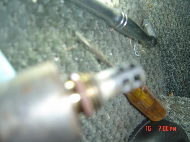

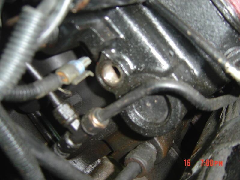

Vaughn, Thanks for the picture. Will look for it tomorrow and might spray some lubricant on it just in case it is rusted in place. Do not want to snap it off and then will have a bigger problem to deal with. From the picture and what can remember of the engine layout, a mirror would be a great help also. It has got to be right near the firewall also so not a lot of room to work in but will manage as best as can. Have a good set of deep sockets to get over the sensor also. Might make sure that use 6 pt vs. 12 pt so do not round it off. If can get a wrench in there will do that instead but leverage might work better with a ratchet. Do not have an exhaust brake, just about 133K miles of travel.
IAT sensor has a rubble seal, so spraying anything will do no good as the seal protects the threads from outside issues. You need a spark plug socket without the rubber insert, an extention about 6" long and a 3/8" racket. Go around behind the transmission kickdown cable. Got to do it by feel. Been sure to lift tab when unplugging the cable. Helps to be tall with long arms and I still had to stand on a milk crate.
