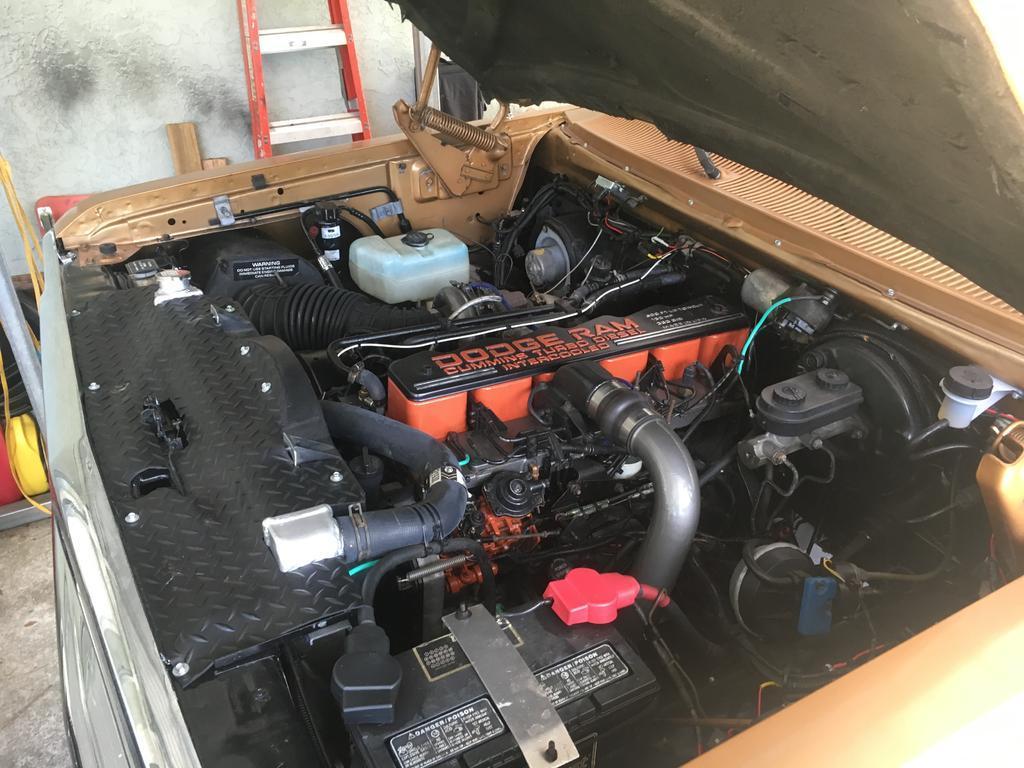

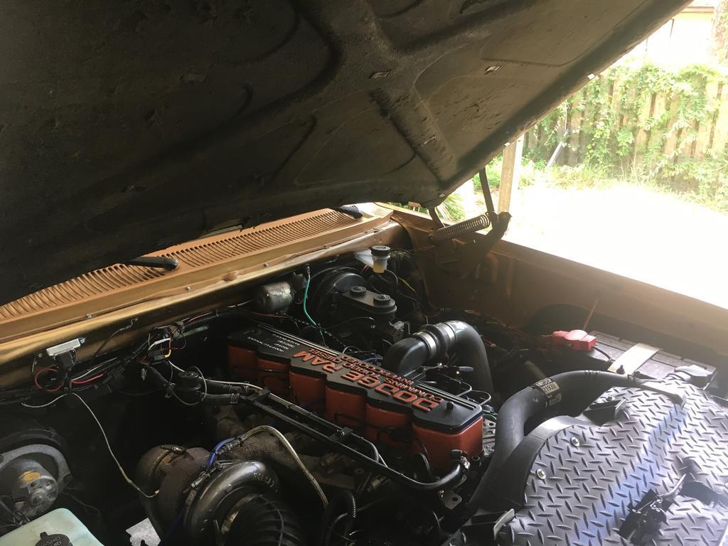

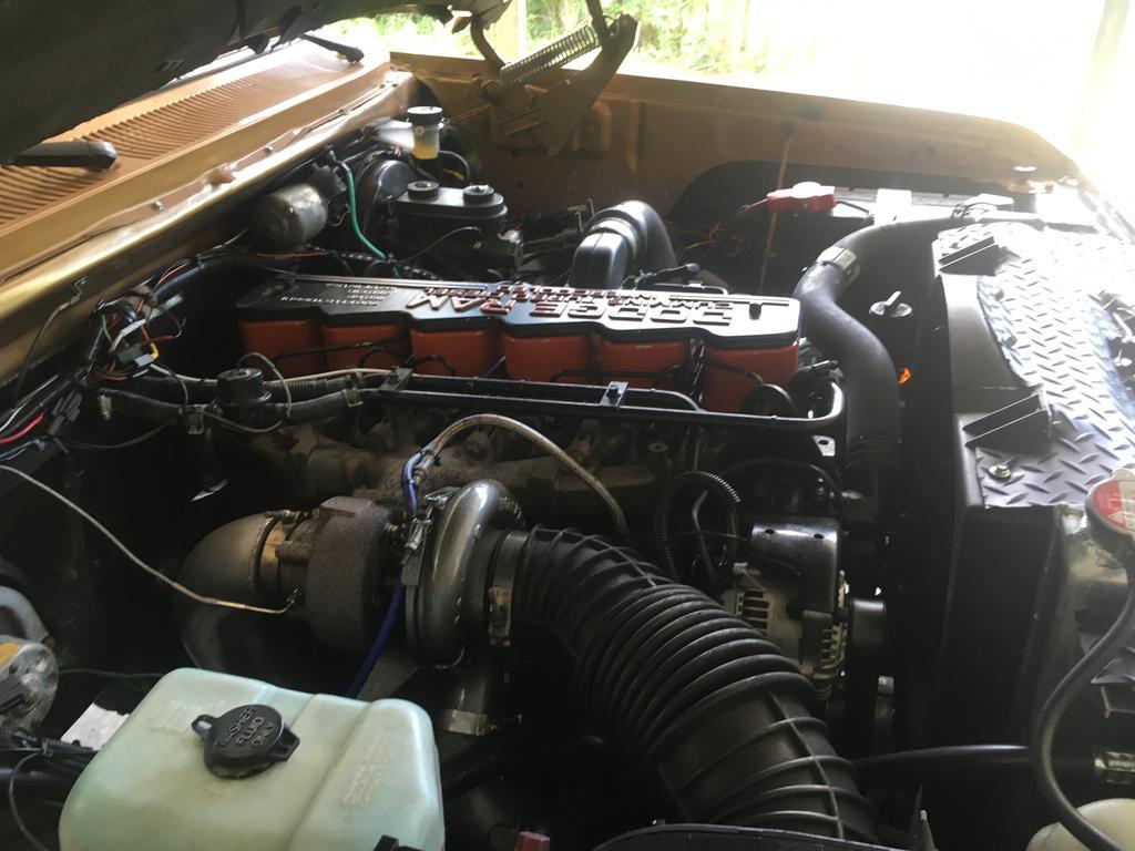

:cool:Here is a few under hood shots. What really makes this a cool build is everything fits without re engineering it due to the cab and front clip being the same as the 250/350 trucks from the Gen 1 trucks. Dodge should have sold these from the factory.
