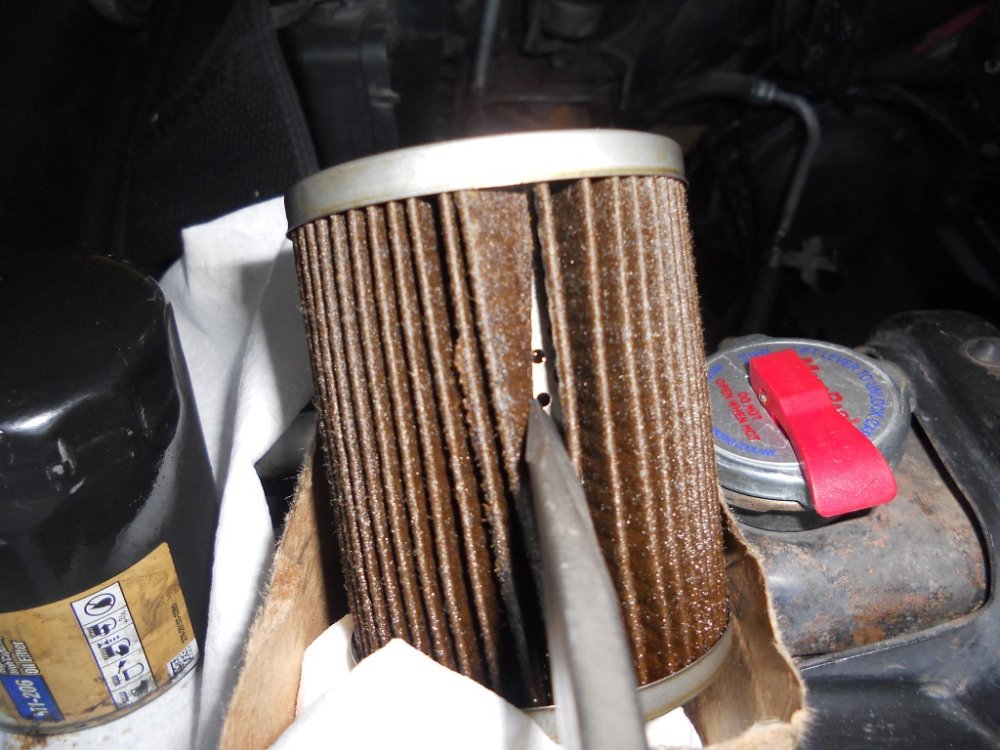

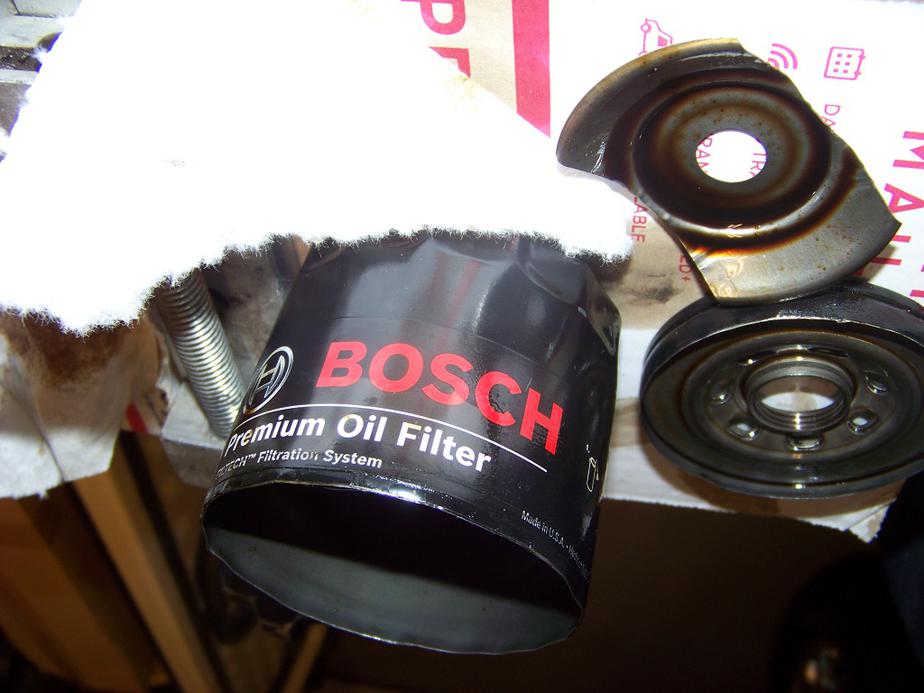

If the only filter I could get was a Puralator - I'd put the old filter back on because the odds are better it will keep filtering rather than tearing a pleat after say 3000 miles. Not just filters from them of mine disguised with another brand Bosch I cut open, but, Tear-O-Later is a known RASH all over the internet.
Last I checked Bosch is now a painted can made by the conglomerate formally known as FRAM. This was a Puralator made one years ago. No, Tear-O-Later haven't corrected the pleat tearing problem.

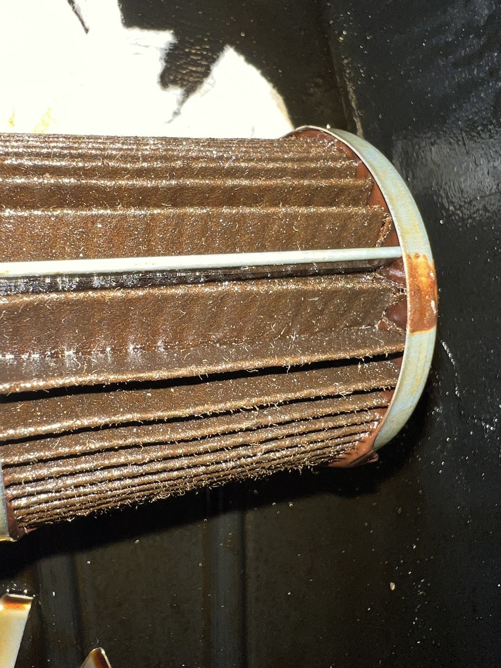

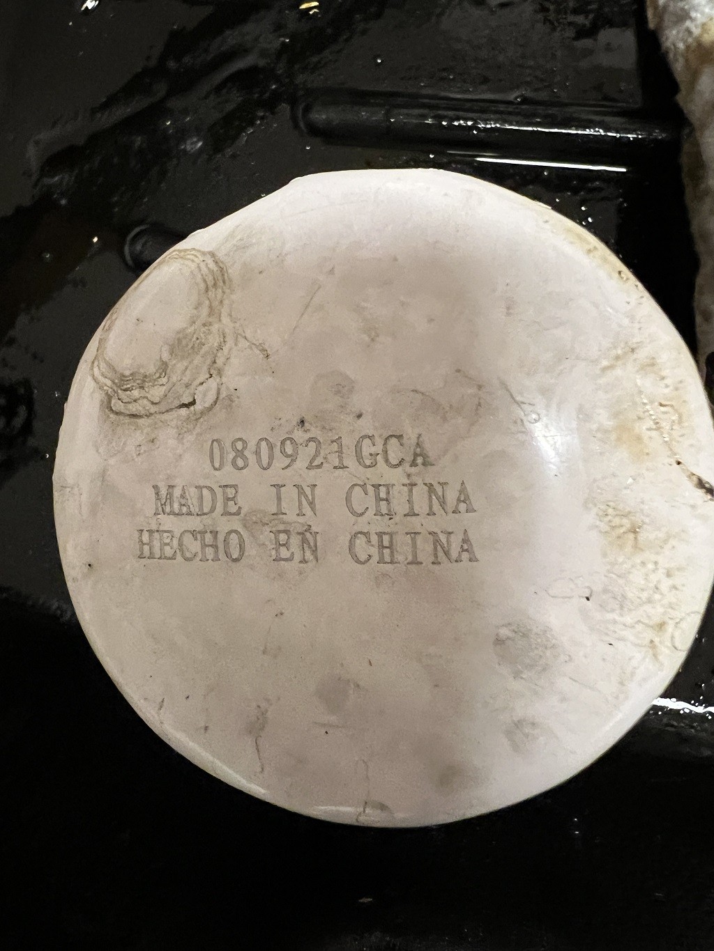

You can get the same T-shirt stuffed in a can Zero filtering performance, media failure, from a far cheaper FVP from China.
FRAM didn't care when a can painted with Mobil 1 was defective. They informed me cutting it open was a way they wanted to take out of any liability... FRAM didn't care once second they may have had a bad batch! Oh yeah Mobil 1 referred me to their supplier for any claims or defect concerns.
Bottom of the FVP can due to 4 photo limit post above.

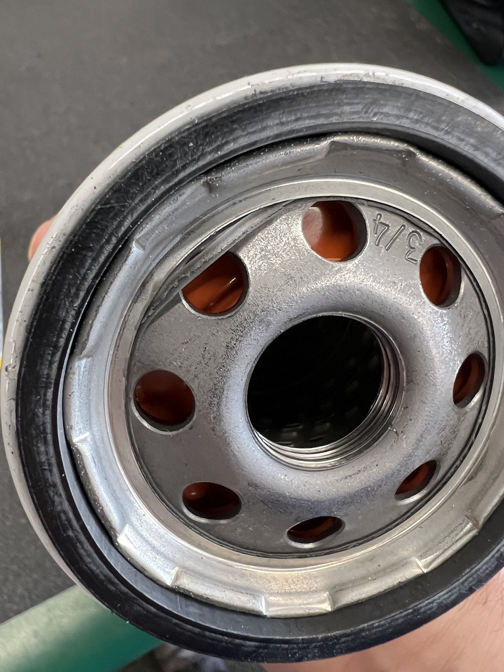

Speaking of putting an "old filter back on": Here is a defective out of the box Wix for a Cummins/Onan generator oil change. Sure I could Mail order from Shop.Cummins, but, they have a bad habit of sending me "shelf life expired" 8 year old fuel filters for a vintage generator that they have to refund me.
What is wrong with this Wix?! Aside of it got returned as defective... The Anti drain back valve is also off.

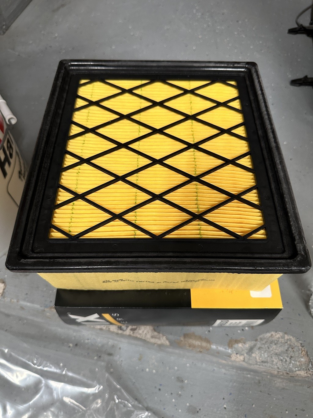

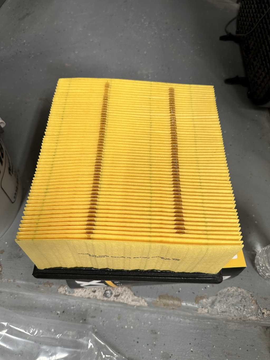

The New WIX Air filter for 2018 RAM Cummins looks like this. Bigger holes for chunks to get through when mice make a nest in the air box from the air filter, etc.
VS. What they used to look like.
Just using Napa's web site for a picture of the 6930 air filter, it still shows up as a Wix. That may change if the web site is outdated. Looks like your "good" one.

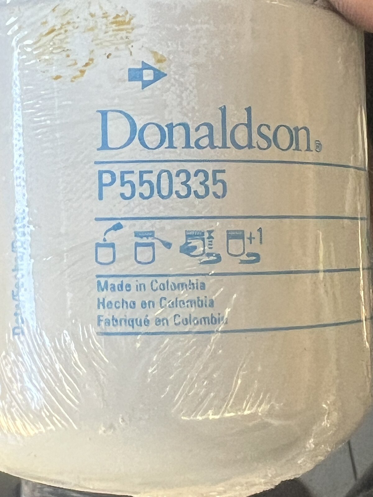

The above isn't an all inclusive list of filter fails I have had leaving off a few like say the OEM Fail, Donaldson, now revised for the Duramax...
Now they have a stop in them for media failure situations.

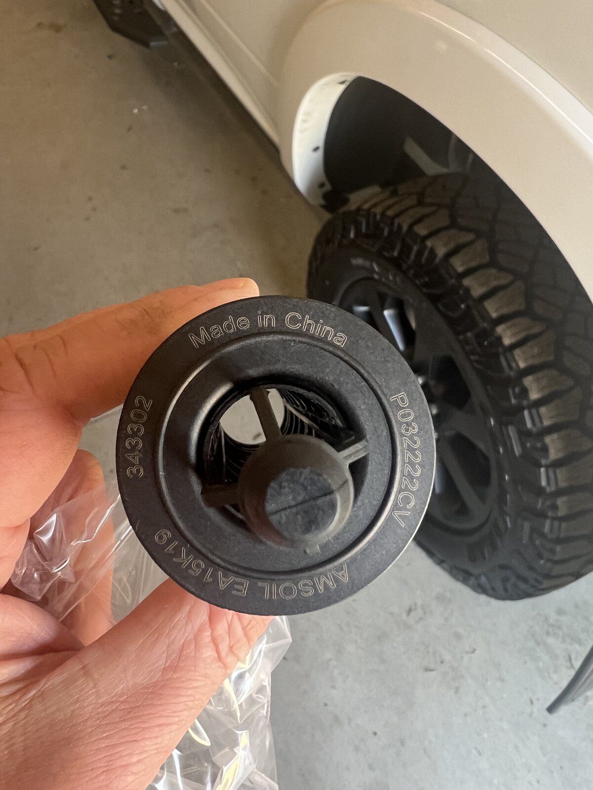

Im thinking the drop in filters are the ones AMZ/OIL is having made in China.

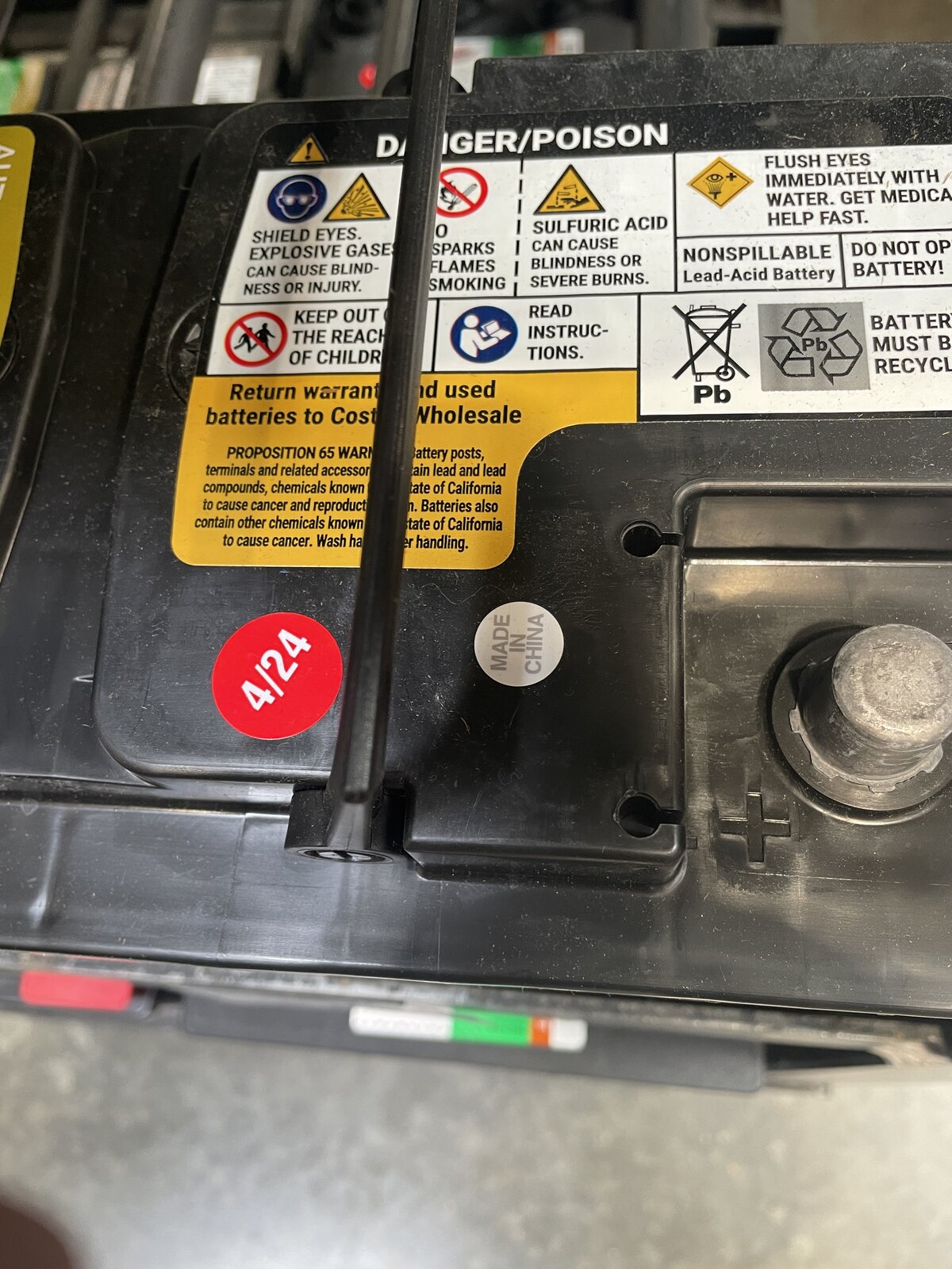

Speaking of CHINA!!!!! Picked up a set of Interstates for my dads truck my son is buying and accidentally grabbed an AGM equivalent. Looks like Interstate now has batteries made in CHINA.
