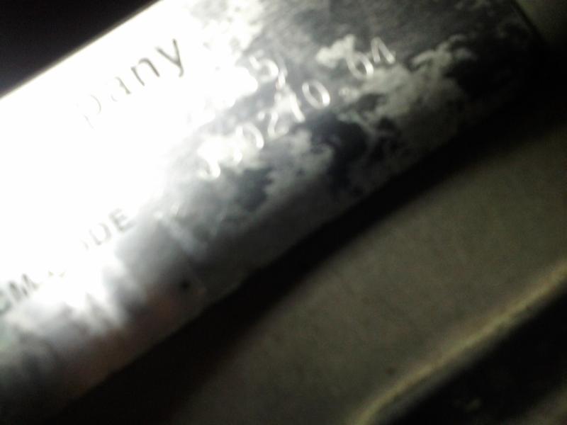

Can you post the information from the ECM data plate... or maybe post a picture of the data plate?

This is the best I could get. Can't get 2nd digit, wife thinks it a nine from curl at bottom.
Sorry that it took so long, busy, Thanks
Sorry, but what's visible in your photo isn't enough info to go by.

You can use the Part number, and it should run a generic program that will work.... there are two part numbers that I am aware of in 99 and '98. They will not interchange, and an ECM from 2000+ will NOT work correctly, nor will the '98/99 work on the 2000+.... Look at the label again, should be 3942336, maybe with an "RX" on the end if reman'd. The pic you took above is in the right area, but the number I need is to the left and above that number... that number I can read there is the ECM code, or production date and flash date code.... by that code, which should translate to a J90270.04 That tells me it was manufactured somewhere around June of 1999....
