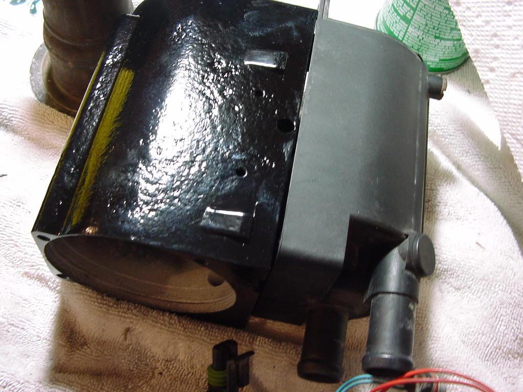

I am rebuilding my D5 Espar and I have been getting the "I'm so busy I cant get to your order" delays on getting parts from http://www.esparofmichigan.com/ . Anyone
know of somewhere else?

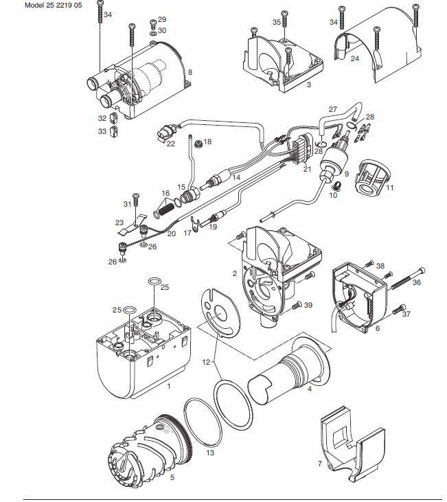

Do you have part numbers??
yep
unit number D5WSC, 25 2219, 64156AE ,50V 12v ,
34 Tapite screw M5 x 35 Torx 109 10 154 6ea
36 Cheese-head screw M5 x 65 Torx 100 10 350 2ea
25 O-Ring 14 x 2.6 22 1000 70 00 06 4ea
26 O-Ring 7 x 2 22 1000 70 00 09 2ea
13 O-Ring 74 x 3 mm 22 1000 70 00 18 1ea
30 O-Ring 5 x 1.5 mm * H , and need drawing #29 screw, part number not shown on list
12 Seal 20 1820 99 00 01 1set
10 Integrated fuel filter 20 1312 00 00 06 1ea
16 Atomizing Screen with O rings 20 1752 99 01 02, 25 2121 99 01 13 1set
I also need and 6ft of exhaust hose, a clamp, and an end, part numbers unknown see attached drawing
Can't find #30 but I do show #29.
Can you post the illustration that you are using??? I may have to print screen the ones within Espar so we can compare.

I had this unit serviced by an outfit in Indiana a few yrs ago for a leak , Thermo king sounds familiar, when I took it apart, I was not happy with what I found.It did not seem to be serviced at all, but its just an observation with any real proof. It had a lot of corrosion that seemed to be much older than the time between the repairs , and a pinched wire from careless reassembly .
BTW I had to take it apart for another coolant leak.
I just this season took mine to the Thermo King dealer in INDY they put in a new igniter & cleaned it up tested it
