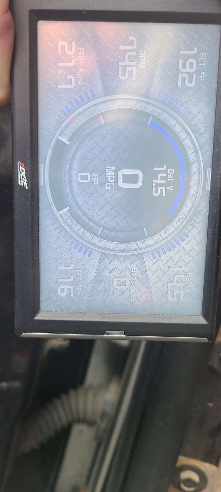

fuel pressure with scanner shows asking for 6900psi and idling its at around 25200psi falls to around 20000 when warm.

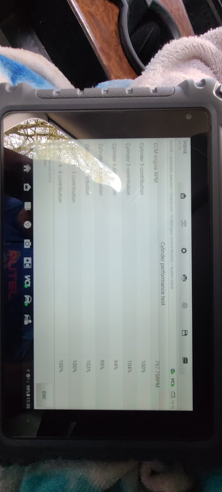

Contribution test .
Do I need injectors?

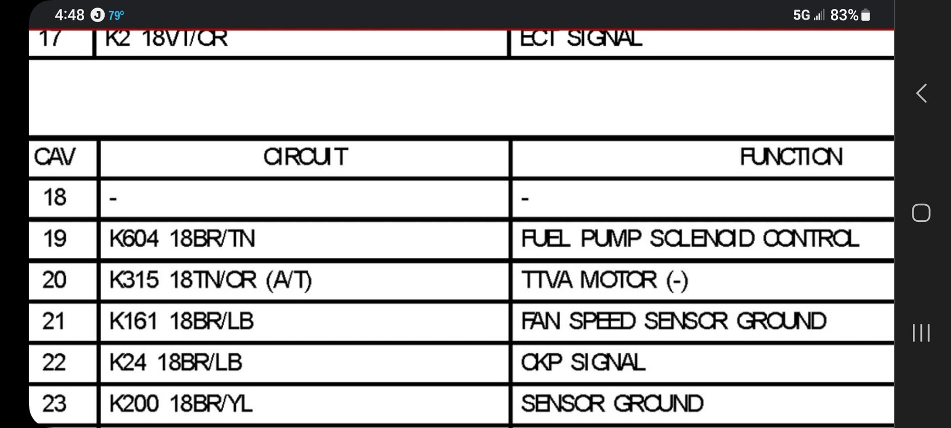

It does not appear to change anything the pressure stays the same plugged in or not. I guess I need to trace wires back. any chance someone knows wich plug on the ecm it is and which wires/pin so I might can use meter to see if there's a break in the wires. that's gotta be it.
on cold start up pressure is around 25200 it drops when engine warms up but the injector supply line is pretty warm .

Definitely measure the connection between FCA and ECM, this is well known to fail and some FCAs are even delivered with a pigtail because of this.
Do not only ohm them out, disconnect on both side and use a test light to give some load to the wire(s).
