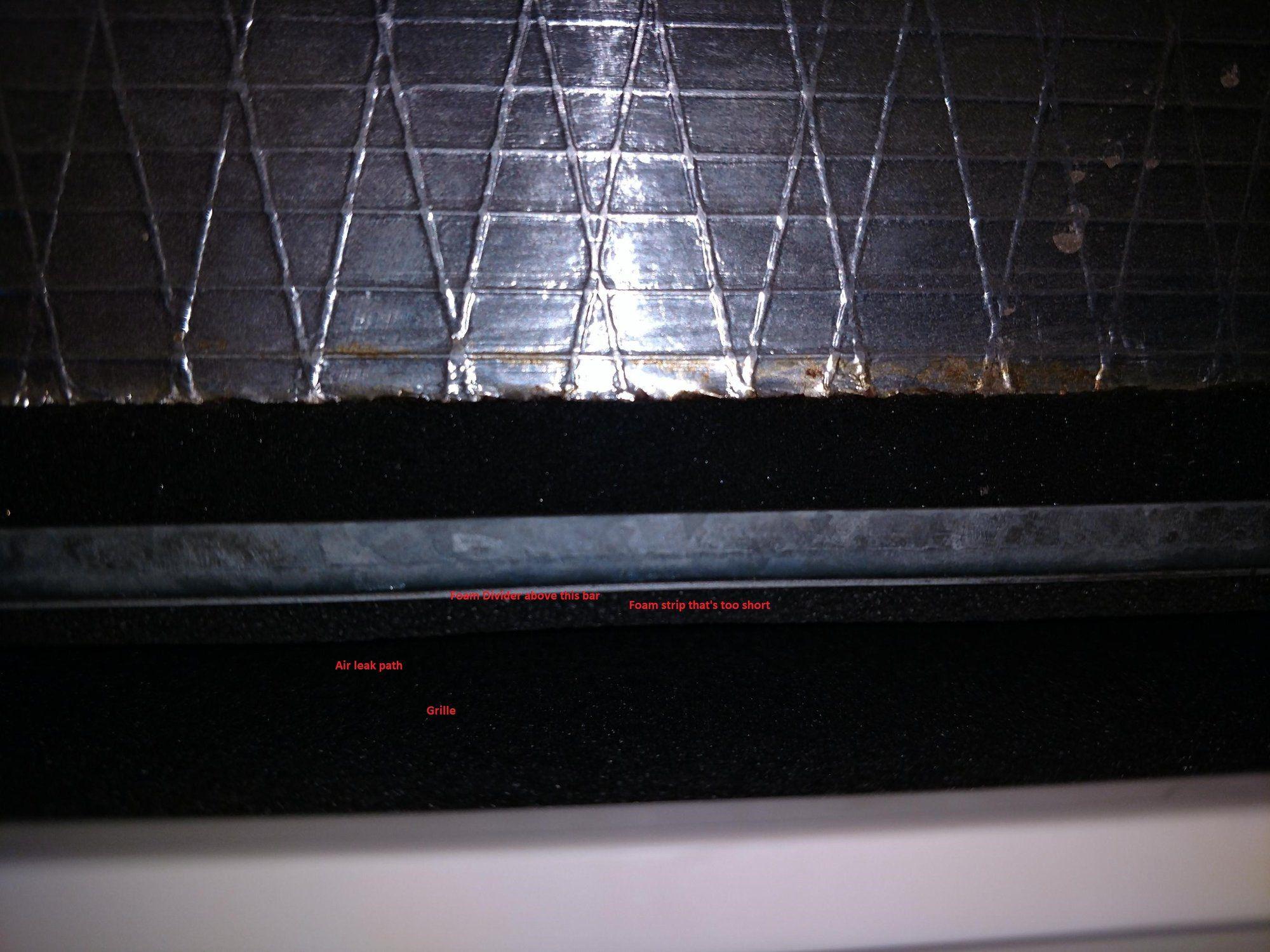

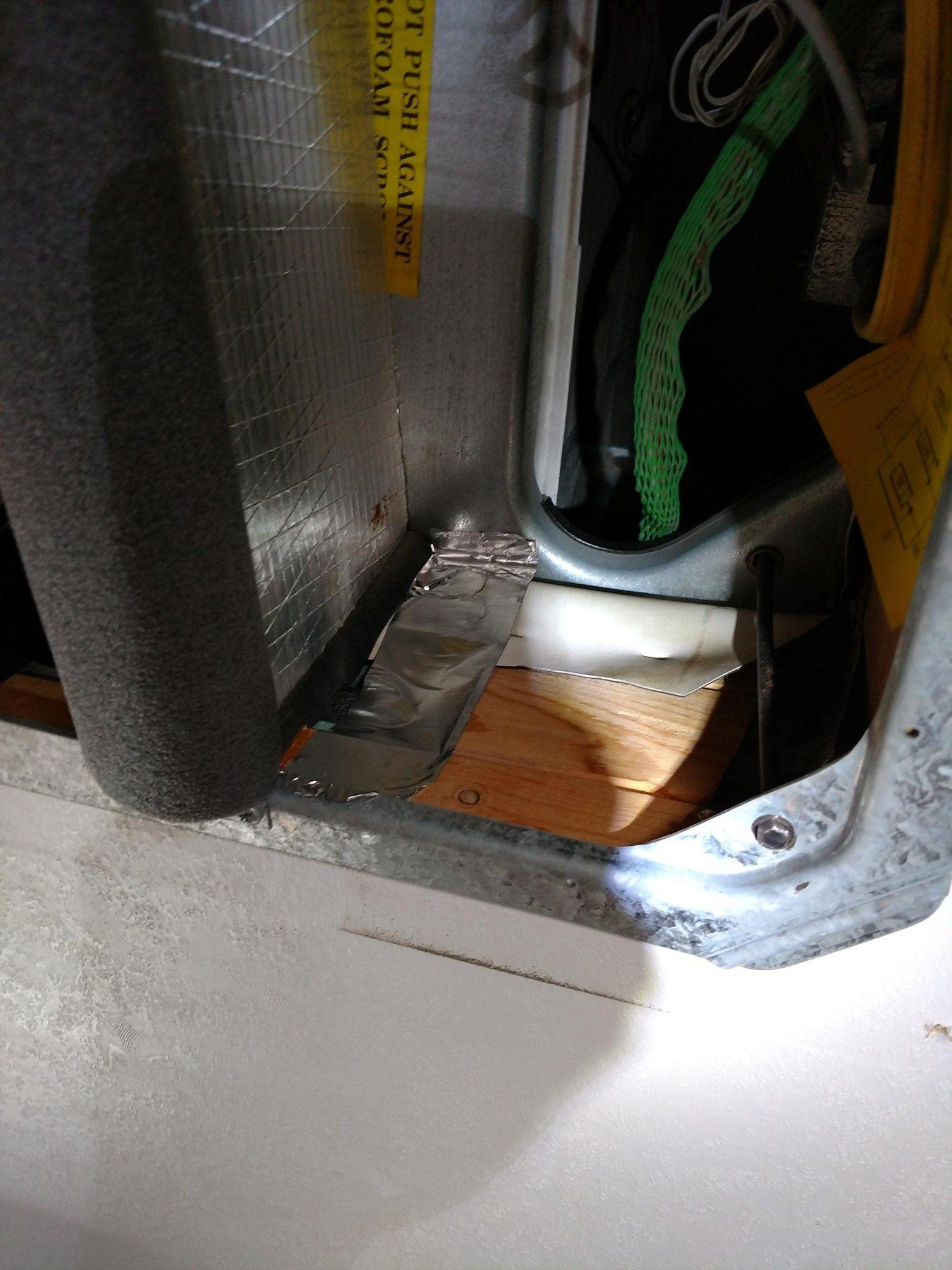

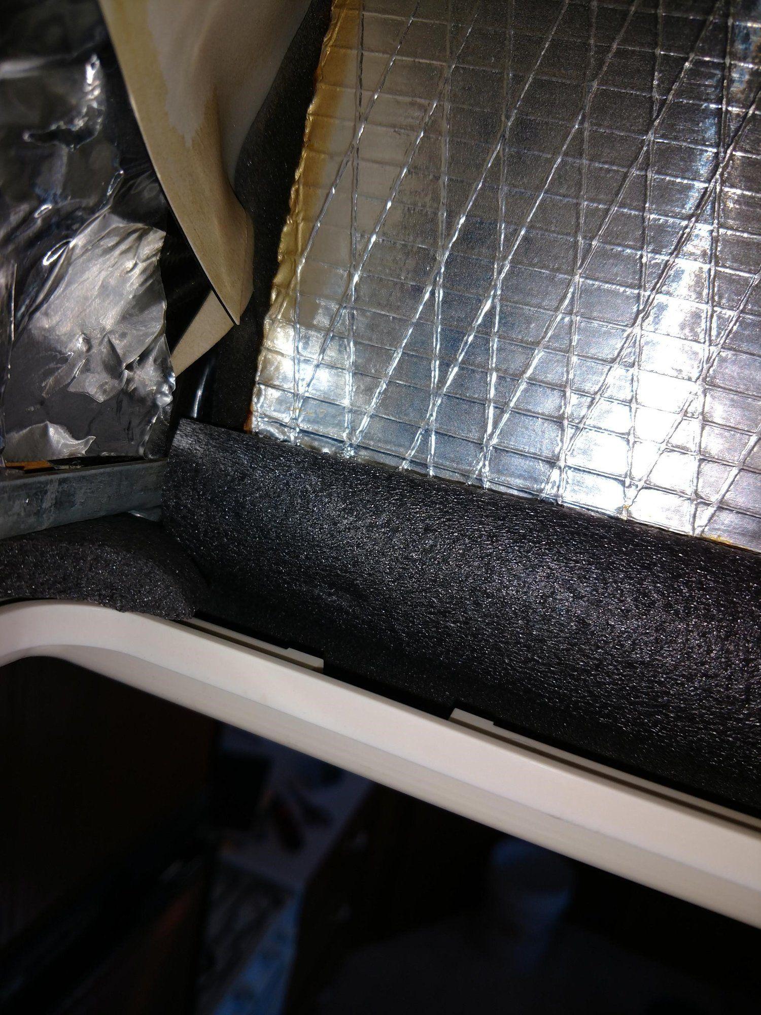

I also added an A/C unit but I found the answer to the crappy divider. It increased the airflow to all my ceiling outlets and increased the efficiency of the unit. It took about 3 hours to install but I suspect different units would take less time. I'm not sure if I would have installed a 2nd AC if I had found these earlier. RV Airflow Systems
I bought one of those, well worth the money. AC noise cut pretty much in half. Much more flow through the vents. I did have to trim a little off of the lip to be able to fit the ac mounting plate back on. We use a small fan to help circulate the air.
