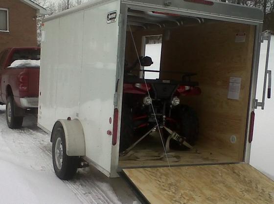

Also, I like the e-tracks in my 2012 18' enclosed trailer. They offer a great deal more options for securing odd cargo than do fixed D-rings. Some of those odd cargo things you can see in this photo ->
#ad
My vote is to eventually install both D-rings and e-tracks :)
