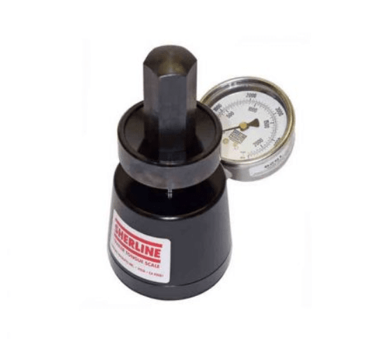

I believe I manage my TW properly, but it’s challenging without regular access to a truck scale. Any recommendations for measuring/better management without truck scale?
A trailer tongue scale is your friend. I use one periodically for setting up initial tongue weight for specific trailer loads.
Also (you didn't mention), but if you are using a weight distribution hitch, you can relieve the tension on the tension bars to place more weight on the truck drive axle while negotiating your steep driveway.
