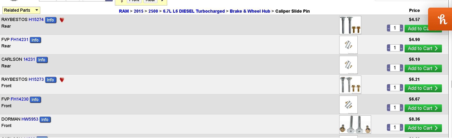

I would like to get some help with part numbers and a source for these items
1] A bolt and a pin(?) that connects the 2 halves of the rear calipers together. has a rubber dustcover on it.
2 sets are needed per rear wheel. Sorry I don't know how else to describe it.
2] Those washer clipy things that hold the disk to the axle while you are putting the wheel back on.
Thank you for your help
OH ... 2015 2500 LongHorn
1. Caliper Slide pin
2. Brake rotor retaining clips, Hard to find but not absolutely necessary. Can anyone else chime in on where to find these?
Clips are not needed and are put on in factory to keep the discs on prior to the caliper.
Once the caliper is on the disc's can go nowhere.
Slide pin and boots are a wear item, I change them annually because they are always gone by then.
Use Sylglide inside the boots helps greatly.
