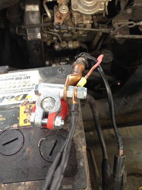

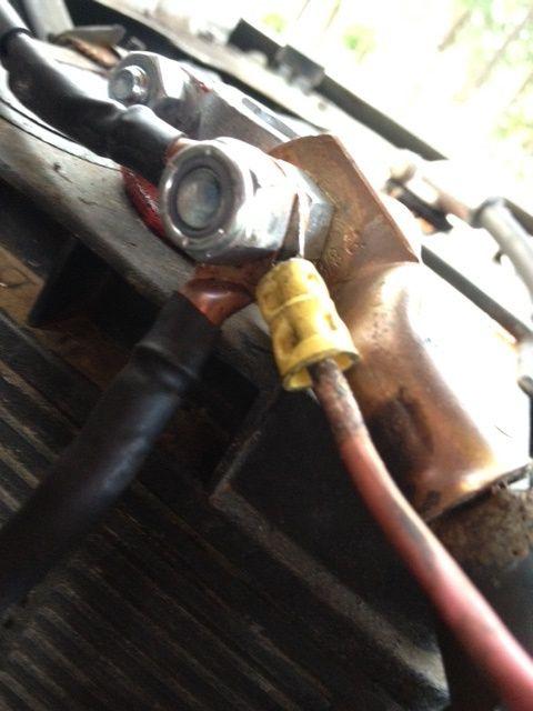

After I got the negative cable replaced a few weeks later the positive terminal cracked. To fix it since a later model positive cable wouldn't work, I purchased a military terminal, a copper crimp terminal for 3/0 cable, used a propane torch and melted the old terminal off. Then soldered the copper terminal on the old cable. I used 4-6 gauge terminals for the other wires. Looks good and should last a long time.
