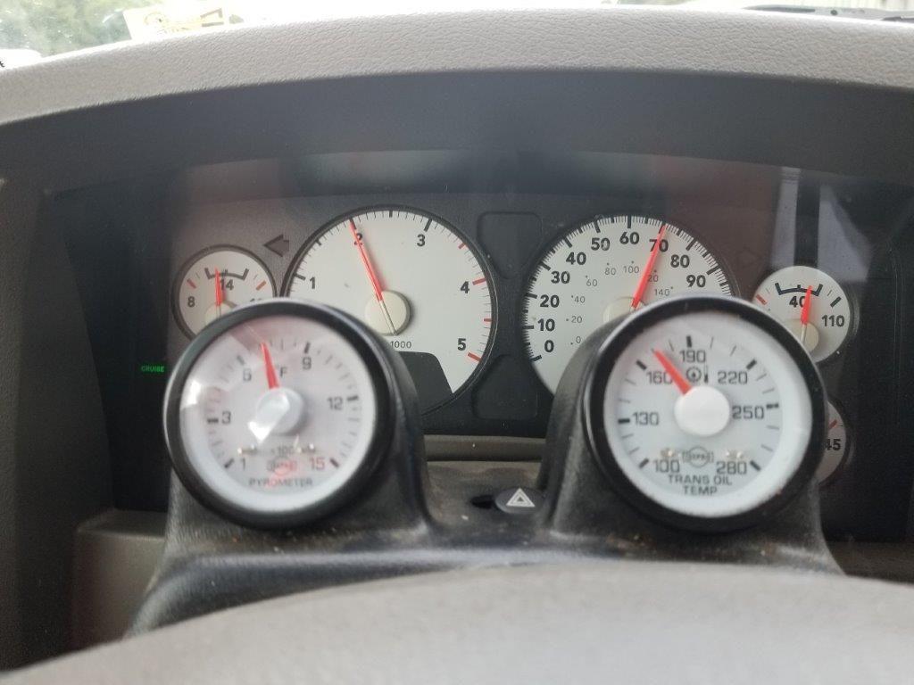

I went back and reread this thread. I made a statement on the post with the overhead pic and I typed "transmission wanted to dnshift from 6th gears. That was incorrect. Spell check must have changed some words. Just the opposite. The transmission did a great job staying in high gear. I am running the Smarty on 90hp, #4 on tq and #4 on timing. Had plenty power.
