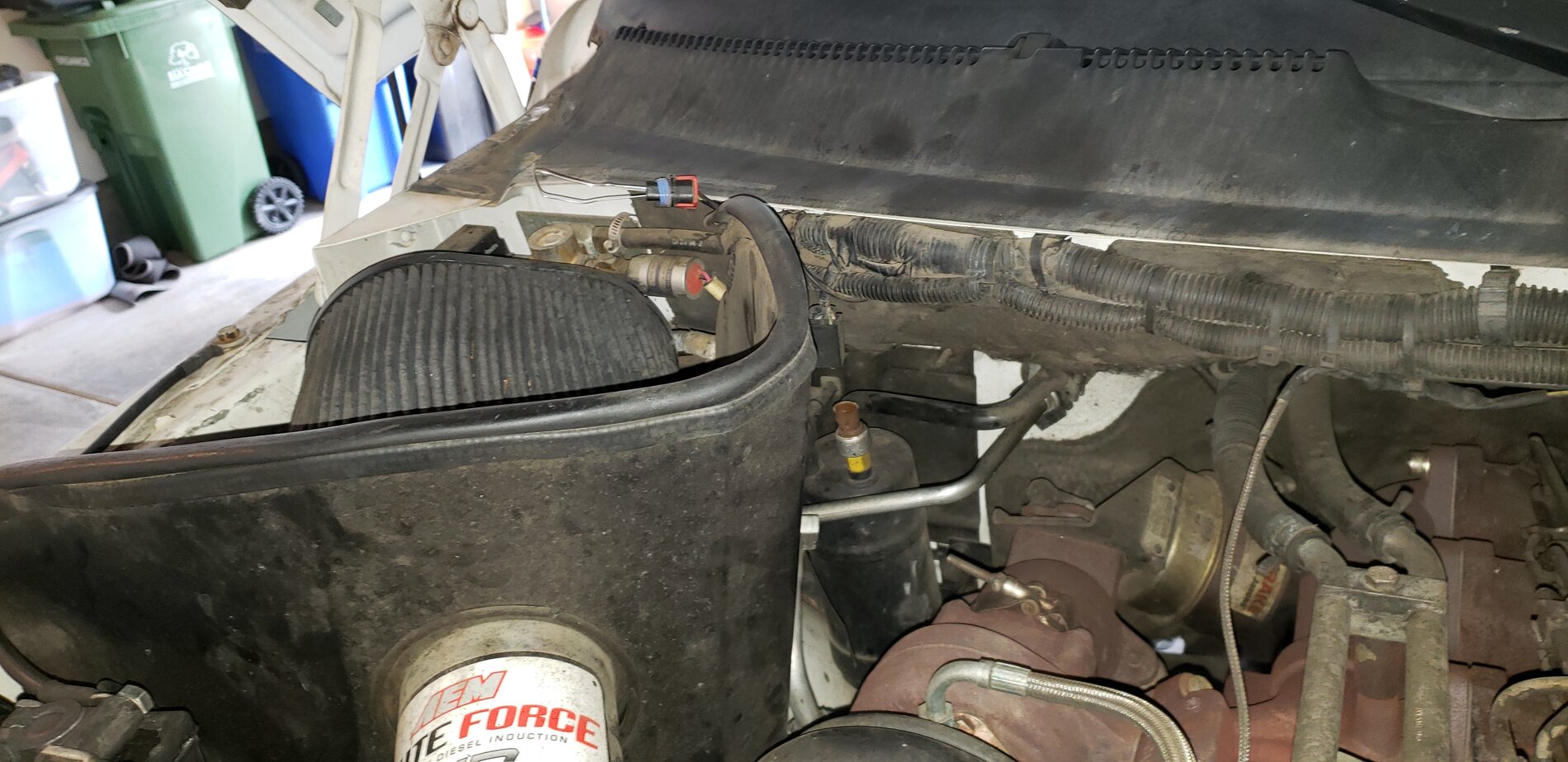

Final mystery solved. The floppy pressure guage was due to the low pressure sensor on the ac stopping the compressor from running. The system was too low on refrigerant. Found a good youtube video on bypassing the switch with a paperclip, and it worked. System took refrigerant and is cold again. The black cylinder right of the air filter is the accumulator. The low pressure sensor is plugged into the top.
