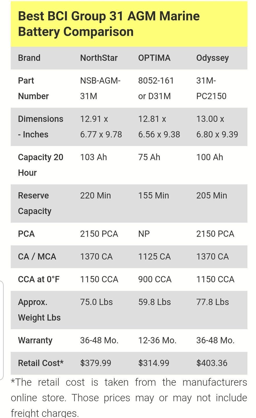

Are those the gray X2Power batteries? If so they are Northstar out of Missouri. Have a good product rating for Group 31. Found this older comparsion below for the 31M.
Side note looking at the prices the Duracell AGM are still a deal, about 60% savings over the Northstar on Batteries Plus, also those are mfg in PA last I checked, those are East Penn/Deka just labeled Duracell.
