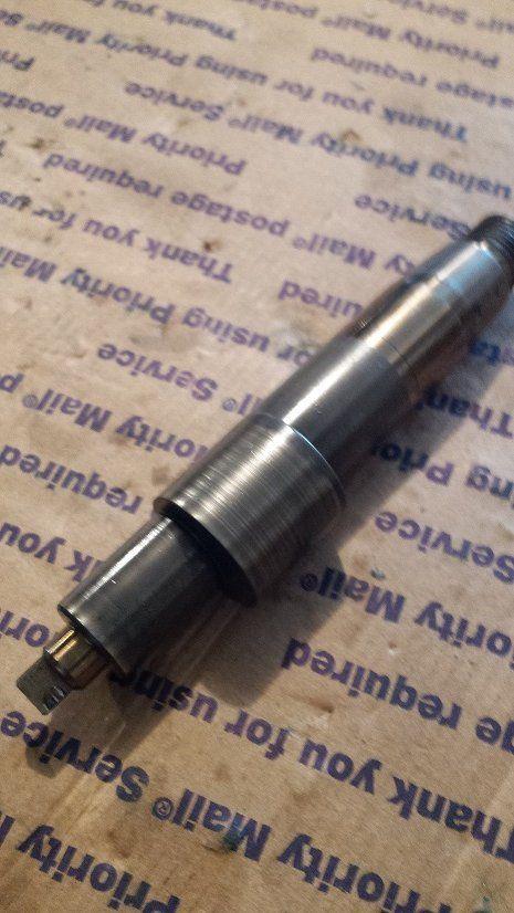

I consider any Injector (CR) thats NOT reconditioned BY BOSCH (Don't buy the idea that the shop is certified BOSCH) molested or house reman...They are just problematic in most cases. Save yourself the heartache and misery and replace with Genuine New BOSCH or Virgin New BOSCH , Well more myth on pumps then injectors..Here's aftermarket 5.9 shaft with 6K miles, I have an entire box full of bad shaft ready for recycling.
