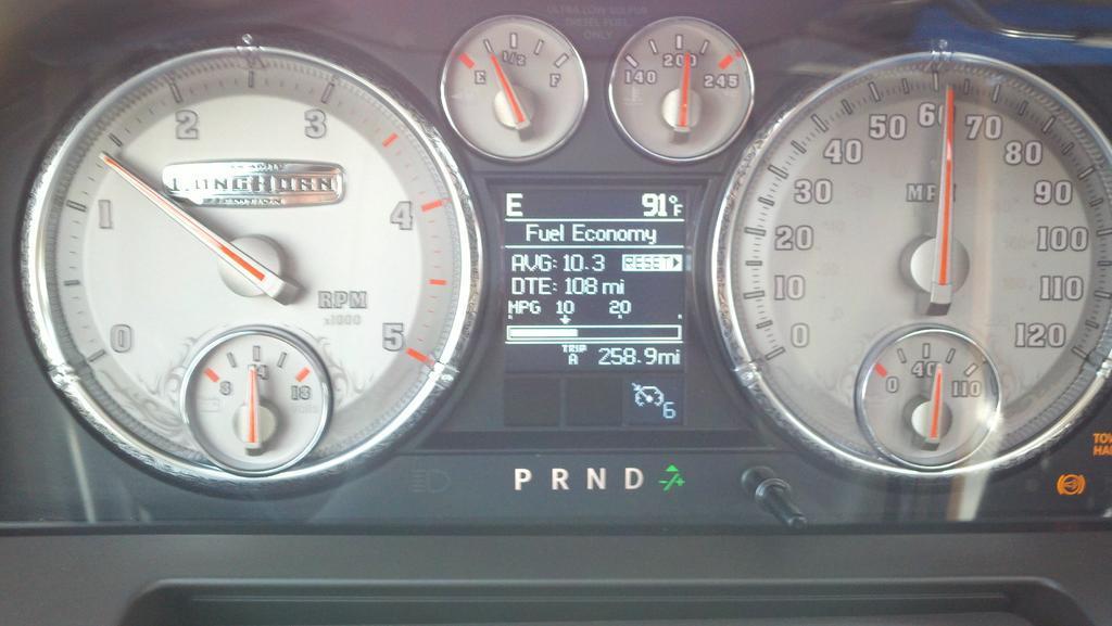

I will say, many of the fuel economy numbers I see posted on here are optimistic, or the owners are driving with Miss Daisy in the truck. I see 12-14 hand calculated on average, metro big city driving, with a best ever of just under 16 on a tank that included a couple hundred miles of highway at 75-85mph. Towing I have never seen above 10, except for one tank that was mostly 55-65 running flat in Iowa. Average is closer to 8 running 75ish and 9 running about 60-65 in commiefornia. 85 will give me about 7 towing my 7500lb Toyhauler. I have seen low 6's on more than one occasion, again hand calc'd. Had truck checked on the computer at dealer and everything is up to date and no faults found.

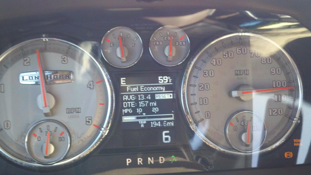

I towed our 39'4" 5er weighing just under 16K (25K combined) from Washington to the East Phoenix area at 60 MPH and got 10.7 MPG hand cal over all. Lowest was in Nevada on 93 with wind at 9.7. Speed kills mileage!
Filled up the other day in AJ and have a couple hundred miles running around Phoenix area on the 60, 10, and 101 and evic is reading in the 19's right now, so mileage is in the 18's. I drive the speed limit, did I say speed kills milage? Slow down and enjoy life a little. Snoking

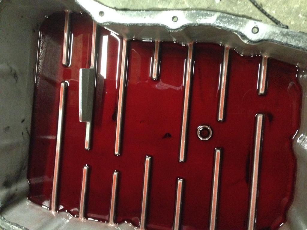

Pan at 65K with at least 1/2 the mileage towing. There was at least 50K on the AMZ/OIL.

You say 4;10s? However, you're only reving 1400 at 60 mph? That's what I tack with 3:42....
