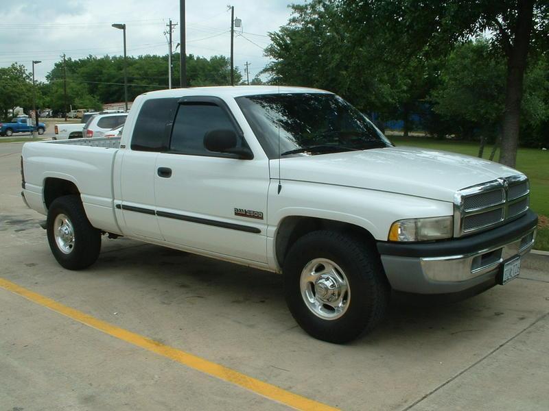

Well it has been awhile since I have been on here, just don't seem to have the time anymore. We finally replaced the 93 (old dodge) at 310k miles still ran good but the body was rotting away. We got a 2000 (little dodge) from Dallas TX super clean. When we broght it home it towed a load on the way home. First short bed I have ever had. When we got it back we shot the works, new dash and every kind of maintenance we could think of, even had it under coated after the new gooesneck hitch. It has been out to the east cost and a couple of other runs. The other day it just died. The injection pump crapped, as we took it apart every steel fuel line and banjo fitting is rusted inside all the way to the filler neck. I have never seen this much rust in a diesel that ran. The entire fuel system is being replaced from the filler neck to the pump, only the tank and plastic lines stay. That hurts, so much for the good deal. Our 2wd is usually used for pick up and delivery of a single tractor at a time, so it can avoid the DOT bull. We are buliding a custom gooesneck trailer just for it.

The truck spent it's life in down town Dallas. I don't think it's ever seen a days work. It still has the original U-Joints in it. The owner was in the military, so it was mainly driven by the wife while he was gone. Humidity there is extremely high. I think the problem started with low quality plating of the steel parts. When I started looking for parts I saw that there is an aftermarket filler neck tube. Checked with the company that makes them and they sell a lot of them. The vent side of the tube of the neck is where all the rust was. It was literally bubbling out of the end of the tube. Seeing as it's a small tube, I suppose it's hard to plate in there. The guy had said that they had put some type of additive in it with every tank full. I'm not a big fan of all of these additives. Some are more corrosive than people realize. This additive may have ate some of the plating away, especially in the fuel lines where the fuel sat. The fuel lines had little round balls of rust stuck to the insides of them. When we took the accending unit out of the tank the top and bottom of the pick up screen had over a 1/4" of crap on it. When we tried to clean it the screen just disintegrated. The guy had said that the injection pump had been changed at 100k miles so I thought we were good. I brought a fuel gauge with me to check the fuel pressure at the injuection pump before I bought the truck and it read good. I think another part of the problem was they always had their service done at a quick lube type outfit. Just before we got there he had it serviced again. So when we got back we didn't change the fuel filter because it was on the invoice. After the pump crapped we took the filter out and it didn't look like it had been changed in years. I suppose the outfit could have been taking advantage of his wife while he was gone. The bottom 1 1/2" of the fuel fitler housing looked like it was just dissolving. I don't know if this is from water sitting in there or whatever the addivtive is they were putting in it. One more thing I found odd was the plastic return line right at the fuel tank was kinked shut so I don't believe the fuel was circulating like it should. This may have been why the first pump went out. I think the kink has been there since it was new. It doesn't look like the tank has ever been dropped.

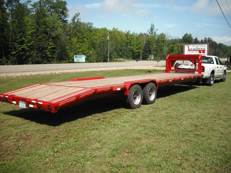

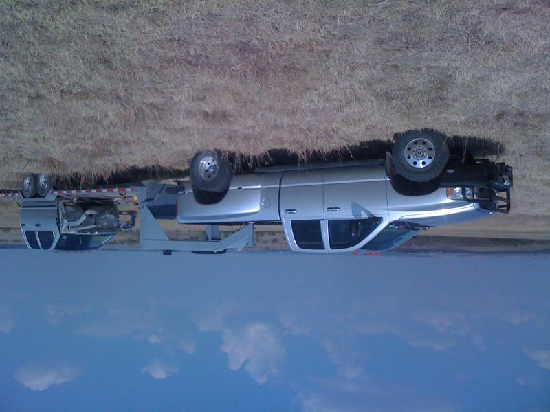

I like running a 3/4 under a trailer, myself... I built a 24' with two 7,000lb 8lugs, so between 14Klbs + 8800lbs (or even 11,000 for my duallies), I stay below the 26,001lb GCCW DOT cutoff weight.... Been stopped twice by the weights and measures here in Texas, and after they scratch their heads for a minute, they release me with a warning for something bogus.... I'm never that lucky with the Kenworth!! :mad: I loophole several of the requirements with Farm tags, but still they're always watching for a way to raise revenue....
(Dang, I can't delete it to upload the edited/rotated pic.... bah!!)
HH, if that goose is a homebuilt gadget its pretty dang slick! I fabbed a tag tilt with 2 7k lb axles, with a head ache rack up front to mount a winch. But it doesn't look that good! :eek:

That gooseneck looks nice, but now my neck hurts.
Yeah, sorry 'bout that... dang thing is right side up as it's loaded on my PC... WTH? :confused:

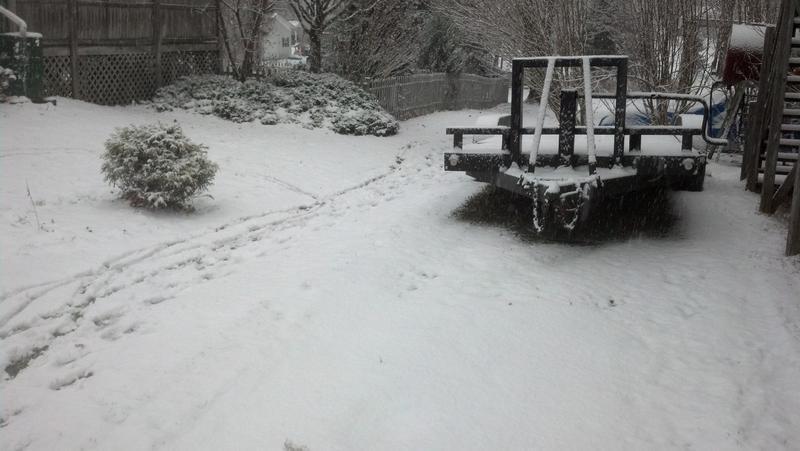

Yours looks pretty good, but like mine, you can't see much of it... I like yours, except for the fenders.... they won't hold me.... On mine, I used 10" channel, and have driven over them with a tractor and various other trucks repeatedly, with no problems. They'll even take a ratchet tie down.... Dang this is 3"x8" rectangular tubing frame, and you can jack up one front corner, and it barely leans, lifting the whole front of the trailer!! It's solid!! I've got close to 75k logged on it, and it's worked fantastic, other than the cheap press treated floor lumber coming apart. I've got a receiver hitch welded in on the upper gooseneck brace, so I can slide in my winch and use my jumper cables to jump to the truck battery if I don't have the quick connect. I built it as part of an FFA project with the local school, so I took time I wouldn't have in building it, teaching the kids how to get it straight, how to weld a good bead, and then paint and wiring. It took forever, but the final product was well worth it. The kids won in their class at the state finals, so they got all kinds of new tools and hardware for their shop. They did a good job, for their part. I've been really tickled with it, and plan on building another for my Dad.....

I actually cheated on the fenders, I bought them from a trailer supply company. They were a scratch and dent pair which didn't really matter because I had to modify them a little anyway and repainted them once they were welded on when I sprayed the rest of the trailer. I've got just under 7 feet between the fenders, so driving over them hasn't been a concern with anything I've hauled yet. I'm not a real fan of deck overs, they are nice in the fact that they generally have a narrower wheel base but I like having a lower center of gravity. There are a few things I would change if I did it over, but overall it's been a good trailer for my needs.

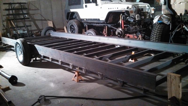

If I can I will put some pics of the one I am building now. It will have the lowest deck on a gooseneck I have built. The lower the load the less wind drag to deal with and you dont have to sweat the corners. It is being built to haul 1 or 2 compact tractors at a time, it's only a 21ft, trying to keep it light. Even the neck will be shorter in height and length for a 2wd short bed. It will have 2 6k 4" droop axles and I am hoping to use 15" tires.

If I run a 15" it'll be a 6 lug, and a 6k dexter axle will use the same wheel bearings as a 7k dexter axle. Both will use 12" brakes. As a matter of fact the 8 lug drums of a 7k can be interchanged onto a 6k axle. They also make a 15" E rated tire, kind of hard to find, I haven't ran them yet, but we have a customer running them on a dump trailer and he has good luck with them. I'm trying to keep this trailer light and low. Here is a picture of one of my favorite trailer, I didn't build this but I drew the plans for it. This was built to have the lowest deck on a 12" I-beam that I could come up with. It had drive over fenders, 8k oil bath hubs, and 215s on 17.5 rims H rated. The tires were about 30" tall. The deck was around 29" tall. I had one with triple 7s but because of costs I had 235s on it, so the deck wasn't as low. I get what you mean if 15s give me truble I will get read of them, we pull the big loads with the dually.
I went with 7k axles just for the extra cushion, I rarely exceed 10-12k lbs combined (trailer and load). I have made some lengthy trips with it and did not like the idea of running axles/tires/hubs at close to their max rating for hundreds of miles...
