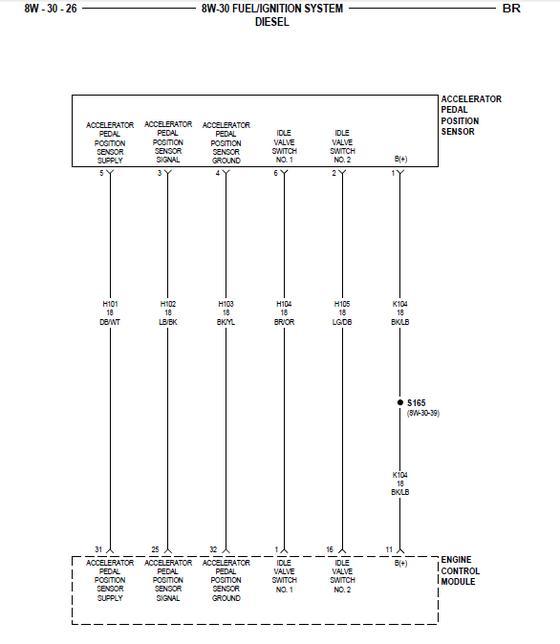

Here is your wiring diagram. Unless the wiring is damaged, bad splice etc. I highly doubt it is bad. You would need to check voltage to ground at the ECM and TPS to verify voltage. I would personally try running a seperate ground from the TPS to the battery and see if that solves it.

Boeingsiesel, A flter was installed between the TPS and the module on the firewall when the transmission was rebuilt and sometime in the past someone ran a ground wire between the TPS and the battery.

Davidc, Thanks for the wireing diagrams, That is how my mecanic found the filter and the ground wire.
