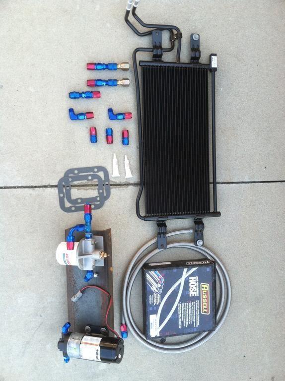

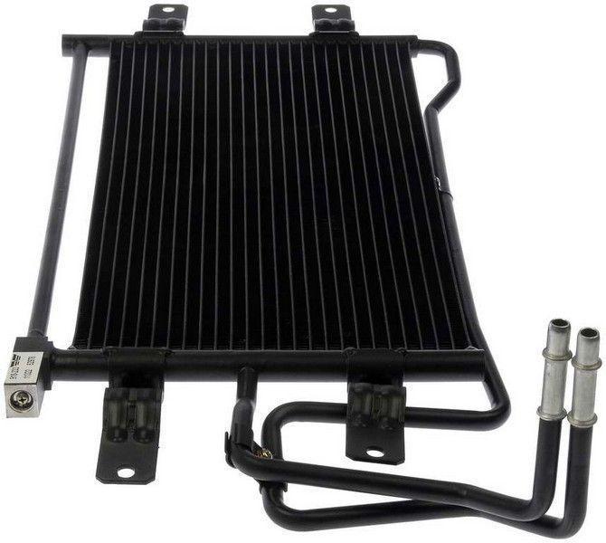

This I devoloped for my G56 but it will adapt up to a NV5600. The OEM auto trans cooler will bolt up to the radiator of a manual equiped truck. BUT that cooler is for a 3rd Gen, with that being said any aftermarket cooler would still work. Here is a link to the post. https://www.turbodieselregister.com/threads/246651-Transmission-oil-cooler
The filter is amazing it also adds almost half quart oil capacity they really keep the oil clean in fact your transmission oil will be cleaner couple hundred miles after you put it in than at first because it's hard to get all the black oil out of the case. Quad4x4.com has the filter kits and filters .

Thank you so much,,,,,,,,,,exactly what I was looking for and you saved me so much time and search.
