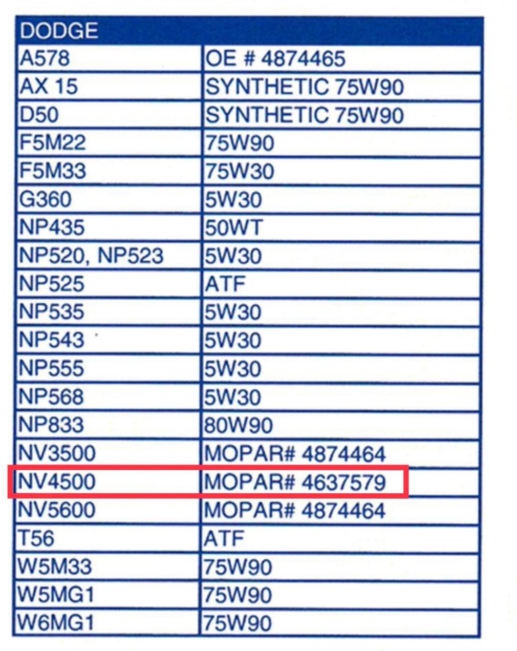

First, I’ve heard bad things about High Gear and would not use them myself.
Second, I don’t see anywhere on that chart where they’re recommending anything for the NV4500 besides Mopar 4637579 which is the Syntorq.
the reason i mentioned the Valvoline product is because this web site.
https://highgeartransmission.com/wp-content/uploads/2018/07/HG-FLUID-CHART-2018.pdf
They rebuild these transmissions and recommend the Valvoline product.
Just and FYI.
They don’t even list the NV4500 by name under Chrysler/Dodge, only GM. Seems like they have too broad a paint brush for their job. That’s just my initial impression of the pdf.. they may have their act together.
