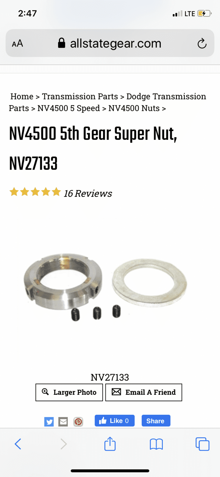

I used to get them through Allstate’s gear in Texas you have to specify the nit with the big Brass lugs not the one with the three round pucks
https://www.allstategear.com/NV4500-Main-Shaft-Super-Nut-Kit-p/nv27133.htm
I green loctite the bore of the gear the shaft splines the bore off the nut the brass lugs and the set screws and let the hole thing set overnight if you have the split washers on your shaft with metal ring I loctite that too
