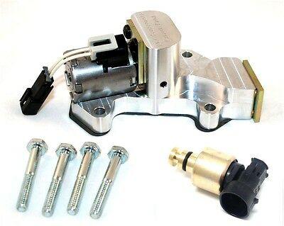

Did you ever swap out for the DNJ unit? Advised in the ATSG manual. View attachment 126202
Thanks Bill, mentioned this to Tim (original Trans builder/owner TRE Diesel Performance) when I dropped off truck Monday (1/18/2021) and he said that's older technology and they've been using a Borg-Warner (I think that's what he said) unit for quite some time. Anyway, truck is in good hands now (Tim was the last person, outside of; myself, tire shop for new tires, front end alignment shop, my buddy's shop for state inspections and paint/metal shop, to ever touch my truck. Just don't trust that anyone will "take care of her" the way I would, anyhow) and I'm positive he'll take care of her and resolve all/any issues before calling me, unless he needs my OK to dig deeper into the pockets. Just hope I don't hit lint if/when he calls. LOL. More to come.

Hey Matt42, thanks for your reply. Back eons ago when I had the trans done there was a DTT Trans Noise Suppressor/Eliminator that the trans builder (Tim) installed. I've checked the setting/reading of the suppressor and it was dead on whatever ohms/volts it was supposed to be. I had, long before the trans was built, installed the alternator noise suppressor/eliminator (not connected as is the DTT unit). So I'm relying on Tim to figure this out, I'm sure he will. I know there's a "thermistor" (pretty sure that's what the FSM refers to it as) that senses trans fluid temps and is "not" serviceable as it is located inside either the Solenoid or Transducer whatever (I forget which) its called, which I've changed a years back when the funky "when cold" shifting began.
