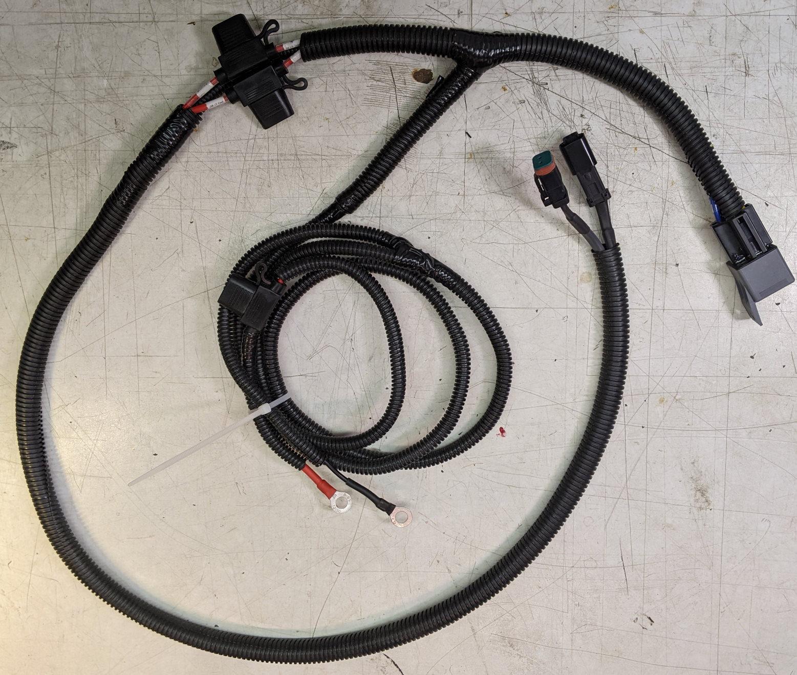

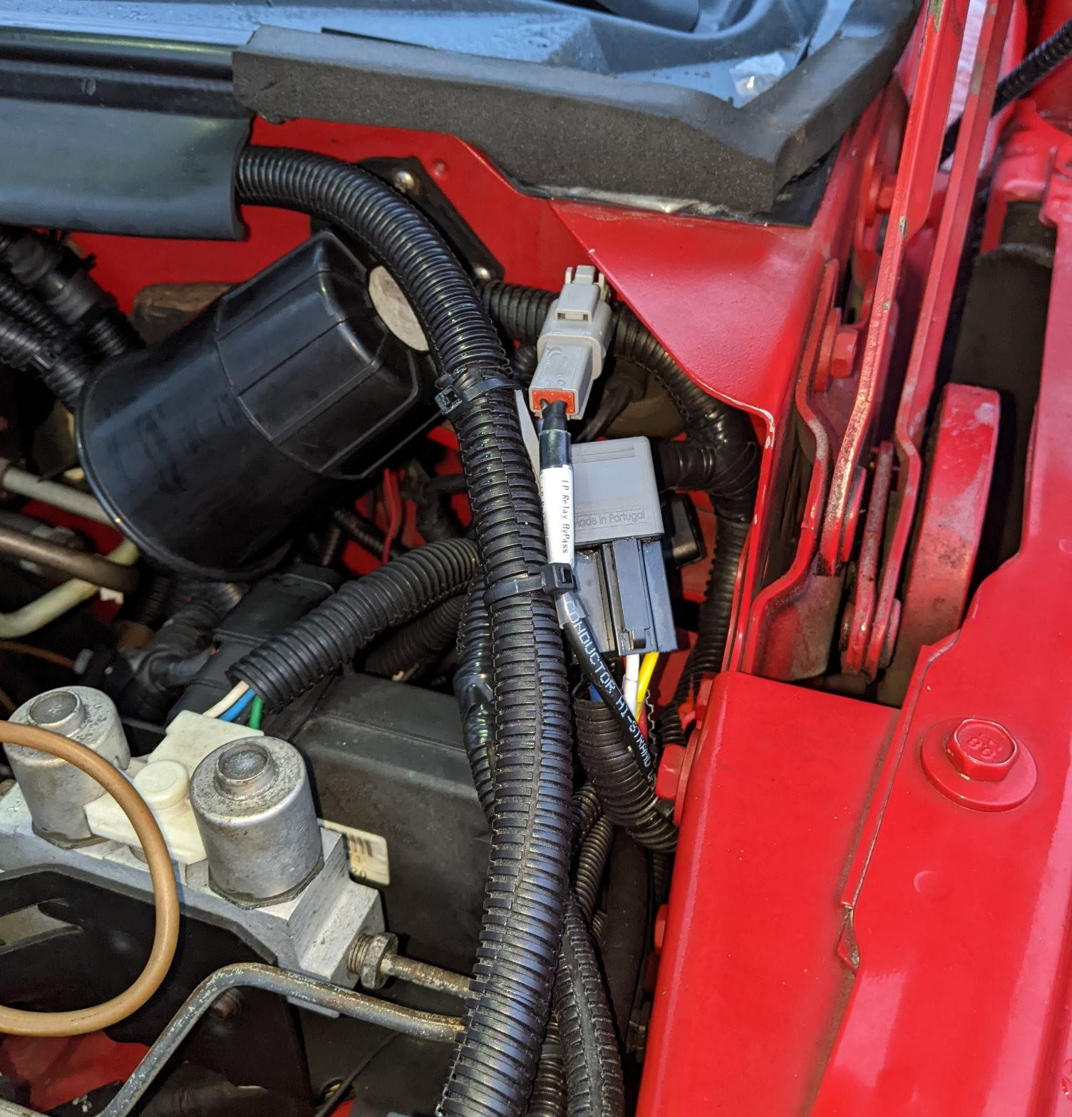

So just a follow up, the FASS replacement has been doing great.
I finally made a harness and sourced the LP mating connectors.
Fire up the relay off of feed that normally would run the OG LP.
And fused line off of the battery and out of the my relay, to the FASS.
And I fused the + line from the ECM.
This is the drop in harness before I realized, need to add just one more thing...

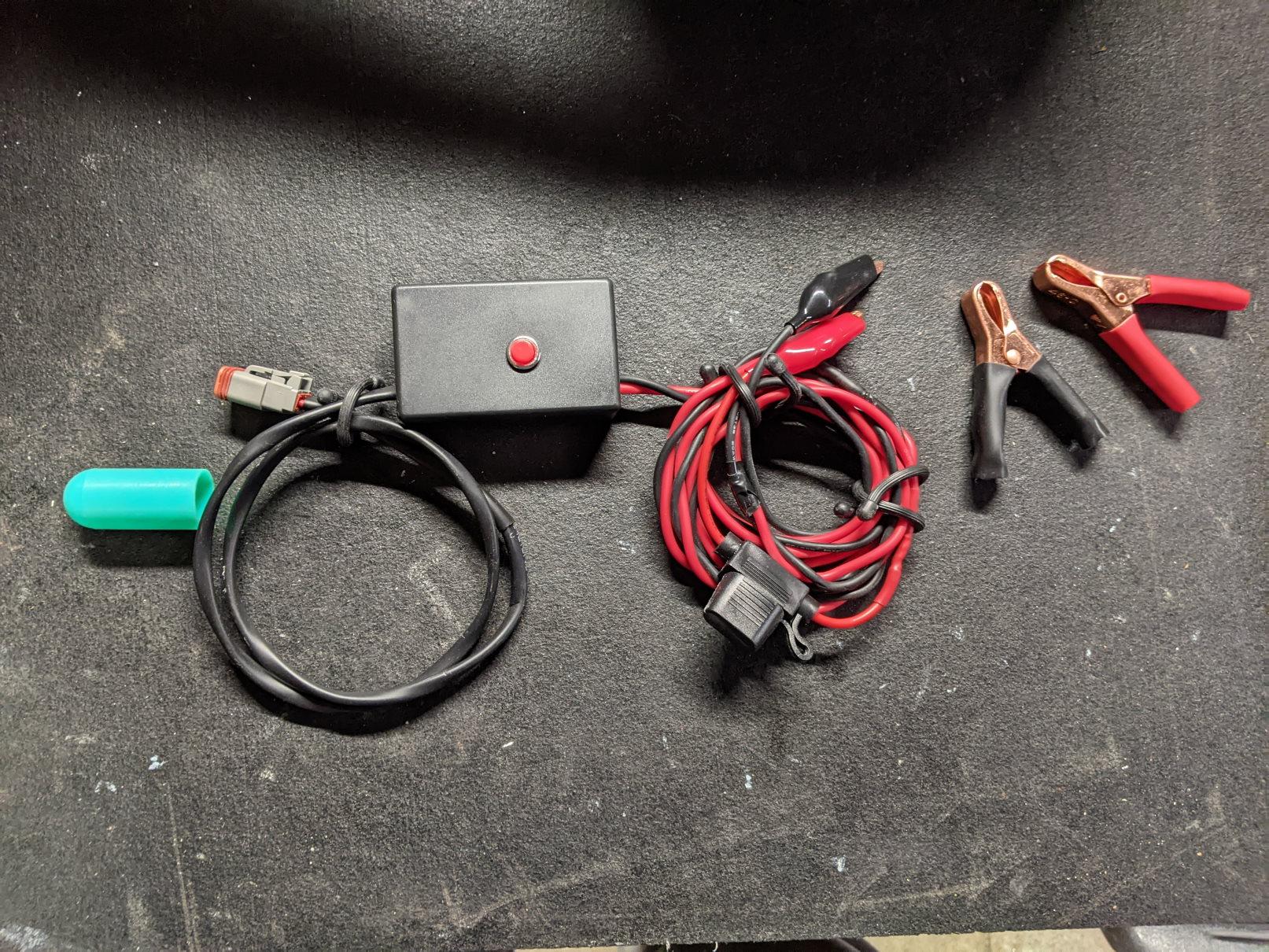

I've had the 99 since new, and the one thing that bothered me was bleeding the fuel lines after changing the fuel filter.
I used to call out my wife "Mary" to bump the starter, so I could crack the banjo bolt.
And 15sec didn't always seem it was long enough to fiddle blindly with getting the wrench on the banjo bolt, and open , and closed.
So WIAI (While I;m At It) in my harness, wired in an extra socket across my FASS LP relay.
So I could install a "Mary" switch.. flip the switch, get the FASS LP going, and bleed.
That worked great.
(no picture)
But after some thinking, I didn't like just using a manual switch that requires to be shut off.
Not too safe of ECO friendly.
I carry the "Mary" switch in the truck incase something goes wrong with the output from the ECM, or my relay.
I can jump it, and keep going.
So created a "Mary" box (I), momentary switch fires timer and 15amp rated relay built in.
The momentary switch, when pressed starts a 25 second timer, with a 15amp built in relay, jumps out the relay in the harness, and shuts off after 25seconds.
If the momentary switch is pressed during that 25 second period, it stops the count down, opens the relay, and stops the pump.
That worked great.

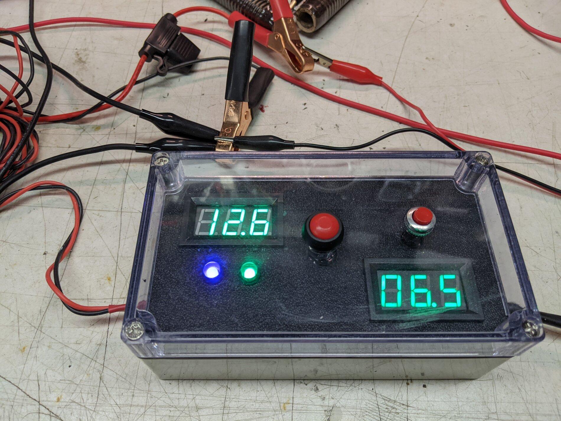

But I like data and WIAI, Rev3 and "Mary" box II.
Measures Pump running current and applied voltage to the pump , well at least at that point in the harness, relative to the negative of the battery terminal.
Meters are "under glass", as well as status lights. Needed switches are mounted to the "glass".
The large middle switch starts or stops the timer.
Smaller switch to the right Zero's the Amp meter, it uses a hall effect device to measure the current in the + lead.
So now I get to see the health of the pump and it's source of power per say.
Should have done this years ago, at least in part. The meters now a days are soo inexpensive and work well.
