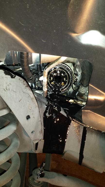

Follow gsbrockman link, You can loosen it form the wheel well then remove the intake plumbing and lift the filter out form the engine bay, By the time you clean up all the mess pulling it form thru the wheel well you will use 2 cans of brake cleaner invent a new $#%&* word pattern.

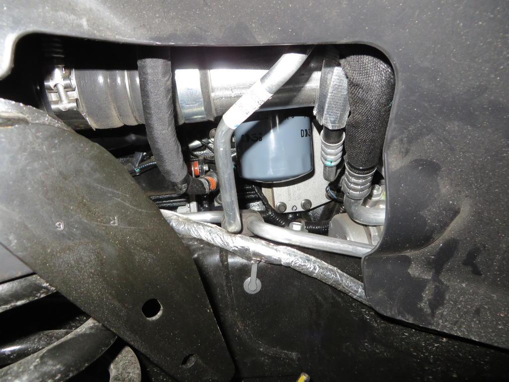

You got a plastic bag on this.......With no spillage...
I "ASSUMED" 2015 same as 2014 for oil filter location and orientation. Your picture shows what appears to be a filter mounted horizontally (mine is mounted vertically).
Curious as to what vehicle the picture is from.
2013 Ram 3500..........the 3500 in 2013 have the same frame ,DL, suspensions, steering and engine to 2015 3500s... 2013 2500s had same frame, DL ,Suspension Steering form 2003-2013 2500/3500, in 2014 the 2500s have different DL and suspension, both 2500s & 3500s form 2014 up have same steering 3 link axle (front)
You would tear up the bag with the filter pictured, as you can see its tight, My 2014 3500 (early build) is the same, I wonder if Ram change plumbing in that area, for easier access.
The picture denotes the orientation the filter is required to be in AFTER it's removed from the filter base........for those that opt to remove it from the wheel well. How a zip-loc bag survives that is beyond me......but more power to the folks that choose to do it that way. ;)
Oops
DUH - OH ! I see it's the filter base and not the filter mount in your picture - senior moment. Looks like the trucks are similar and yes, the bag worked great. I did however comment to myself (many times) about the person that decided to put the vertical tubing in the middle of the opening.
