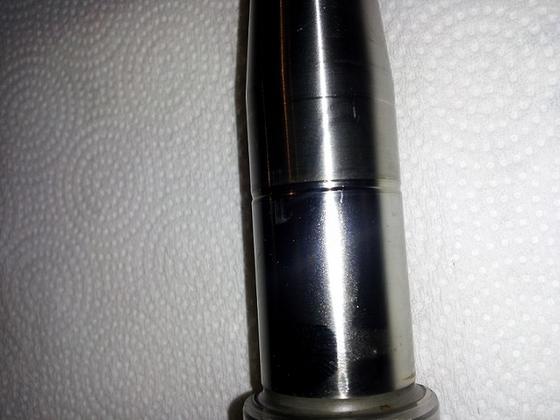

5% on a 5. 9 May not be a problem by %, but anything above 1. 5% on 3000 indicates some type of problem. Don't wait until your shaft looks like this.
