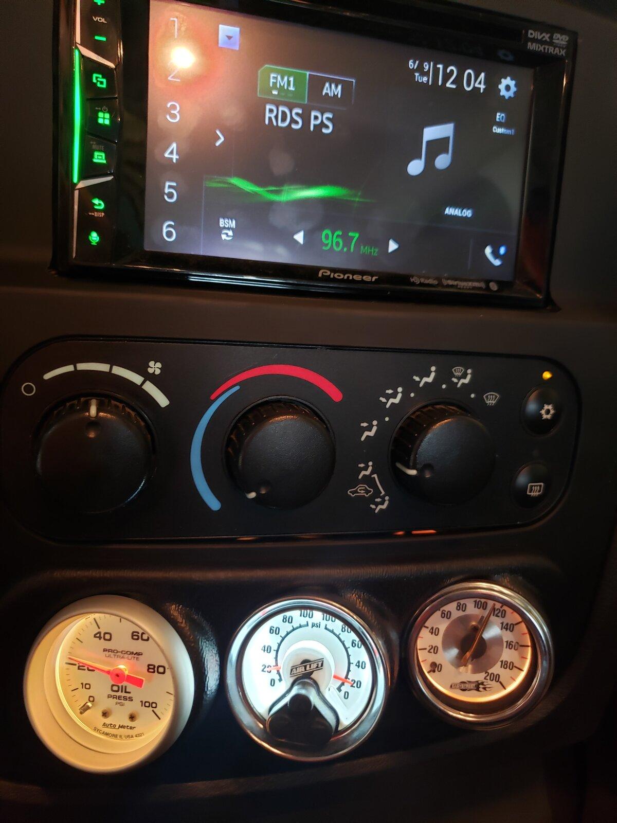

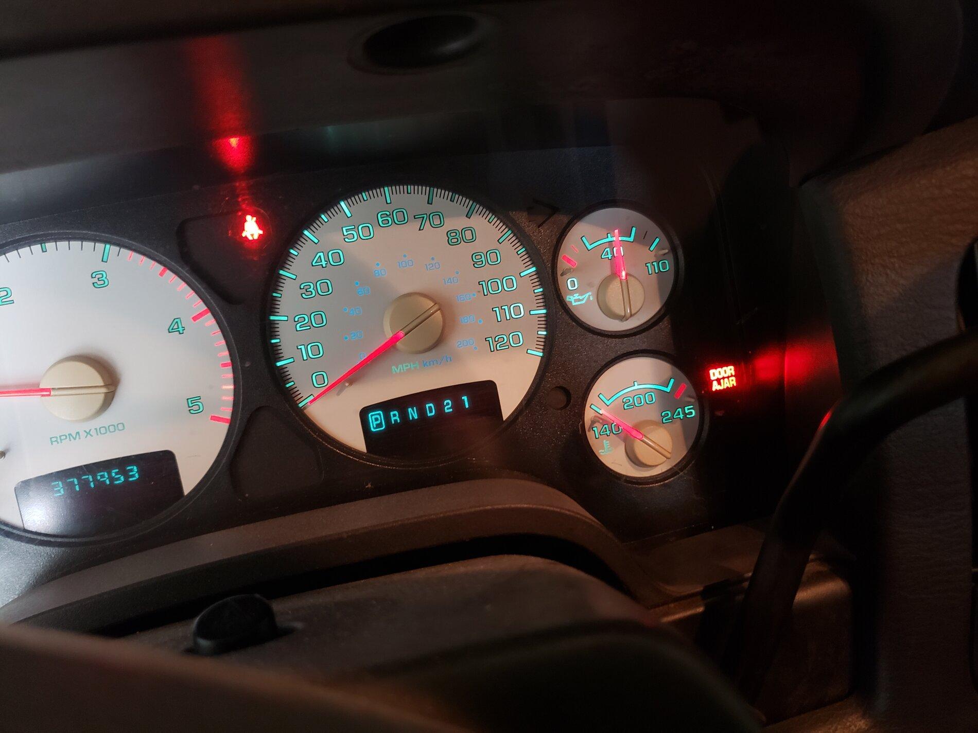

This one has me stumped, I decided to add a mechanical gauge to the truck and the original plan was to put a T in at the factory oil sending unit and add a mechanical gauge, low and behold Cummins uses a weird side end on its sending unit and I can't find the right plumbing parts. So, I decided to hook up to the extra oil port on top of the oil filter housing which uses the standard 1/8 pipe thread. So I get the new gauge hooked up it shows 25 psi cold, so now I'm worried, rob the mechanical gauge off my Imperial(I don’t trust the Factory oil pressure gauges on Mopar’s), same thing, now I go right to the housing with the gauge thinking I screwed up the new oil lines, no such luck engine is warmed up pressure at idle is 11 psi at the mechanical gauge. Factory gauge is showing about 50 psi cold idle and around 30 psi at full engine temp. Motor was rebuilt little over 100K, no problems. If I had not added a new gauge, I wouldn't be looking for an issue. My 2001 Ram I set up the mechanical gauge and had 70 PSI cold at 300 K

This engine has an oil pressure switch only. The oil pressure gauge is for entertainment purposes only. It lies and displays what the ECM thinks the oil pressure should be.

I really didn't pay attention to the oil filter housing, too busy filling ring gap I guess. Got the new value and I am going through my extra housing and installing a new Cummins oil pump. Current oil pressure a cold 25 psi idle to 60 psi @ 1500, full temp idle 11 psi, 40 psi @ 1500 rpm.

mechanical gauge is slow to build pressure but its going through 10 feet of hose, dash gauge very quick to show pressure. Problem has to be either the oil pump or oil pressure regulator or does anybody else have suggestions?

Again the dash gauge is worthless.

Interesting, when the pan is off I'll look for those. Yes I would have never been to question the oil pressure if I hadn't put in the mechanical gauge, no weird noises, runs very strong and I have pushed it and overloaded so many times. I just like most people believed that the OEM gauge really showed REAL oil pressure. Silly me
So it might be a really good idea that any owner of a Dodge Ram get a mechanical oil pressure gauge.
