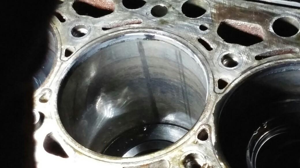

Well it's the worst case scenario, pulled the pan yesterday, I did have both J Jets and saddle jets installed. bearings and crank shaft look fine. Some wear on mains but nothing major. Cylinders and pistons look great, a little carbon build up. Order all new bearings, new rings and Attitude Performance saddle jet plugs along with new gaskets. Should I use a zinc additive for break in again? and am I forgetting anything?

Better than normal if it did not wipe out the rear 2 main bearings. Did you get the good Clevite main bearings with the 1 piece thrust bearing? Did you order the rings with the wider gap on them?
Not gonna hurt to run the additive again with new bearings.
Rear mains had some wear, but still had many miles on them to go, rod bearings looked very good. No metal in the bottom of oil pan. I ordered Clevite bearings, Mahle Rings, Cummins head gasket, front and rear main seals. rings are .020 over to match the pistons and I will gap the rings. What do you recommend for ring gap, stock top .010-.014, middle .033-.045 oil ring .010-.022? I'm now reading stock gap is a bad idea for non stock motors and heavy tow applications. S**t, I just realized I forgot to order exhaust gaskets.
IIRC, .020-.022 on the top ring the rets stock. Make sure the bearing set has the 1 piece thrust bearing. This is what happens with stock ring clearance son top ring and too much heat.
Motor is back together and running, oil pressure is at cold idle is 70 psi, hot idle 31 psi. Motor running much better, very smooth. Finishing putting the final touches and will be break in driving today.
