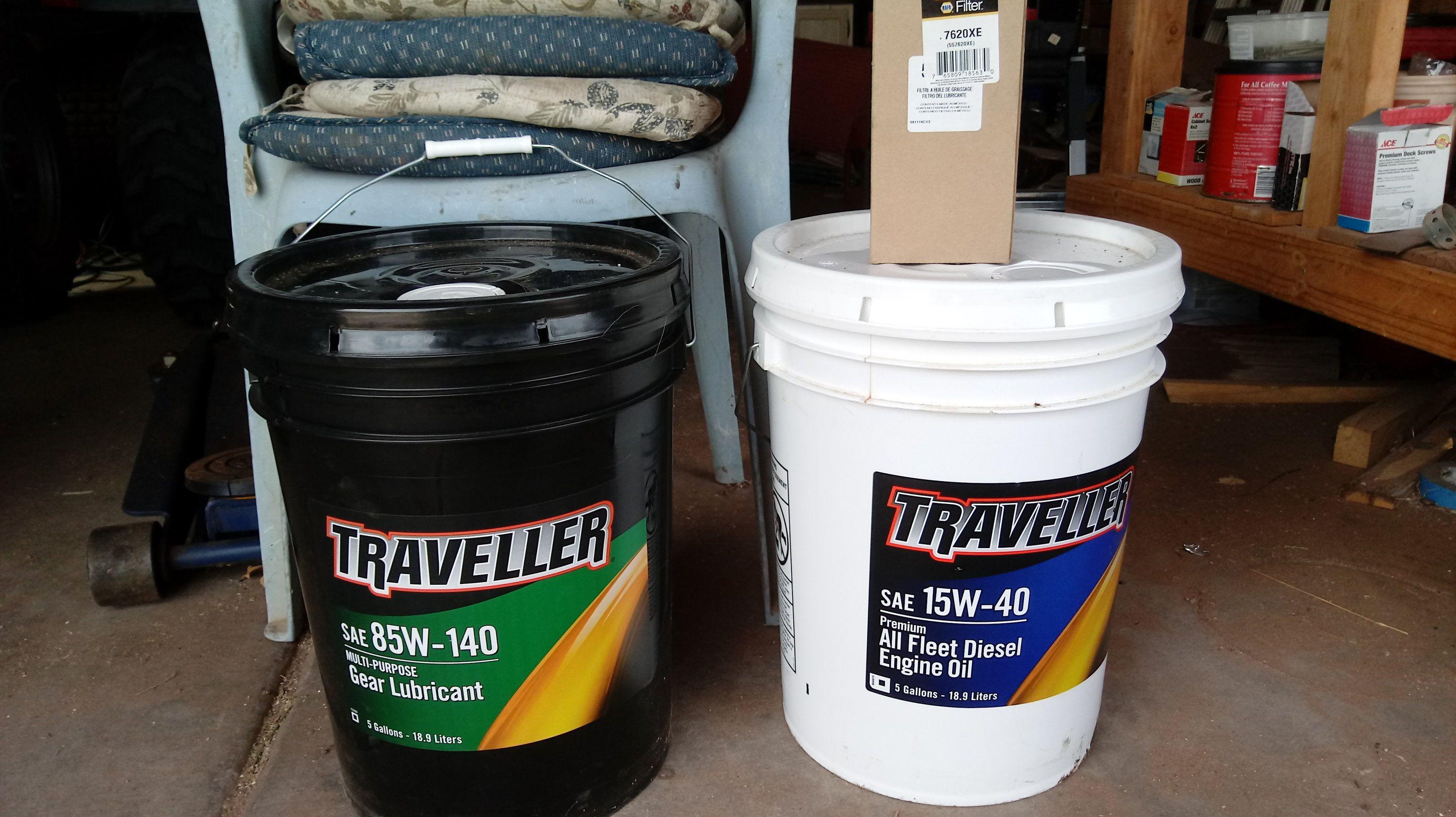

For years after oil got so expensive I bought what was on sale, auto parts store brand and name brand. For the past year I have been using Travelers, way cheaper all the time, than others on sale. $7.60 per gallon the last time. I use Walmart for my gassers. I don't know anything about the technical specs but I can look tomorrow.

For years after oil got so expensive I bought what was on sale, auto parts store brand and name brand. For the past year I have been using Travelers, way cheaper all the time, than others on sale. $7.60 per gallon the last time. I use Walmart for my gassers. I don't know anything about the technical specs but I can look tomorrow.View attachment 109803
I see the Napa filter box, but that looks like a Wix part number to me.
NAPA Gold are made by Wix.

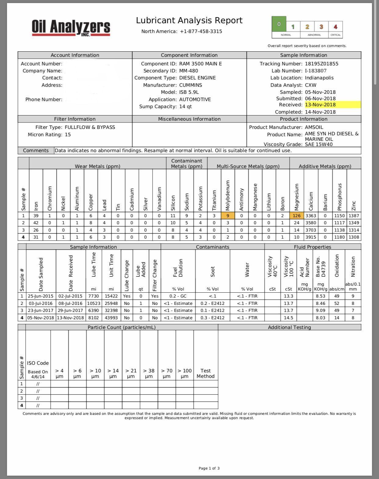

I’ve been running Amsoil AME CI-4+ 15w-40 in my motor and getting getting great UOA’s.

This change, last Monday, I went with Amsoil DME 15w-40 CK. I’ll do a UOA next year and see how it’s doing.
The DME has some properties I like over the AME, and I’ve seen some great UOA’s from it on newer 6.7’s.

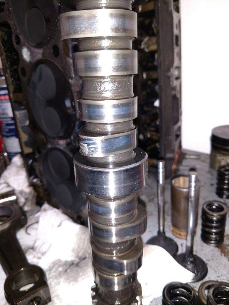

Stop in a place the rebuilds Cummins engines and look at the camshafts in the scrap bin. You won't feel so good about modern oil specs anymore after seeing them. Cummins doesn’t appear to be worried AKA: Did enough make it out of warranty so we don't need to worry? How about that 6 month oil change time limit?

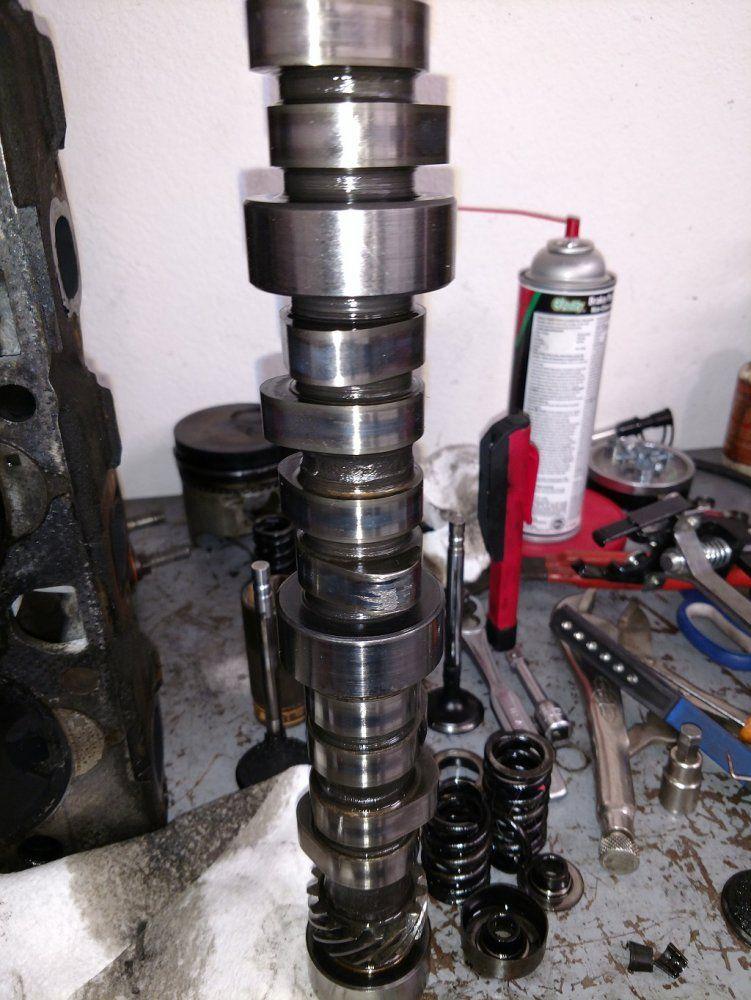

In the past two years I have run across two wiped lobe roller cams. Buddy's 3.9 V6 (250K miles) and now my hot rod 6.2 GM diesel (~70K miles). Due to gapless rings I used the engine was spotless as far as soot you would normally find in a 6.2. Rumor has it that cam failures are worse than crank failures. Maybe so as the only thing I am reusing off the long block is 1 non-cracked bare head on the 6.2. The 3.9 V6 may have used the crankshaft from the longblock.
That’s alarming!
The only answer I have is that I don’t see much on the TDR about valve lash being too far out. I’m guilty that I have never had my cover off yet in 4800 hours.
That cam you show looks like it got hot too. What an eye opener!

Wow! That cam got HOT.

Interesting observation on the cam getting hot. The camera (flash?) brings a blue out, but, it's just a wear shine in person. I will have to look at it from a getting hot perspective.
