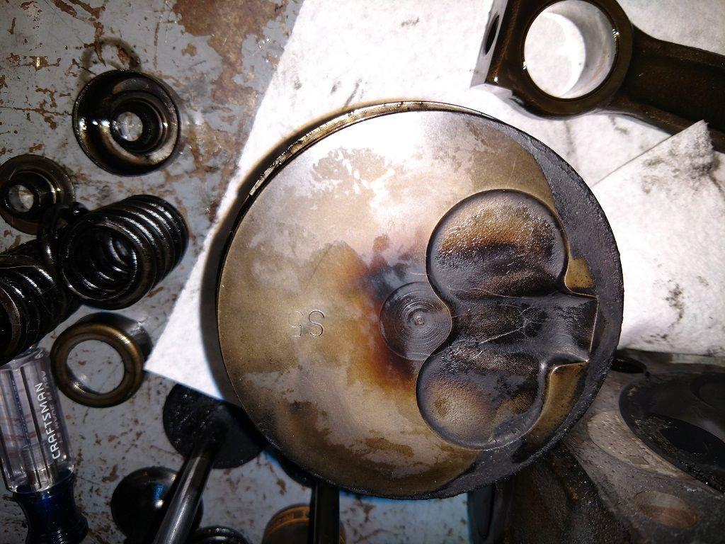

The 6.2 I wiped the cam in is anything but stock.

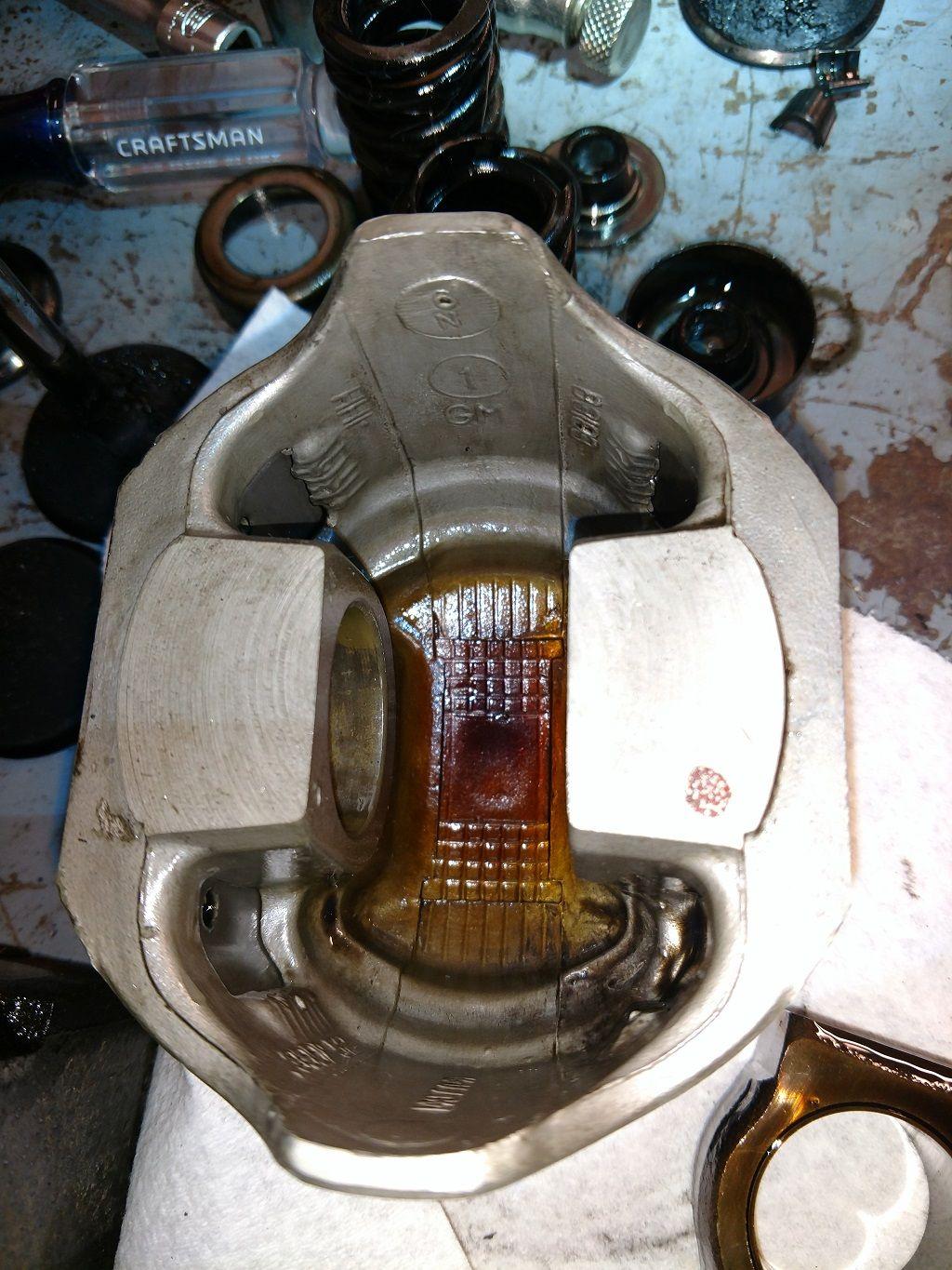

How many tuners are being run on Cummins trucks getting closer to the edge of what modern oil can take? The hot rod 6.2 burned and surface cracked the piston crowns. (Glow plug erosion indicates too much advance contributing or the sole cause of this damage.) Turbo 6.5's have a coating on the piston crowns and later production went to oil squirts to cool the pistons. The next 6.2 I am building has coated pistons on the way for it to keep the oil cooler.
I have been told to run a better oil in the 6.2 by a couple of people and had to tell the retired fleet manager: "We already ran Shell in it... and now run 15w-50 to keep oil pressure up at hot idle". Same advice from the person coating the pistons: run a better oil and a bigger oil cooler.
