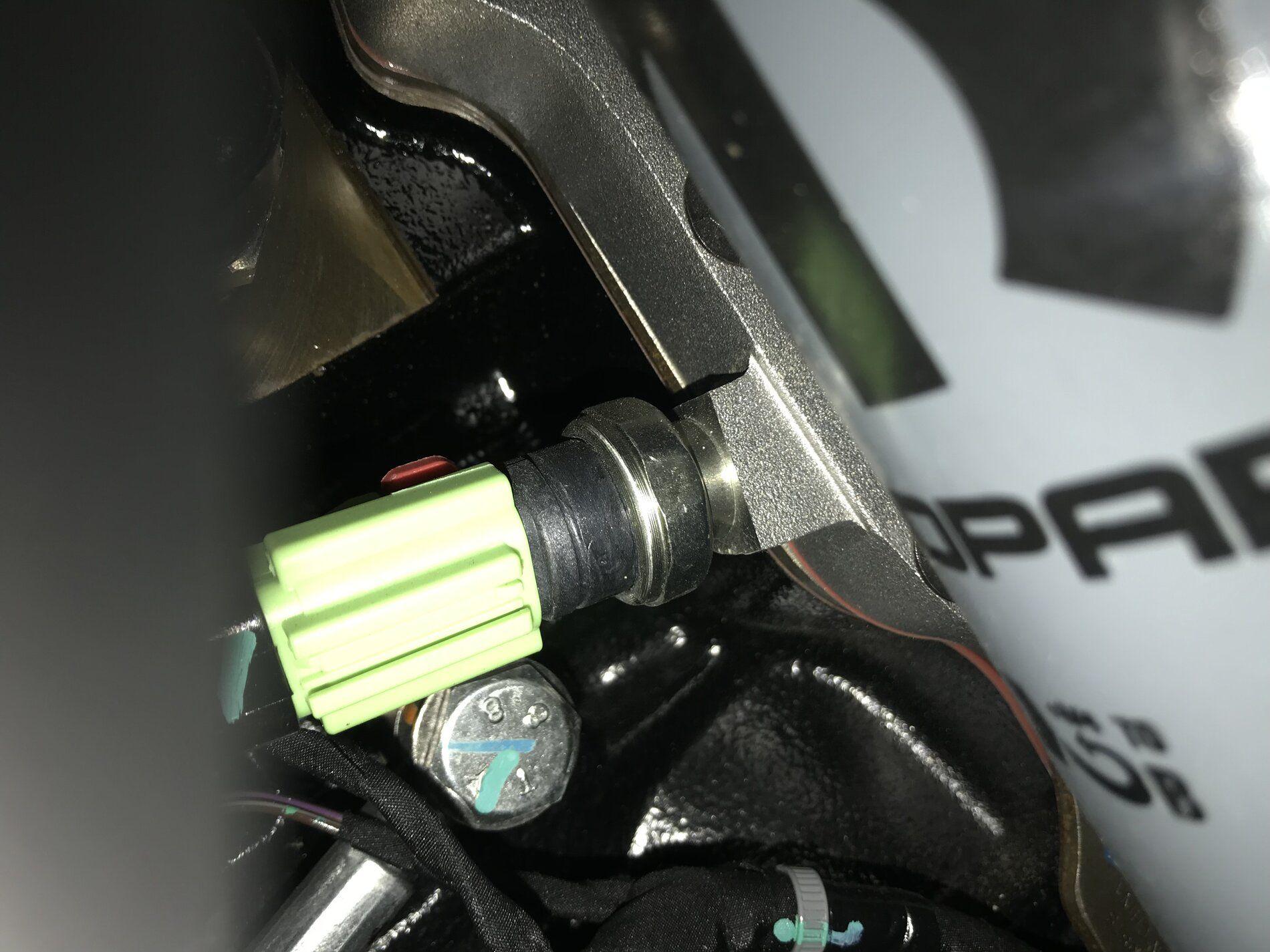

Is this oil pressure or temperature?
So mixed reports.
It looks like the pressure sensor. But it only trips when the pressure drops below 8 psi.
Near the output of the oil pump and before the oil filter.
That is a common location for all pressure sensors (many gassers and diesels) attached to idiot lights for low oil pressure on the dash.
It is where I tapped the oil for an amsoil bypass filter with a T unit that accepted both the amsoil fitting and the pressure sensor on a 1998 isuzu amigo. A temp senaor wouldn't likely be that low and close to the oil pump and oil pan.
The oil psi sensor has been on the drivers side of these motors, but now I can’t find it.
Also that’s a 1 wire sensor, so it’s a switch not a sensor.
