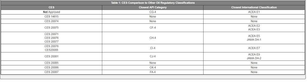

I also found this. I find it interesting the CJ oil is never recommended, only permitted. CI and CK are the recommended oils.
Probably has to do with the fact that 20086 is the latest standard, and according to their note iswhat they prefer given the use of ULSD

Copy and paste from
https://qsol.cummins.com/qs3/portal/service/manual/en/5411406/

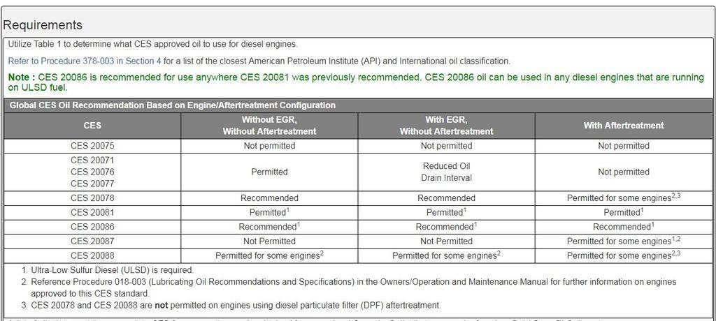

Global fuel quality plays a significant role in selecting the appropriate oil. For locations with fuel sulfur > 15 ppm and not using aftertreatment, do not use oil meeting Cummins® Engineering Standard (CES) 20081, CES 20086, CES 20087, as the starting total base number (TBN) is typically lower and may require reduced oil drain intervals. For fuel sulfur > 15 ppm CES 20078 is recommended.
Also, to back up my previous post,
Note : CES 20086 is recommended for use anywhere CES 20081 was previously recommended. CES 20086 oil can be used in any diesel engines that are running on ULSD fuel.
The link takes you to the same general page as did in Johns post, but the info is in there.

LOL, even though your link takes you to a general page it's on the same page as what you screen shot. It's been a while since I've been on Quickserve. They have a lot of good info "straight from the horses mouth". Very valuable resource.
