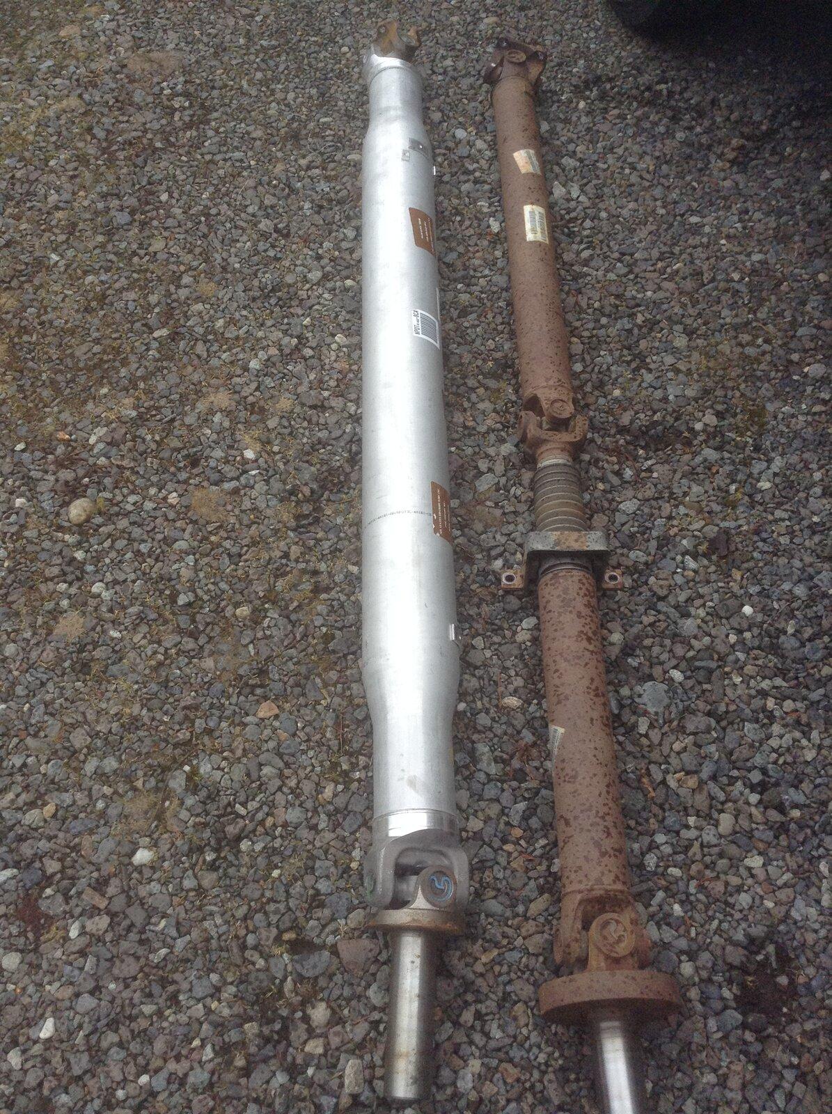

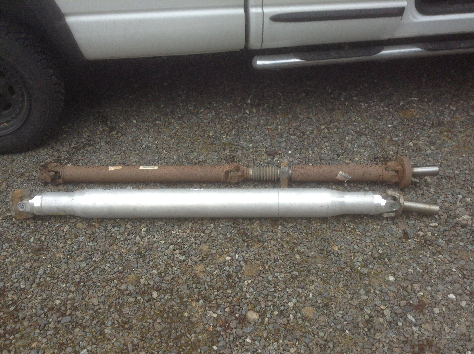

ONE PIECE DRIVESHAFT FOR 2007 3500 SRW QC LWB 4X4 w/G56

Unless you have a standard cab or QC with a short box the DS is too long to be a single piece. Even a QC SB is probably not going to work without something 6 or 8 inch diameter and that is prohibitively expensive. Even the 5" on at max length around 84" is borderline behind a Cummins.
