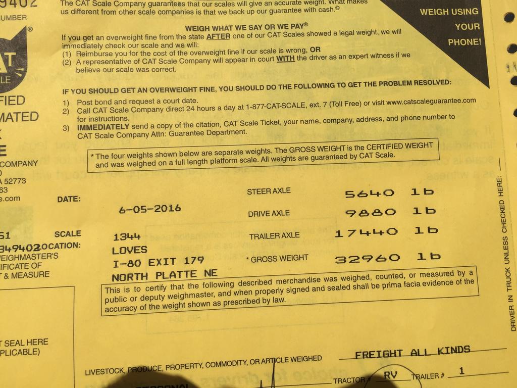

My door sticker says rear axle 9750 pounds at 65 psi and my front is 6000 at 80 psi. Wonder why your rear says 70 psi. I have the 17 inch E rated tires, is yours different?
LT235/80R17E
65psi dually load rating 2.470 x 4 = 9,880#
70psi dually load rating 2,470 x 4 = 10,240#
So based on my weight I am right at the limit with 65psi.
