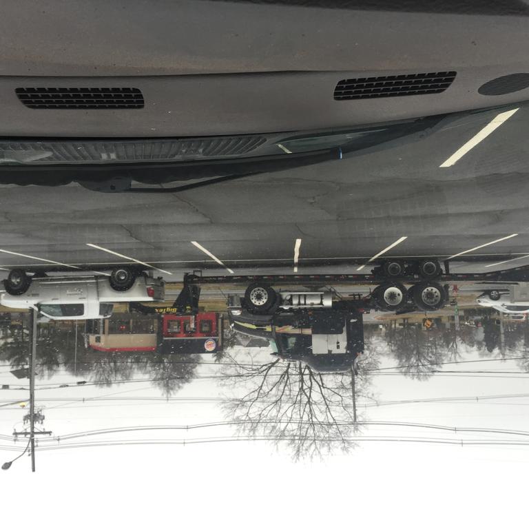

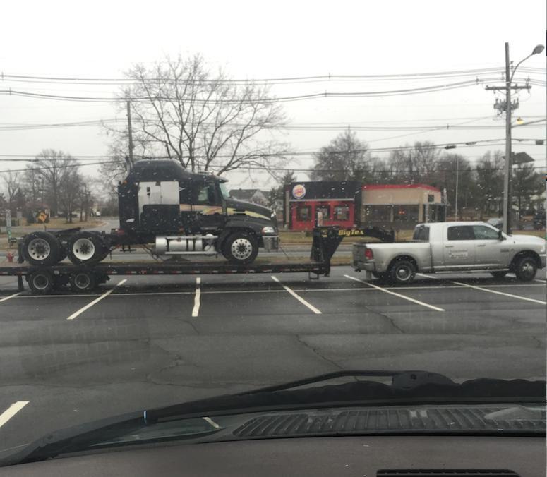

Found this pulled over in a vacant parking lot...guess he was put out of service due to being "overloaded??!!"

Semi tractor is most likely less than 20K + trailer 9-10K? He is within 4:10 Aisin limits 28,810 pound limit?
SNOKING
Although not related to why he may or no may not be stopped.....I would guess it would have been better to have the tractor a little further back on that trailer.
Speculating why it was parked if it was weight related; Could be improper weight tags (some states register by gross weight) or the driver might not have had a class A drivers license, which is required in every state I have researched for GCWR over 26,000 pounds. At any rate, the manufacturer's weight ratings don't mean squat to DOT.
