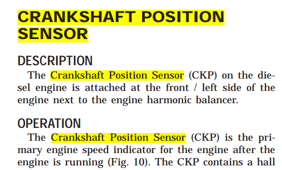

The Crank position sensor is the same sensor as the Cam position sensor on the 3rd gen 5.9.
The cam position sensor abbreviated CMP in the FSM is the primary timing sensor used on start up, after the engine is started it becomes the backup sensor after the Crank position sensor abbreviated CKP in the FSM.
"The CMP (Fig. 10) provides a signal to the Engine Control Module (ECM) at all times when the engine is running. The ECM uses the CMP information primarily on engine start-up. Once the engine is running, the ECM uses the CMP as a backup sensor for engine speed. The Crankshaft Position Sensor (CKP) is the primary engine speed indicator for the engine after the engine is running"
