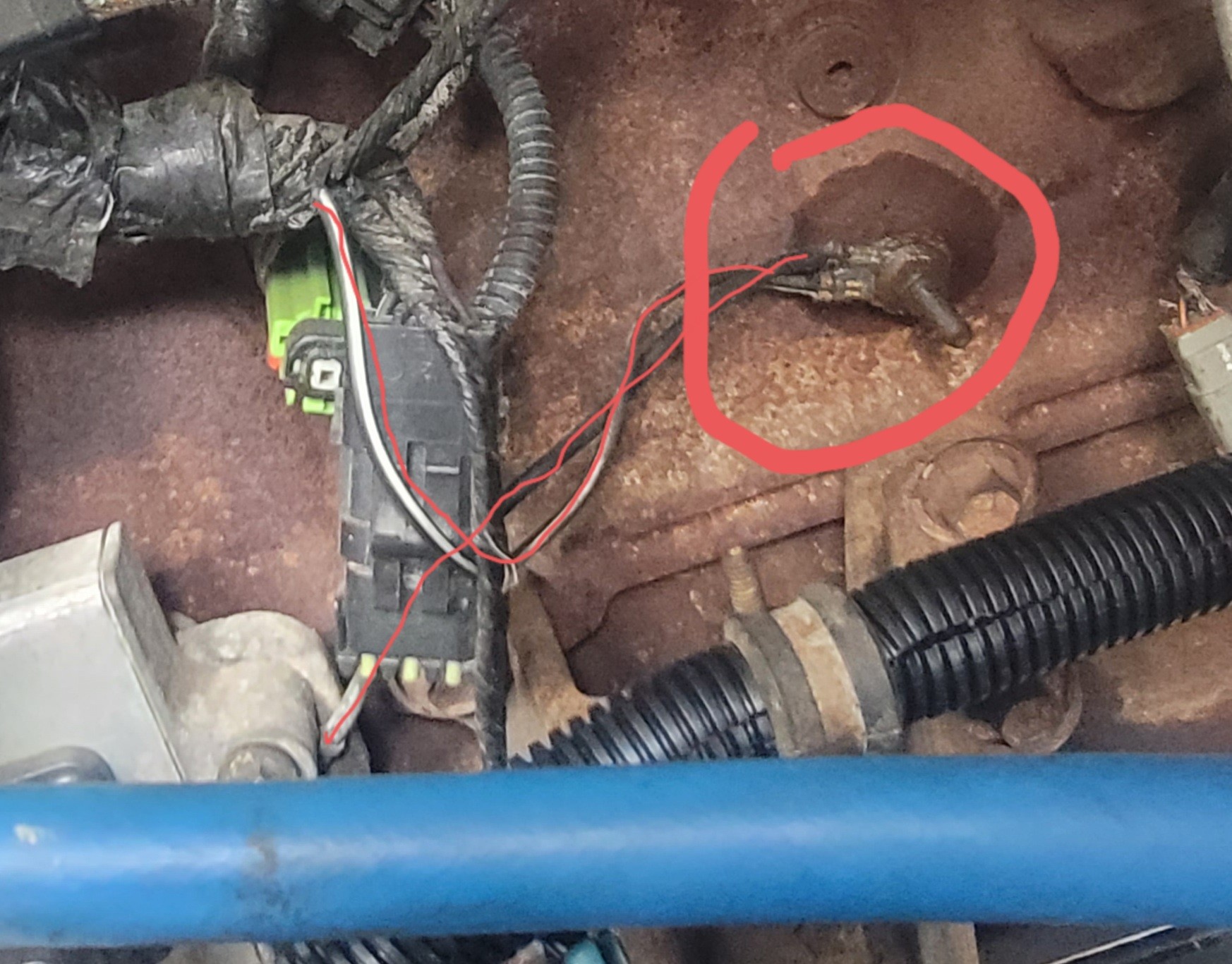

Check and clean grounds is a good first step, Here is pic of the ECM ground location. There could be multiple ECM grounds, this is just one I noticed when I was cleaning connections and installing new cables after the OEM alternator went out on me.

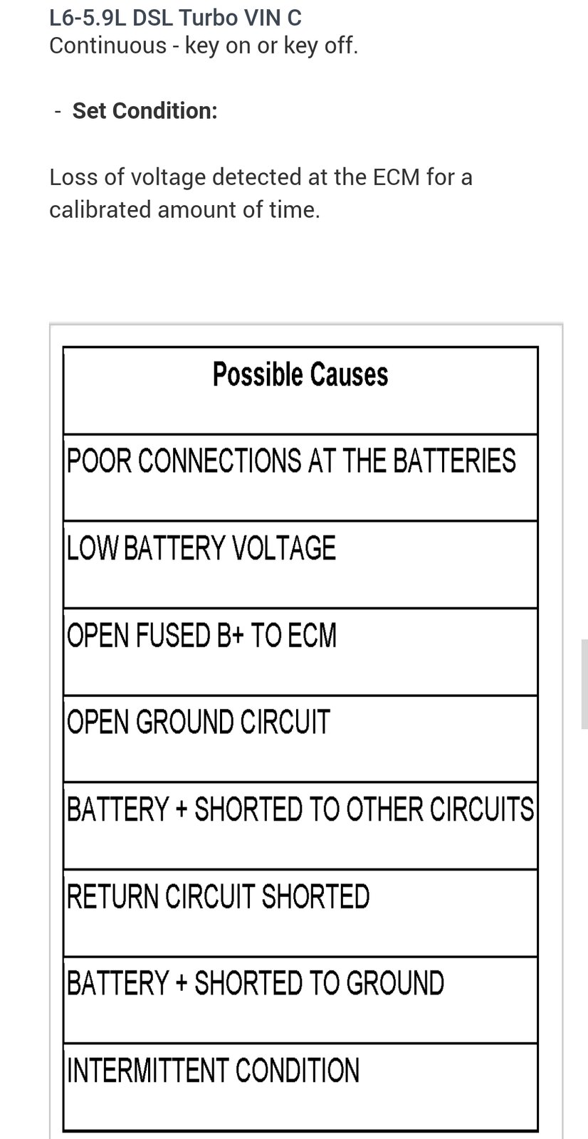

Good suggestions to check the wiring and connections.
The 6.7 documents had some better detail then the 5.9 and it could work differently for sure between them so don't substitute based on any of the attached.
Plus just pushing paper your way no hands on for this. My personal solution is usually buy a new truck or take this one apart so far where it may never run again, and you lose track of why it was you started down this road.......
Becareful extra careful working with ECM and in general computer harnesses and any sub par meters and devices to verify said wiring.
There were some cool intermittent procedures that cover the basics not specific to this exact code just sharing because they might help.
Repairs that fixed this were listed as the normal, batteries, battery cables, wiring issues... there were 4 or 5 verified repairs with those as answers.

5.9L DIESEL
P2509-POWERDOWN DATA LOST ERROR
For complete wiring diagrams refer to Diagrams/Electrical.
- When Monitored:
Continuous - key on or key off.
- Set Condition:
Loss of voltage detected at the ECM for a calibrated amount of time.
