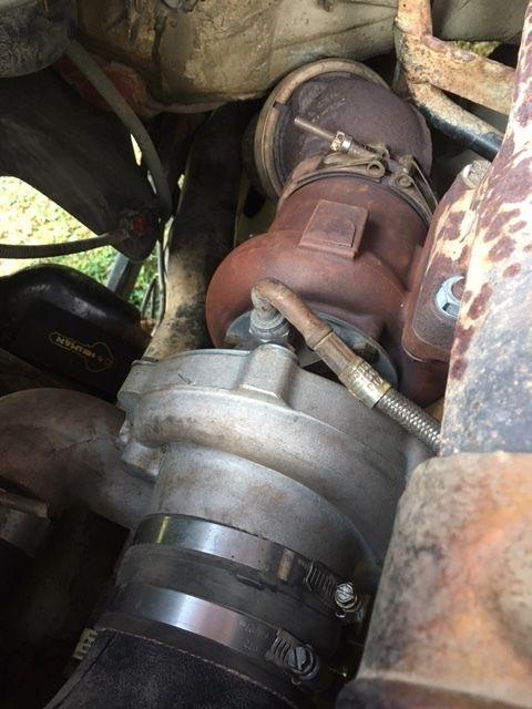

Please identify this turbo, just purchased used 2004, Dodge Ram 2500

Bought this truck for inlaws to haul bigfoot , 9 foot camper. I have been trouble shooting turbo low boost, 299 code, as well eliminating excessive noise from turbo. The exhaust to turbo was extremely loose... removed, cleaned, replaced gasket, torqed to specs and better but still loud under load/climing as well at just idle. I will set up a pressure tester thinking there are other places it is leaking as well.... also looking at taking off K and N filter and returning it to stock air intake.
Tips appreciated.....
very hard to tell, looks stock to me... make sure to test for boost leaks. most of the time that is where it issue's are found.

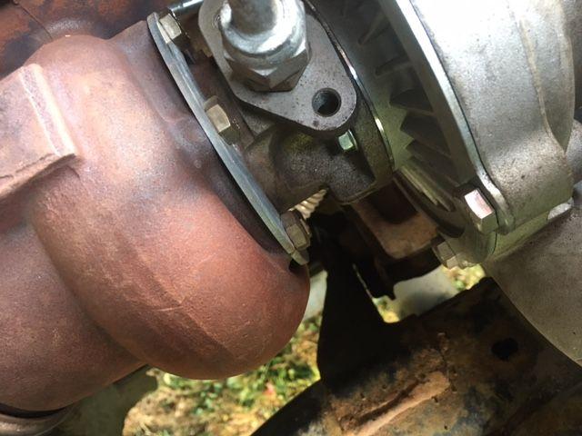

It does not look like a stock HE341 to me. The center section, turbine housing mounting, and compressor housing mounting are not HE341.
Yes after closer inspection I d say its a 200 dollar copy.... looking at a holset rebuild't in america from Yiyitos turbo site.... thats all they do is rebuild turbos , says its genuine holset with the solenoid included 599.00 shipped .... also looking at a local wrecking yard with stock air box.... 75.00 I am sure thats why I was getting irregular low boost codes ....Plus sounds like a jet engine..... we are going for the more quiet, stock rebuild :)

The solenoid is only needed for 04.5.
Did you get a chance to look at the valve cover for the hp rating?
I assumed ours is a 04.5 since it has a solenoid and I can't find any sticker on the valve cover my vin number is vin 3D7KU28C74G213350 and putting that into the cummins site pumps out this
engine serial ESN number ...... 57163733 thanks again ! any tips on parts sources appreciated, seems like a stock rebuilt with solenoid for 600 shipped is a great deal .... from our local wreaking yard they are 400 to 600 ....
Yes it's a 04.5.
