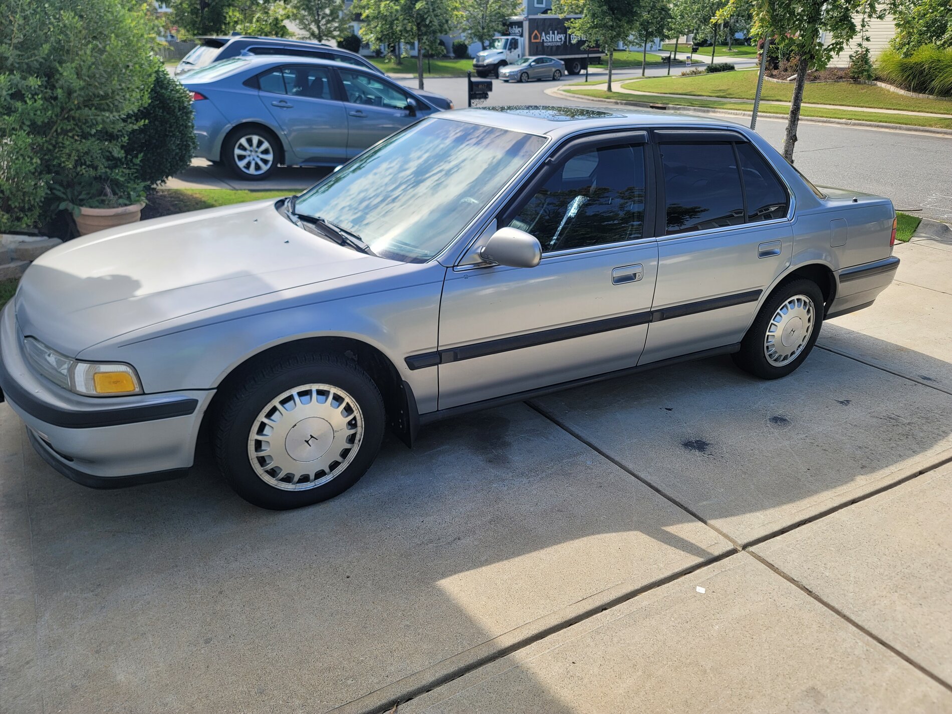

Just scooped up a 1 owner, meticulously maintained, 91' 120K mi Accord for a new daily to give me some time to work on (and potentially turn up the power) my 03 in my signature.
I haven't had the pleasure of working with Accords of this vintage, but I am very familiar with the K24A series engines. As a fun fact about me; my mother had a 90' Accord in green where I spent the first part of my life strapped into a car seat of. It was her very first car that she had purchased on her own. She was misty eyed driving it back home from the seller reminiscing about her first car.
I'll drop pics of the car after this post but I was wondering if there were any good forums comparable to TDR for CB7 Accords?
I have paper back factory service manuals coming in next week from Ebay.
I have an engine stumble issue, that is more present at idle but up to 3500rpm. A little bit of searching has revealed that the idle circuits are pretty sensitive on these accords. I've already tried tightening down the IAC valve plunger. I don't have any check engine light codes, I've already probed the 2 pin OBD1 in the passenger foot well to no avail.
ABS light is on(no codes able to be pulled), and I need brakes. Not and issue except that this cars abs system(4 wheel) has a separate reservoir, Both need to be flushed the main and the abs. I don't want to touch anything yet until I know how it works and the proper procedure for it. I also need pads and probably rotors. Issue being the rotors on the front are "hub captive" in which you have to remove the hub from the wheel bearing with a press like tool to change the rotors out. Not a fan of that design and apparently you can modify them to-not be hub captive with a different wheel bearing/hub assembly off another Honda of the era(looking for forums with guides on it). In the essence of it being a daily driver I want things to be quick and simple to get done given its a 31 year old car.
Any help or advise welcomed from Honda enthusiasts.
Here are some pics, I have not washed it yet.

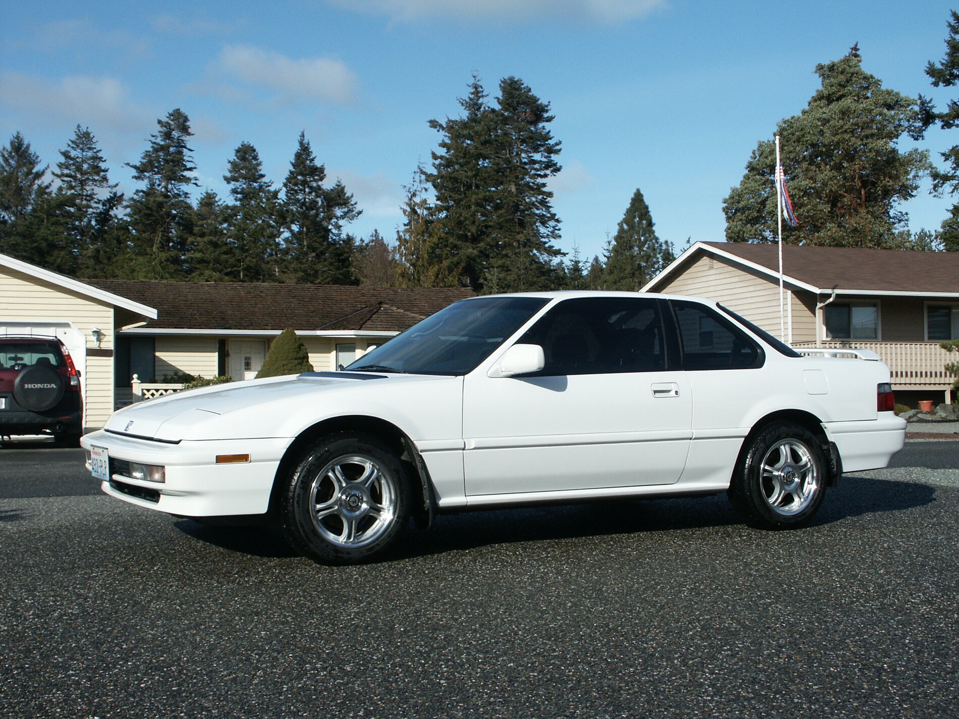

Here a really good looking 4 lug America Racing wheel that I had on a 1991 Prelude.
That is a gorgeous car. Those wheels don't look out of place at all. My father had a 97' in Red for a brief time before my parents found out my twin sisters were on the way 2 1/2 years after me. A 2000 Jeep Grand Cherokee took its place and its still running to this day.
I bought it in 2008 and had it to play with for a few years. We drove from North of Seattle 70 miles to Eugene, Or to look at one, and found this one in Tacoma the next day on the way home. It had been an one family car and not molested, bone stock. Bought it right there on the spot and drove it home with DW following.
There was a saying for that vintage Prelude's, "Real men can die without airbags!" Honda replaced both of the front seat seatbelts because the drivers side retractor was having issues. Now that is customer service!!! Car was 17 or 18 years old at the time.
Picked up the 15" wheels and tires from a guy trading in a vehicle and they did not fit his new SUV.
The 91's came in two setups, all wheel steering or 4 wheel anti-loc brakes. Mine was the anti-loc brake model. It was fun to drive. We had a new 1984 Prelude until wife went into real estate sale and we bought the 1987 four door Accord.
